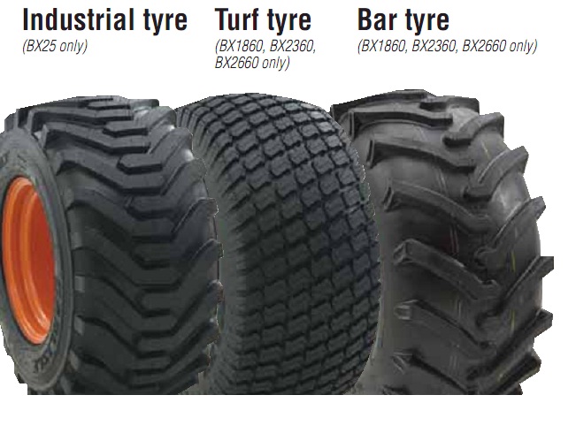

I should have posted that this machine if purchased would spend 80-90% of its life as a mower.
Ive had industrials fill with clay.. no fun for sure:thumbsup: Not much better than turfs.
Current machine (x540) has HDAP's.. again not much better.

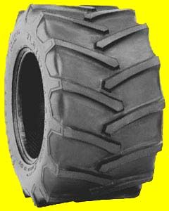

The "Bar" tires arent really like traditional ags (R1). Theyre pretty wide and the bars are shallow. as compared to narrow ags with deep bars. I guess technically they will be R1's. The tires im thinking of are a bit different than the pic. The bars are straight, with no curve
Ill try and post a pic if i can find one. Im hoping theyre a better compromise than industrials. without being too agressive
The tires in question are more like the second picture (single tire)

I would suggest you ask about "bar turfs" before you commit. Mine has R-4's, and as mentioned they are a compromise. Still, they do everything better than the alternatives for me (probably), but I saw a pic of bar turfs...a tire I didn't know existed and is apparently available on Kubota's and I'm pretty sure that would be a superior choice.

I have the Bar tires on my BX1850 and they have not damaged my lawn at all. I find the turf tires will spin easier and tear up the lawn quicker than the bar tires will. Tires are not filled nor do I have any extra weight on the tractor.
If the lawn / ground is real wet you may leave some lug marks.

So far, it looks like Bars are winning. Assuming that they have the proper weight rating. They should be fine as theyre factory? Plus Massey offers the same tires as well.
What about thickness? Are these Sub CUT R1's thicker than industrials or turfs?

As regards "thickness & toughness" of R1s vs R4s, the R4s really win out.
R4s are the "Construction site tire" for Bob Cats and Back Hoes.
R1s are the "Plowed and tilled field tire" for farming.
R4s can also take a LOT more fluid ballast due to their larger width, something like 55 gallons for the 17.5Lx24 R4s vs about 35 for the standard R1s on my smallest tractor.
40 more gallons total.. something like 440 lbs of total RimGuard ballast.
In SOME conditions the lower ground pressure due to additional width is GOOD for traction, you tend to "float over" mud and muck instead of "digging into" it.
The R1 will dig you out, but it is most likely the cause of the low ruts that have worn there anyway (-:
