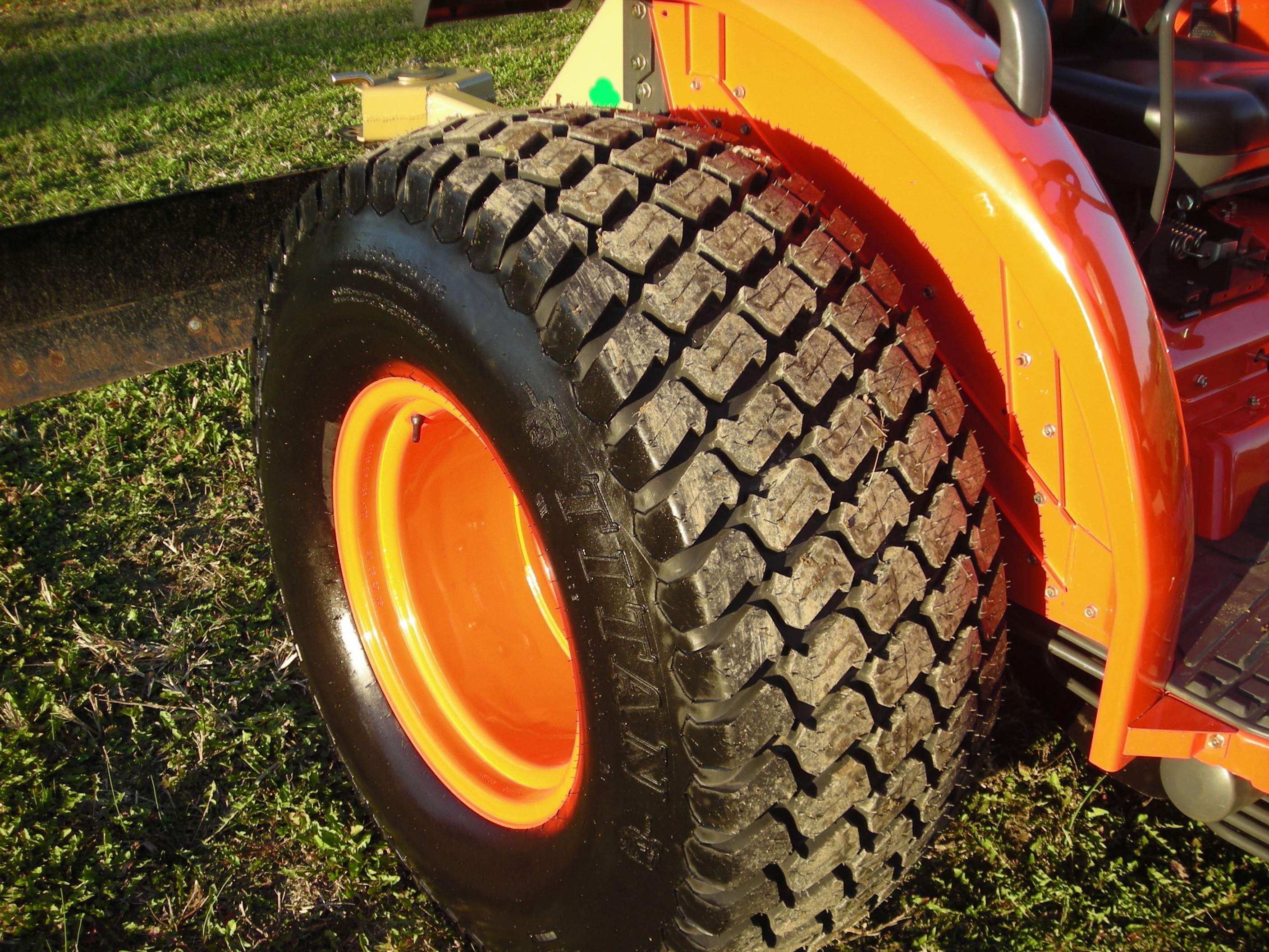

I bought my T1510 with ag tires. They chewed up everything. go figure?! SO, I traded them for R-4 tires. I loved them until spring, they were horrible in the field and the lawn.... forget it. Now I have turfs. I wish I would have bought them in the first place. I live on a hill....... They close 1/2 my road in the winter hill...... and I have NO traction problems. Now, I don't pull a two bottom plow, or anything extreme, but for my mower, backblade,etc.... They work fine for me.

A few weeks ago I got a BX2360. Turfs, loaded with RimGuard. On the lawn, they are great and ride smooth. I have done some excavating with the loader and am happy with the traction. The weighted tires do a lot for traction, yet do not harm the grass.
