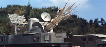

My favorite analog screencap was from your neck of the woods; CHCH-tv3 Ch67 Muskoka in Nov 2004.Loved the analog days.
