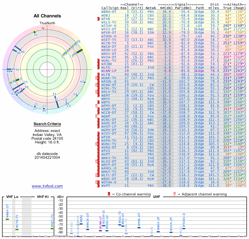

This site also lets you see what signals you might get. I liked it a little better than the site newbury (post 2) gave because this site actually lists the expected reception levels. Good reception signals at the back of a TV are at 0dBm to +6dBm. Signals lower than that can be received and an amp will help.
And YES, a steel roof will affect signals if the antenna is located too close. Metal will reflect and direct signals coming in and cause timing and phase issues. In the olden days of analog this was most often the cause of "ghosting" and signals fading in and out. I haven't really done a lot with antennas on digital signals so I can't say if that would happen. The best thing would be to get the antenna above the roof by 15-20 ft to help eliminate any issues.
TV Fool
Here is the report given for my house as an example.
/ tv antenna #10

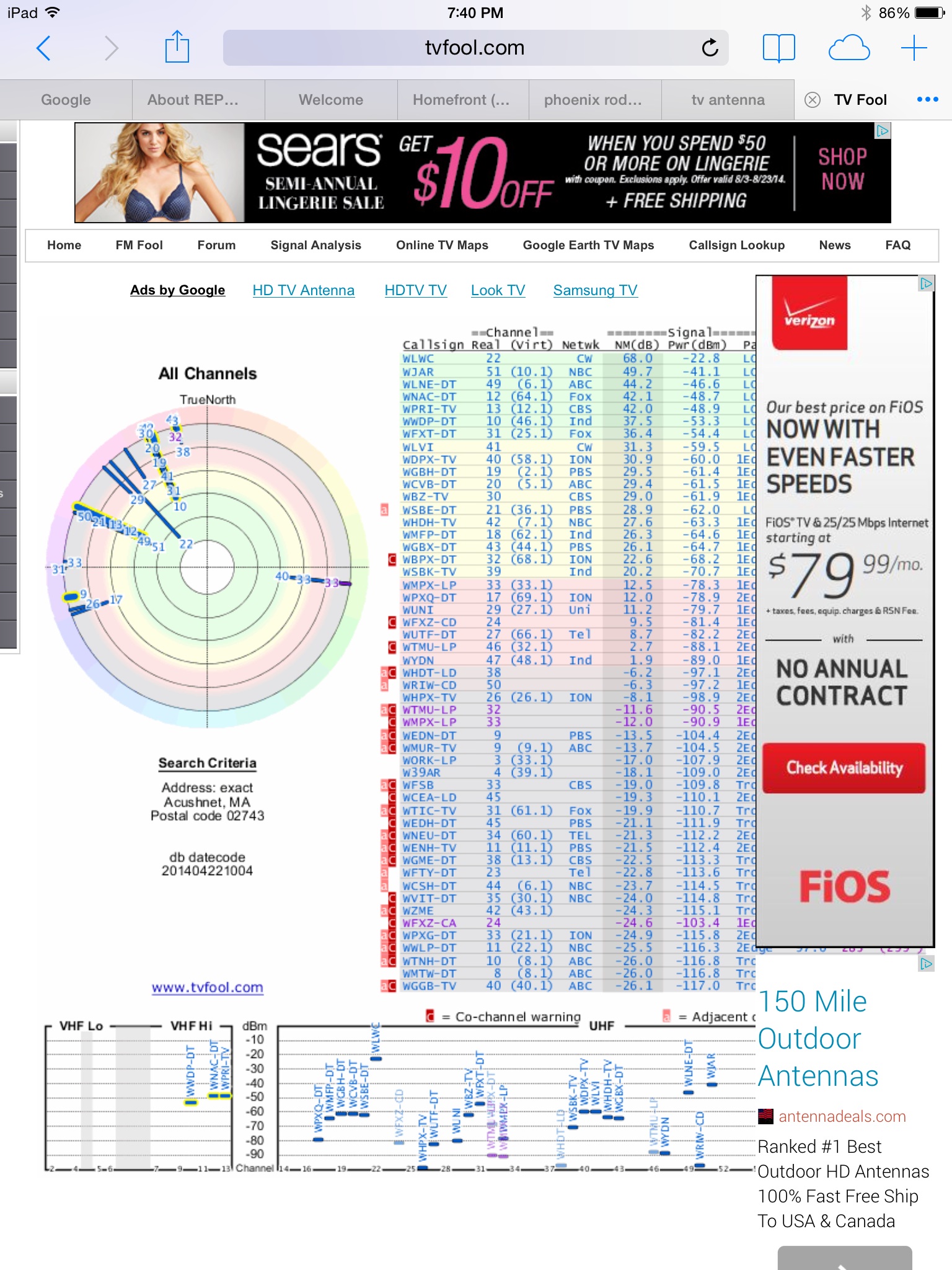

Thought I'd post mine
Good link to TV Fool, now what to do with the info. I have an indoor antenna, get 5 or so channels currently.
/ tv antenna #16
You have over 20dbm better signals than at my location.. that -22dbm one might light an LED if you put an antenna on it:D Just kidding, but that is a pretty strong signal. That is almost 1/100 of a milliwatt into a reference antenna.
