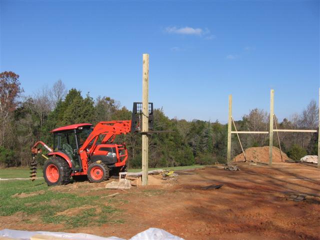

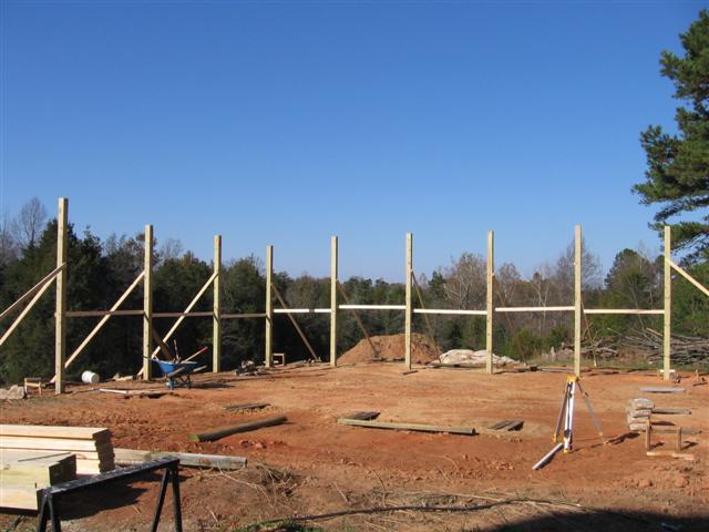

I am making some progress with putting in my posts. I figure I will get most of them done by tomorrow. The tractor is a big help holding the posts while I get them straight and back filled with concrete and dirt. Here are pictures from yesterday and today.

I will be getting the rest of the posts in the ground today and was going to start putting the girts on. It will be at least another week or two before I can get the roof trusses in and put up. How much bracing of the posts do I have to keep to keep the posts from bending as they dry out before the roof trusses go up? Some of the 2x4's that I got for girts are now being used as bracing. I was trying figure out how many of the 2x that I am using as braces I can use or whether I should leave them all until the roof trusses are up tying everything together. Thanks for your help. Rick

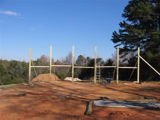

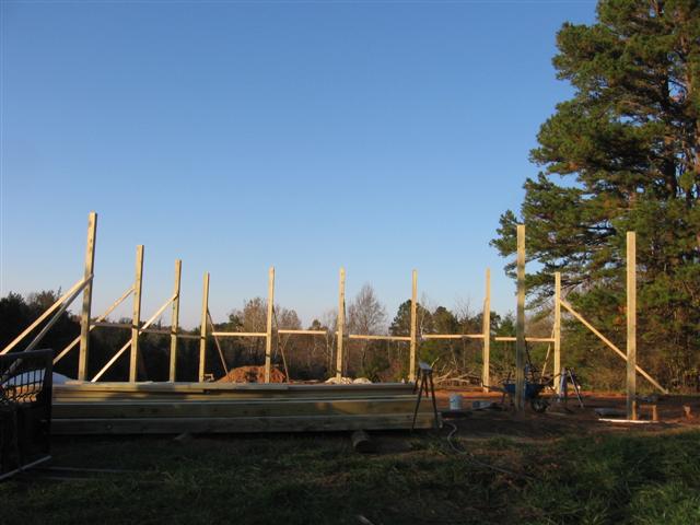

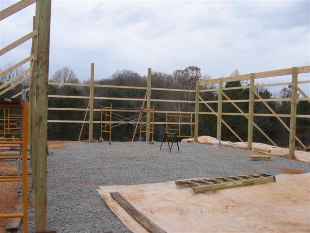

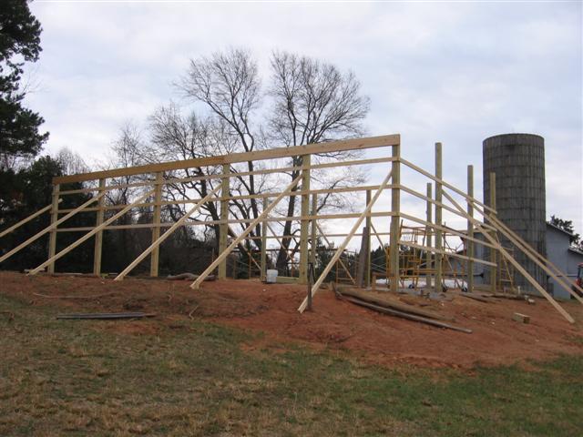

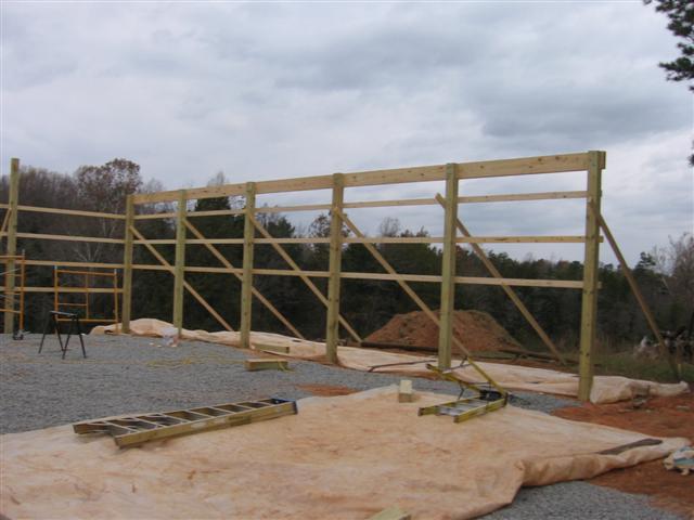

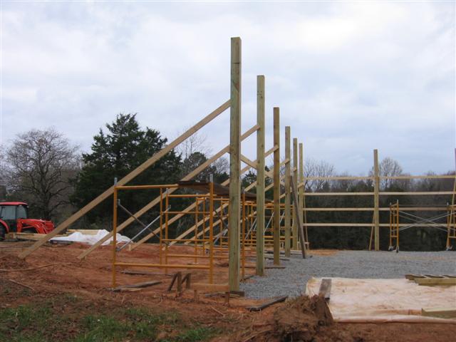

Making more progress on the barn. I got the 2 x 10's attached to the posts on one side of the barn. Most of the girts are attached to that side and the end of the barn. The weather men are calling for rain tonight into tomorrow morning so I covered up some areas to reduce the making of mud. I also put some gravel down just to keep the clay from sticking to my feet when it gets wet. I will put more down after I get the roof trusses up. My wife has given me the ok to put in a concrete floor instead of just gravel. yeah.
Here are some picture of what I have gotten done this week. Rick
IMG_1593 (Small).JPG IMG_1596 (Small).JPG IMG_1597 (Small).JPG IMG_1598 (Small).JPG IMG_1599 (Small).JPG
   / Two Pole Barns, one new and one to renovate #15
Good looking job so far. Never too much bracing until trusses are tied in. You will have to be up on top and moving around quite a bit to get it completed. If one gets in the way just move it or remove it. Much more comfortable working on a good steady frame and safer too! Keep up the nice work you will be proud in the end.

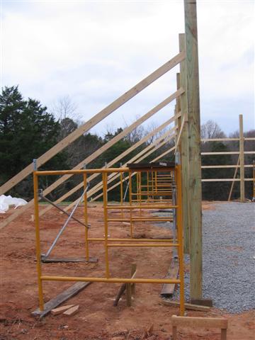

I need some help. The trusses were delivered the other day and I am beginning to think ahead to the job of putting them up. One thing I have a question about is how to temporarily brace them until I get the purlins on and the permanent bracing on. The trusses will be going on 4 foot centers. Should I cut some 4 foot 2x4's to connect a truss to the previous truss and then after I get a few up start putting some 16 foot purlins on along with other permanent bracing. Any help that anyone can give will be greatly appreciated. Rick

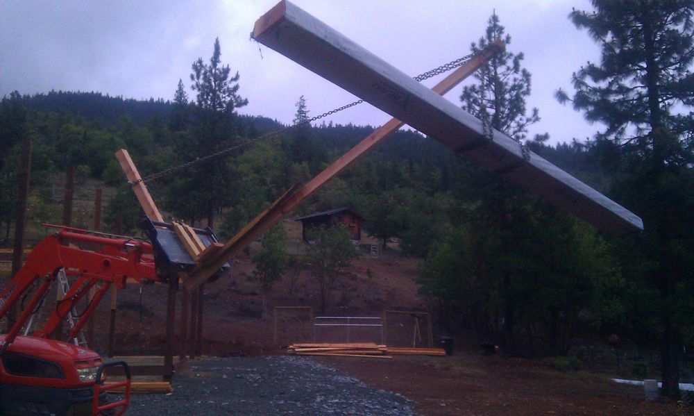

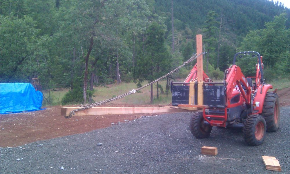

I did something similar. Sort of quick-n-dirty Rube Goldberg crane setup but it worked for hoisting beams 16' high when building my barn (separate thread here on TBN).
A 4x4 will snap without a chain/cable to hold it diagonally. Here are a few pics.
