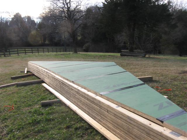

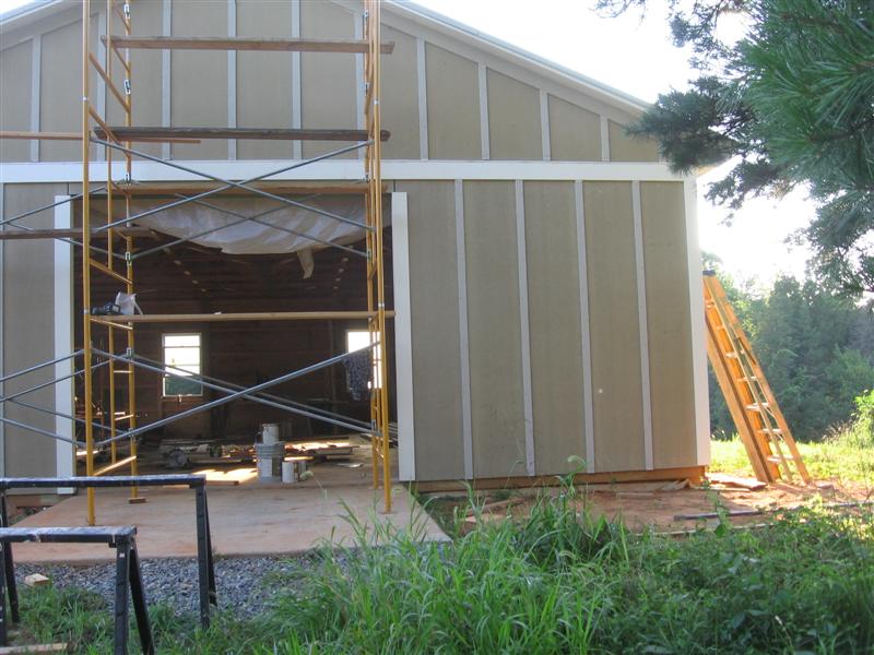

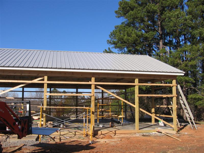

Wow time flies, the holidays and sending my wife off on her annual trip to Antarctica have made the last couple of weeks fly by. I finally got back to working on the barn today. I decided to put the sheathing on the gable truss before I put it up. So I spent a couple of hours cutting and nailing the sheathing on. Got one of the two done. The weather forecast is for mild weather for the next week so I hope to make some progress. I ordered the metal roofing yesterday, About $2300 for all the roofing, trim, screws delivery and taxes. Should be here in a week or so.

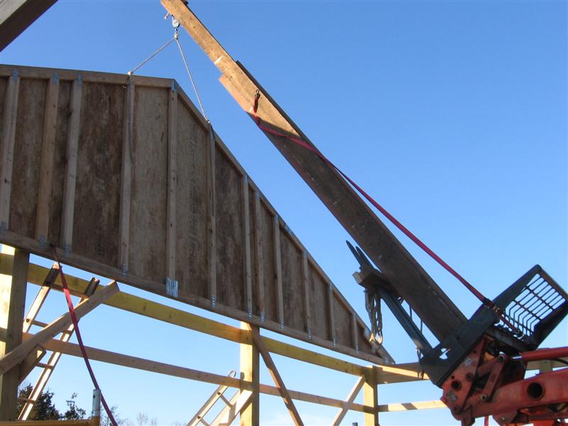

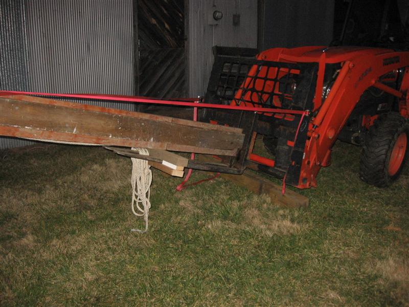

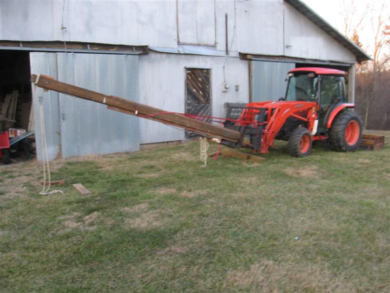

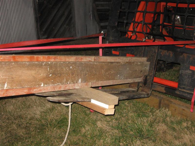

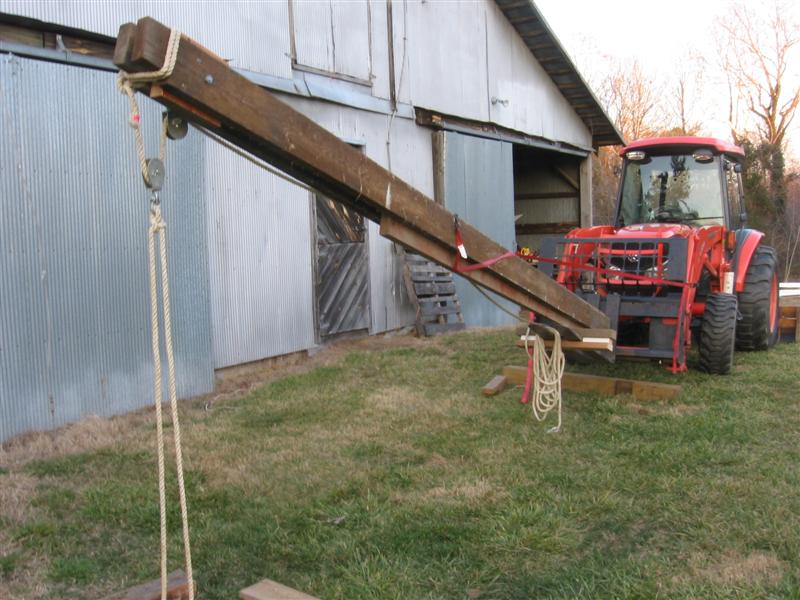

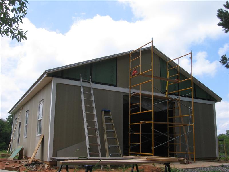

Today I made a boom for my front end loader so that I can lift my trusses into place. I had a piece of LVL beam that was left over from our house renovation last year. I also had a couple of rough cut 2x6 floor joists. I put them all together with timberlock screws to make a 15 foot boom. I have 10' walls so I need some height to be able to lift the trusses into place. I screwed a board under the forks to keep the whole thing from coming back on me if I have it too high. I also screwed a couple of boards on the back side of the forks to keep the boom from sliding fore and aft. A couple of tie down straps steady the whole thing from moving left and right. Hopefully it will work well for me. I did sit on the end of the boom and it held me up without anything breaking.
Tomorrow will be the real test. Rick

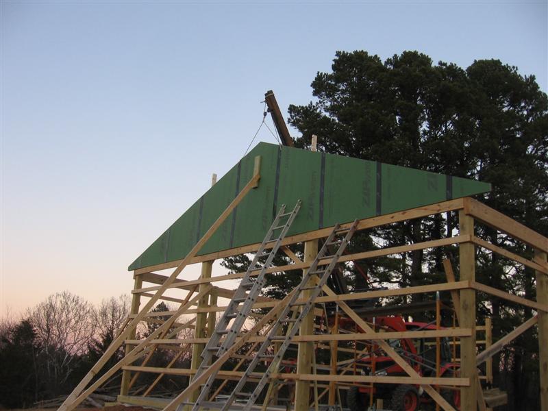

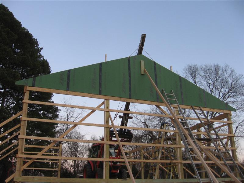

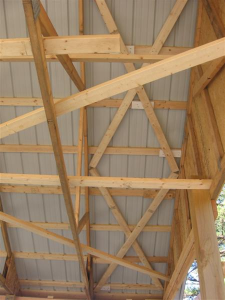

The boom on the front of the tractor works. I had to turn around after I picked the gable truss up and it felt like I was a little light on my rear wheels even though I had my box blade on. I set it back down and went and put my bush hog on. With the extra weight I did not have any problem. The gable truss is completely sheathed so it was heavy. It is a little difficult to watch from the cab when you lift it high enough to clear the top of the walls. I got it into place and now have it braced. It is still getting dark too early. Rick
