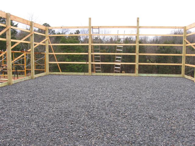

I have been making slow steady progress. Yesterday I was putting in my 4 inches + of gravel. I worked by the tractor lights in the dark to finish leveling it out. Last night after I finished I realized that I should put in a conduit to bring the electric into the building. I am going to bring the electric from the other barn that is about 150 feet away. Does anyone know how big of a conduit I should put in? I only want to put in enough to get it through the concrete floor for now. Thanks

Would need to know amperage and volts of the service to the new barn to figure conduit sizing. More then likely a 2" would work, but if you put a 3" 90 stubbed to the top of the slab you can always reduce fron there. Larger bends make it easier to pull wire.
Are you adding another treated board at the bottom? Typically the top of the concrete slab is at the joint between the top and bottom base boards.

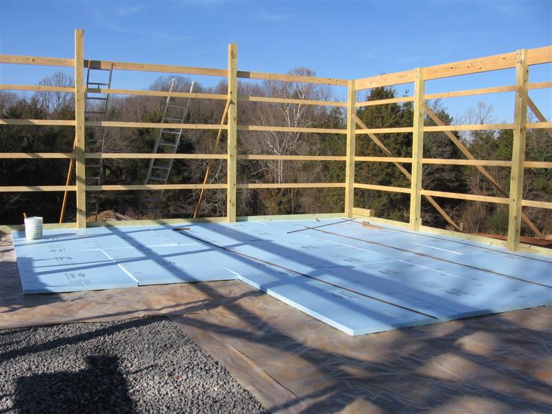

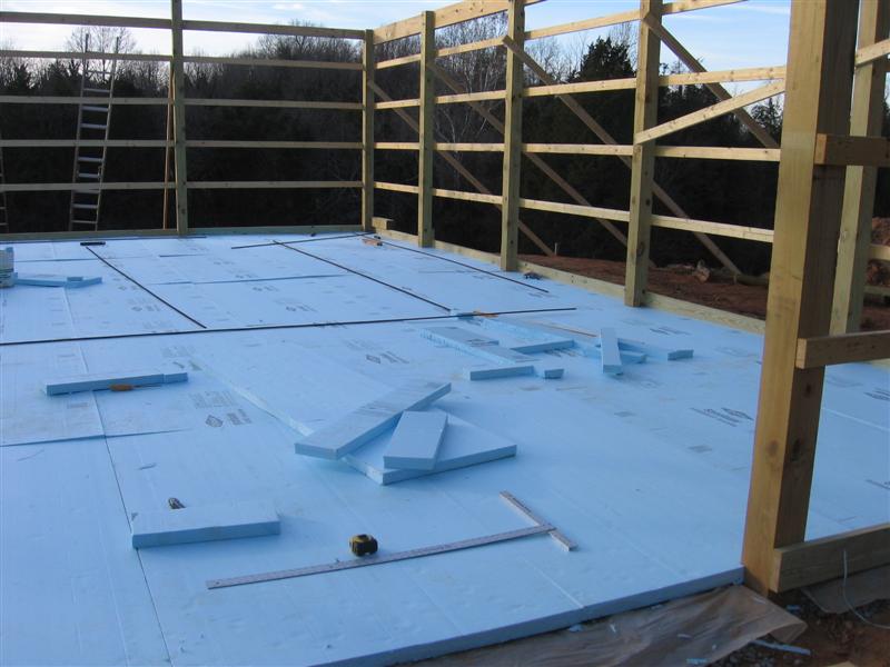

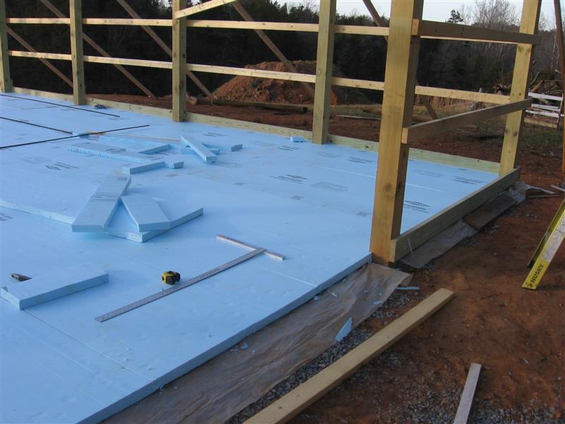

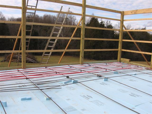

Today I was putting foam board in. It was a lot of work cutting in around all of the posts. Tomorrow I will start putting in the pex tubing and the rebar. I still need to make a form for the concrete apron outside of the garage door. I am hoping that I can get it all ready for the concrete by late next week. Trying to get the floor done before the real cold gets here.

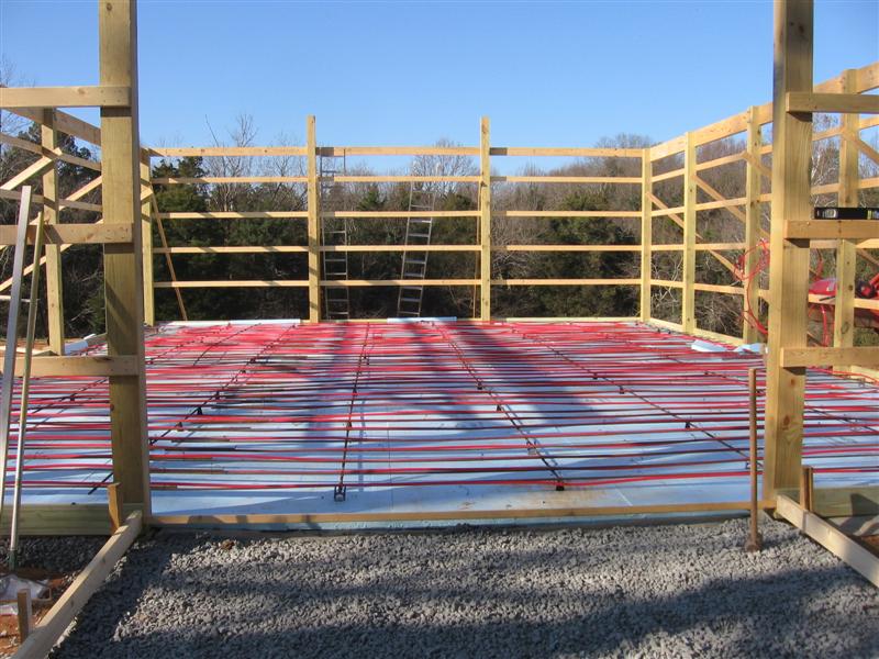

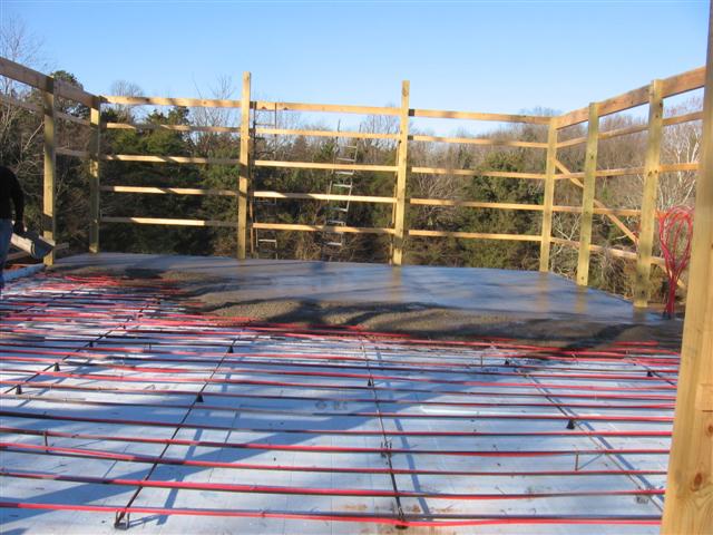

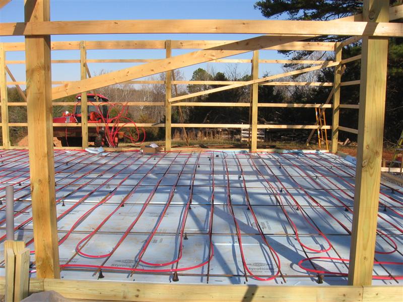

Busy couple of days. I have been putting rebar and pex tubing in to get ready to have the concrete floor poured. Tomorrow is the big day the finishers will be here first thing in the morning and the concrete will begin arriving at 8:00. The weather is supposed to be perfect. It is supposed to be cold in the morning and warming up to the upper 50's. I will try to get more pictures tomorrow.

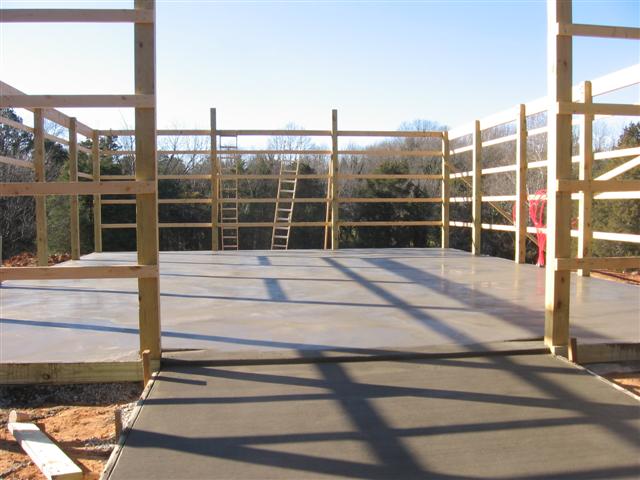

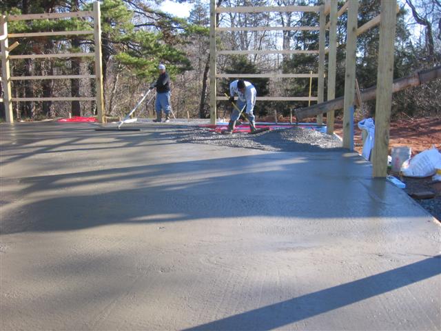

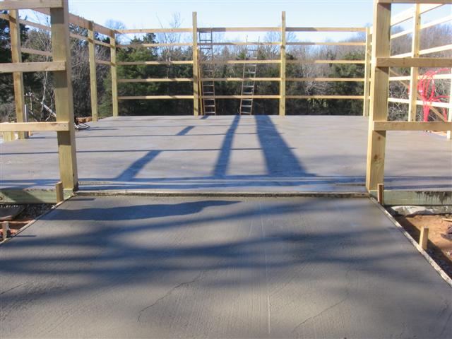

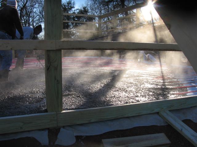

Well I got a concrete floor today. The day started out really cold for down here about 20 but it warmed up to the mid 50,s The first concrete off the truck was steaming. Things moved along well. A couple of guys that know what they are doing are amazing. They poured the 30x 40 slab, and 8x10 apron and a 4x4 stoop. I paid $1150 for them to finish all of that concrete. The concrete was $2400 for 19.5 yds of 4000 psi concrete including all surcharges and taxes.
