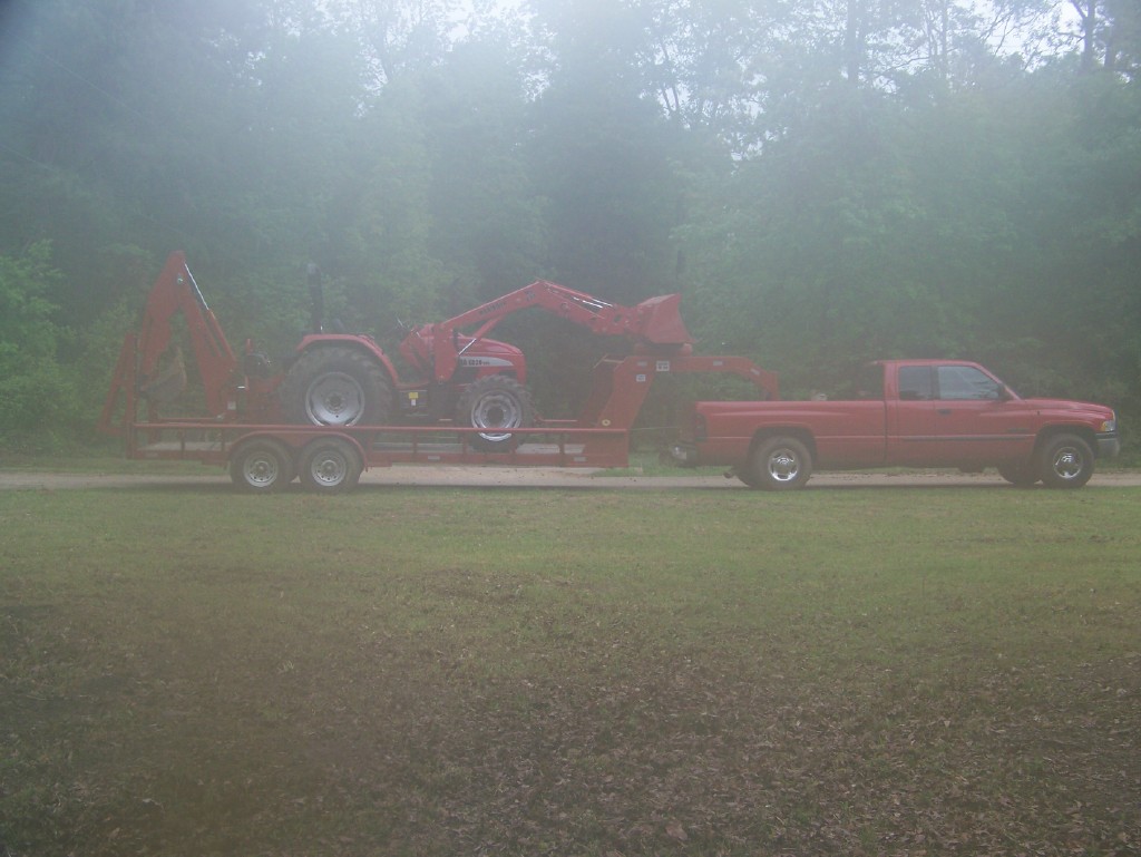

I am still waiting on the thumb. I think I might be able to get it Monday, as it is in at a freight dock in Houston. I have been digging up some mighty big stumps and dragging them up into the boom and carrying them. It is a little wet here to do any dirt work except dig up stumps. I have tried to move some dirt, but the springs keep draining where I need to remove the dirt. Anyway, I will attach a photo of my 6520 with my trailer and truck. The 6520 is really a heavy load.
hugs, Brandi

Wow, some people really like red.:D That is one nice looking rig. I hope that it serves you as well as mine has for me.
   / Two week wait #34
Yeap...red is without question your color. Very nice! Enjoy!
   / Two week wait #35
NICE...everything. thanks for the picture.
Joe
   / Two week wait
#36
Thanks guys. For a fogged over camera lens, the photo came out good. Red is one of my favorite colors. Right behind black and white. But nobody makes a black and white tractor and I am not into repainting something brand new.;)
hugs, Brandi
   / Two week wait #37
bindian said:
Thanks guys. For a fogged over camera lens, the photo came out good. Red is one of my favorite colors. Right behind black and white. But nobody makes a black and white tractor and I am not into repainting something brand new. ;) hugs, Brandi
Great photo!!! Makes for perfect Windows "wallpaper" because of the fog effect... I can still clearly see my desktop icons! :) Very nice indeed!!!
I love the red on red on red... and that magnificent 511... and now I'm jealous that I don't have a trailer nearly so nice. :eek: Although I'll bet you could get three of mine for what that one cost! :D The whole set-up is nothing short of "First Class"! :cool:
Dougster
   / Two week wait #38
hugs, Brandi
Tell that to MntViewRanch... I think he missed that memo....:D ;)
and you knew that was coming Brian... lol
BTW... good time to post the pic... I was going to make my own "two week wait" comment about pics.... :) Congrats Brandi.

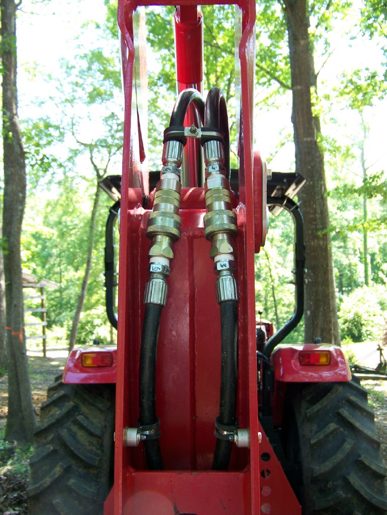

Well, the hydraulic post hole digger came with a swivel knuckle,:) but the attach hole for the 1 & 3/8 inch diameter pin on the dipper stick was too small. :( I had the knuckle modified for $115,:eek: which I think was high, but Danuser wanted $199 for the swivel knuckle to fit my dipper stick. I just finished clamping the lines back after installing quick disconnets today. I didn't think to have 5-6 inches removed from the lines, :rolleyes: as that is what the new fittings and quick disconnects added. It took awhile to figure the right place for the line flexing at the dipperstick pivot. :confused: I finally drilled holes and installed aircraft line clamps and spacers and clamped both lines together above the disconnects. Anyway, I didn't have any leaks :cool: and CRC spray on brake cleaner (used as a degreaser & cleaner) eats paint.:eek: I usually use LPS electical contact cleaner, but Graingers was out. :mad: Attached is a photo of the installation. I will have to add a rubber chafe strip under the disconnects while in transport position, as they rub the dipperstick. Right now they are wrapped in leather.
Oh yeah, my aluminum diamond plate canopy fianlly came in. :cool: Attached is a photo of the canopy.
hugs, Brandi
