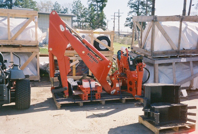

I am still waiting on the thumb. I think I might be able to get it Monday, as it is in at a freight dock in Houston. I have been digging up some mighty big stumps and dragging them up into the boom and carrying them. It is a little wet here to do any dirt work except dig up stumps. I have tried to move some dirt, but the springs keep draining where I need to remove the dirt. Anyway, I will attach a photo of my 6520 with my trailer and truck. The 6520 is really a heavy load.
hugs, Brandi

Wow, some people really like red.:D That is one nice looking rig. I hope that it serves you as well as mine has for me.
/ Two week wait #34
Yeap...red is without question your color. Very nice! Enjoy!

Thanks guys. For a fogged over camera lens, the photo came out good. Red is one of my favorite colors. Right behind black and white. But nobody makes a black and white tractor and I am not into repainting something brand new.;)
hugs, Brandi

Great photo!!! Makes for perfect Windows "wallpaper" because of the fog effect... I can still clearly see my desktop icons! :) Very nice indeed!!!
I love the red on red on red... and that magnificent 511... and now I'm jealous that I don't have a trailer nearly so nice. :eek: Although I'll bet you could get three of mine for what that one cost! :D The whole set-up is nothing short of "First Class"! :cool:
Dougster
