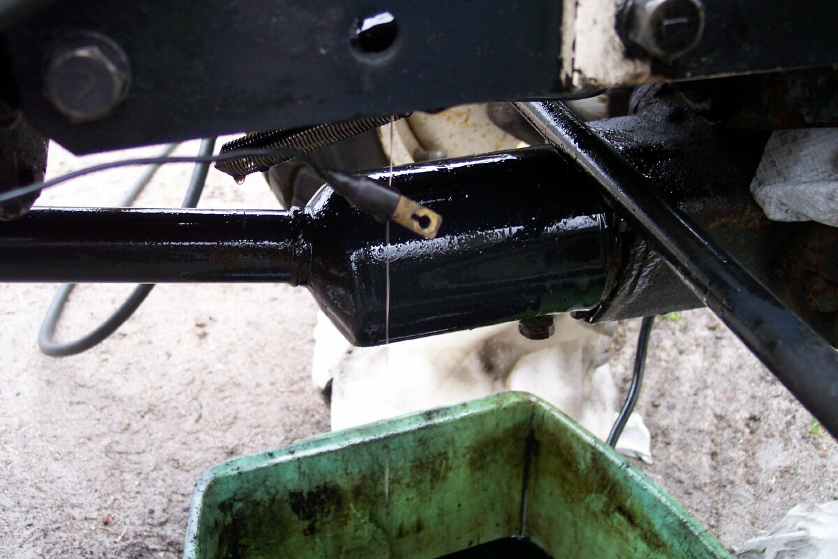

Can I do this without removing the engine from the tractor? Looks like it will be tight to get the oil pan off with the front prop shaft in the way? Just wanted to check that it can be done before I open her up.

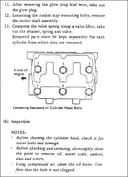

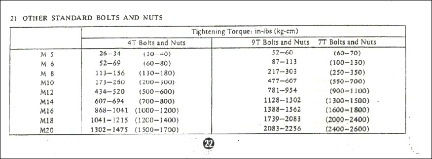

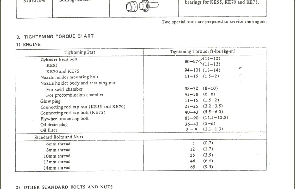

Also - anyone got the torque settings for the head bolts - injector bolts etc?

Hey Dan, you can remove the oil pan without removing the
front drive shaft. Here a few pictures from the repair manual.
I can E-Mail you the manual in pdf format.

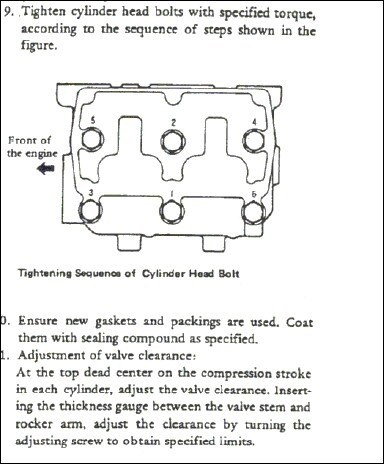

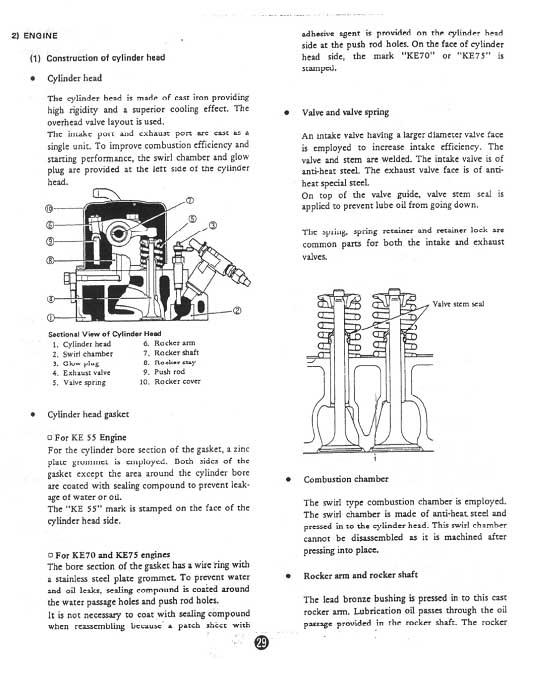

Just another question - did you use a gasket sealant when putting the new head gasket on - I can't quite work out whether the manual is saying to use sealant or not.
/ TX1300F engine questions #10
Usually sealants are not recommended on head gaskets. There are recommendations to retorque the head bolts after a few hours of use though which I would recommend as well since these head gaskets have a tendency to leak around the cooling fluid and oil passages. Applying sealant around these area may prevent the need for a re-torque but a re-torque may prevent a cylinder leak so I'd opt for that (or both).
#11

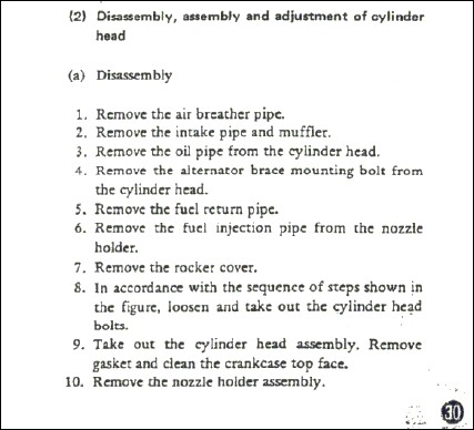

Here's the page in question, if you can make sense of it.
/ TX1300F engine questions #12
I read that part when I did mine and though ok the head gasket
has sealant on it. I bought a new head gasket from the internet.
I found a web site selling the gasket for $59 us and I was just
learning about how parts here in the U.S. were in short supply
and expensive. The $59 head gasket was half of what others
were charging so I bought the cheaper one. When I got the gasket
in the mail I could see were someone traced the out line of the
coolant holes and then cut or punched them out. It did have fire rings
for the cylinder bores so I though thats how there come. Because the manual
says not to use sealant I did not. After several months of use the head gasket
started to weep coolant on the starter side of the engine and oil from
the exhaust side of the engine. I was very disappointed. I was not
going to buy that one again and try sealant. So I found a place in
Oregon USA that sold Mitsubishi parts and I bought a factory
head gasket and installed it. No more leaks. So it took me $199 us
plus shipping to do my head gasket. I should have bought the factory
one in the first place.

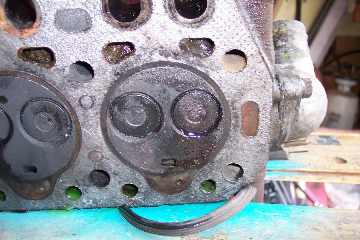

Here are a few pictures of my head before repair.
I put the head on its side and poured kerosene
in the exhaust ports and the intake ports.
You can see in the pictures the exhaust valves
are leaking. Also these heads do not have steel
valve seats. The valves seat right into the
cast iron head. The cast iron is porous but as
the engine is run the soot from the exhaust fills
in the pores. Thats what I was told. After I lapped
all of the valves they sealed fine. I did buy new
valve springs because I though my old ones didn't
have enough seat pressure. The new ones were
much stronger.
much stronger.
Mine look exactly the same as that. Just lapped the exhaust seats and they are pretty good now. I'm glad you mentioned the lack of seat inserts, it took me a while to figure out while I was still seeing pits after lapping them! My springs feel good, will put the old ones back in for now.
