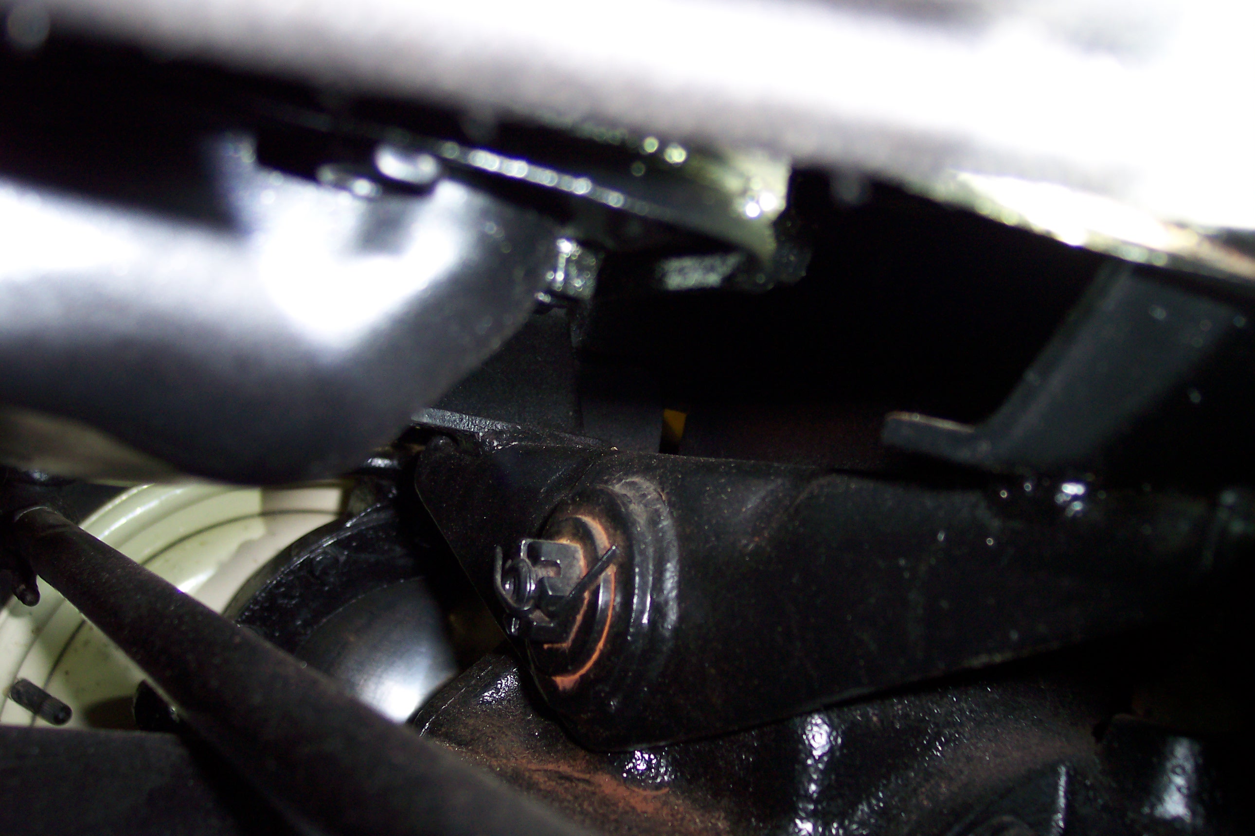

On the negative side, I can't get the &%$$ing sump off! If you look at the picture below you can see that access to the front bolts is blocked by the pivot bracket.
Anyone encountered this problem before? Any trick to this I haven't spotted?
I haven't really got the time to drop the whole front frame off just to get the sump off, so it looks like I'll be skipping the piston rings and just hoping its just the exhaust valves causing my start issues.

It looks a lot more room in the photo than in reality. Although it doesn't look like it in the photo, the cross member overlaps the bolt heads, making it impossible to get either an open spanner or socket on. I'm just off to have another go though. I don't know why it's different to yours, maybe the front game of mine had been shifted a bit too fit the loader, can't see why though!

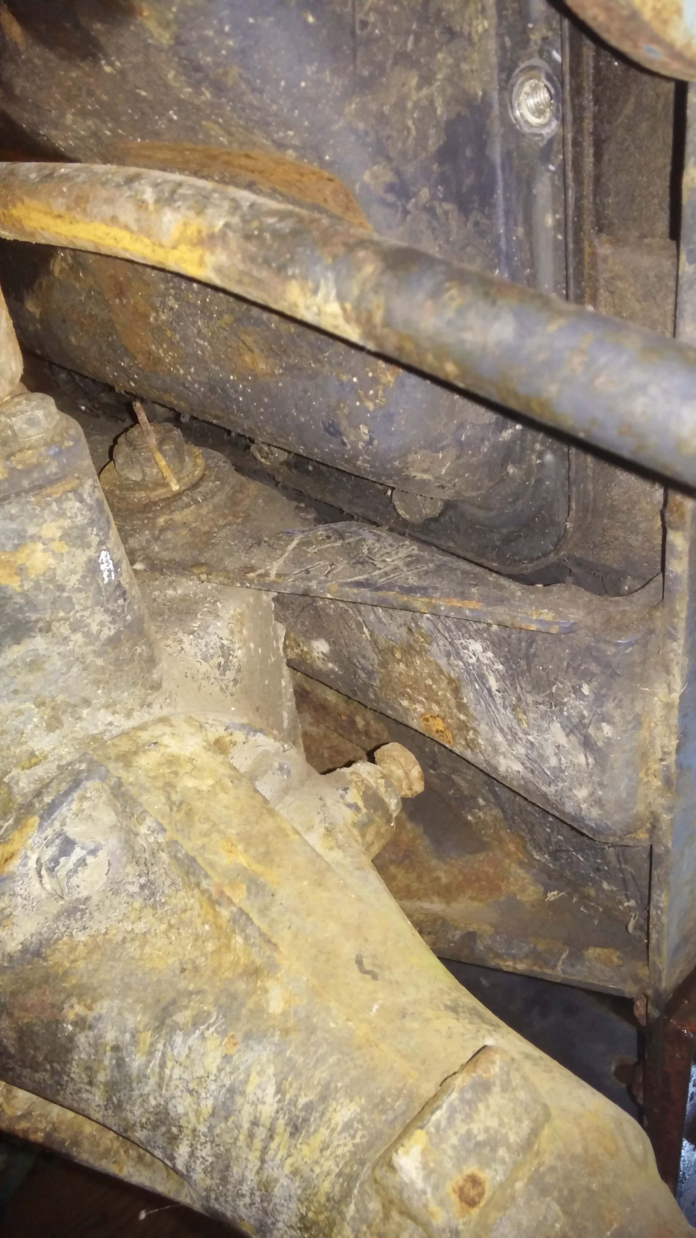

Hey Dan, I just went out to the garage to look at mine
and I must say mine is different than yours.
Here is a picture of mine. Mine has much more
clearance than yours.

Bit of detective work here to see what has been modified from stock. As you can see from the photo by TX1300 is in pretty bad shape cosmetically, but because of the loader its a real workhorse. It really needs some TLC but it's got too much work to do before that.

Something else different on mine is the tie rod - mine looks to have been bent to fit into position. Clearly some mod has been done to the front end at some point - although you can't rule out variations in the model. My hunch is that something has been altered to accommodate the loader, will investigate tomorrow.

Does yours have the KE70 engine. I was just looking at your
picture an your oil pan is right up to the cross member.
Also I noticed that tie rod but one thing at a time.

Well, curiosity got the better of me and I just went down in the dark to check it out under torchlight. It's the KE70 engine, at least that's what stamped on the block. I checked out my TX1500 and that has the same clearances as your tractor.
There isn't an obvious difference in geometry, but I'll get a tape measure on it tomorrow and try and see what has been altered.
