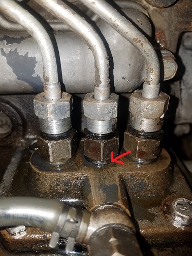

would anyone have a part number for the o rings that go on the lower "nut" where the hard lines attach to the injection pump?
o ring would go around the shoulder of the fitting with the arrow pointing it in the picture...
motor is a Mitsubishi K3B 3cy in a bolens g174 (tx1500f)
thanks guys!

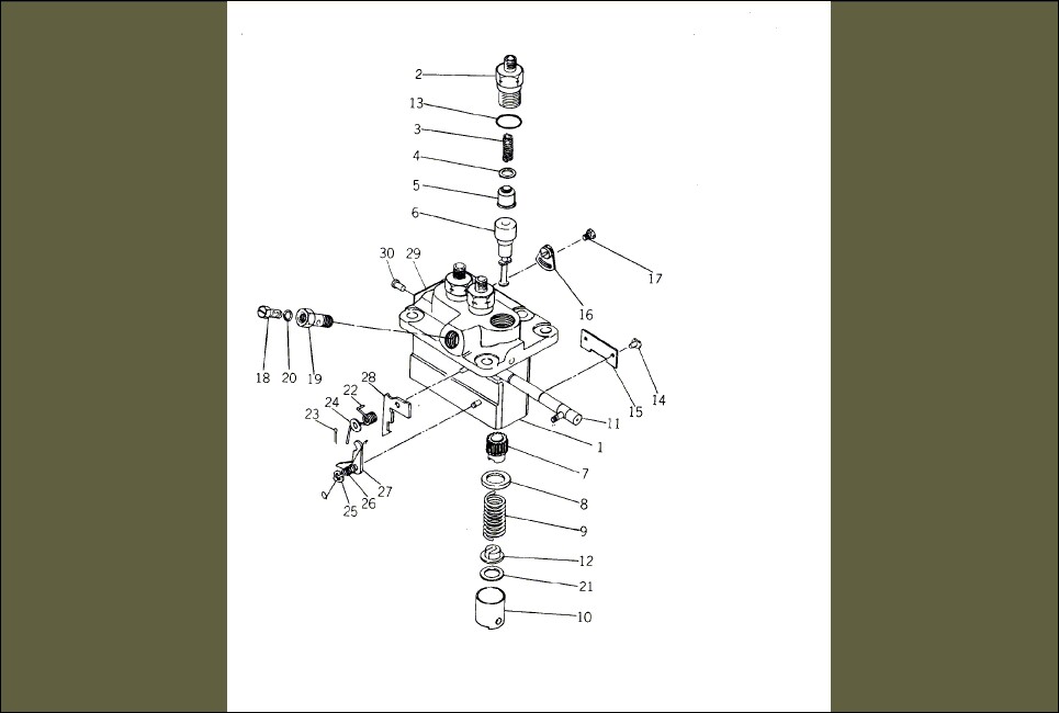

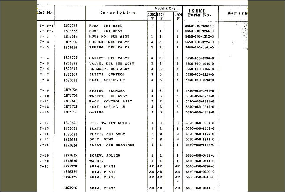

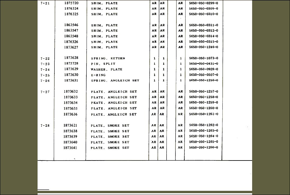

/ tx1500 injection pump o rings #2
Here are a few pages from parts manual
thanks fxrs55! I don't have a parts manual, just a service so theres no part numbers listed... and my manual if for a twin cylinder ke70 and ke75... diddnt know that when I ordered it...
this is what I needed! no the hard part finding them or the right size listed anyway...
thanks again sir!

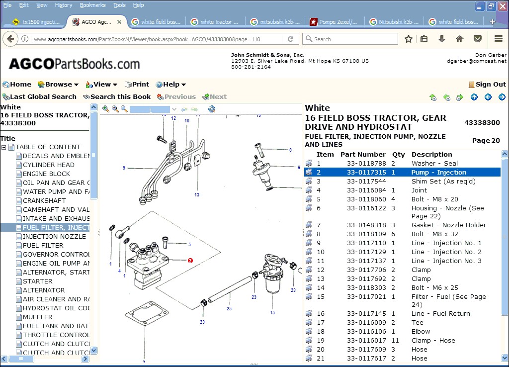

Here is a page from the AGCO Partsbooks.com web site.
The White field boss 16 is almost the same as your tractor.
You can order parts for white tractors at a Massey Ferguson
dealer. Massey dealers get their parts from AGCO. I have
bought parts for my TX1300F from a Massey dealer
here in NJ. A Massey Ferguson 1120 tractor is also
a close match. I have bought my parts with part numbers
from the 1120 or the Field boss 16.
Also check this link
White 16 Field Boss | Tractor & Construction Plant Wiki | FANDOM powered by Wikia
