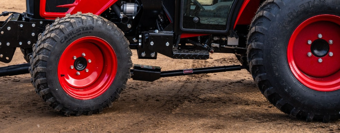

Does that entire mid-mount PTO business come off?
I could see keeping that there for winter/snow blowing where you're staying on the road, but for most uses I'd have of a tractor like that, that's really low ground clearance.

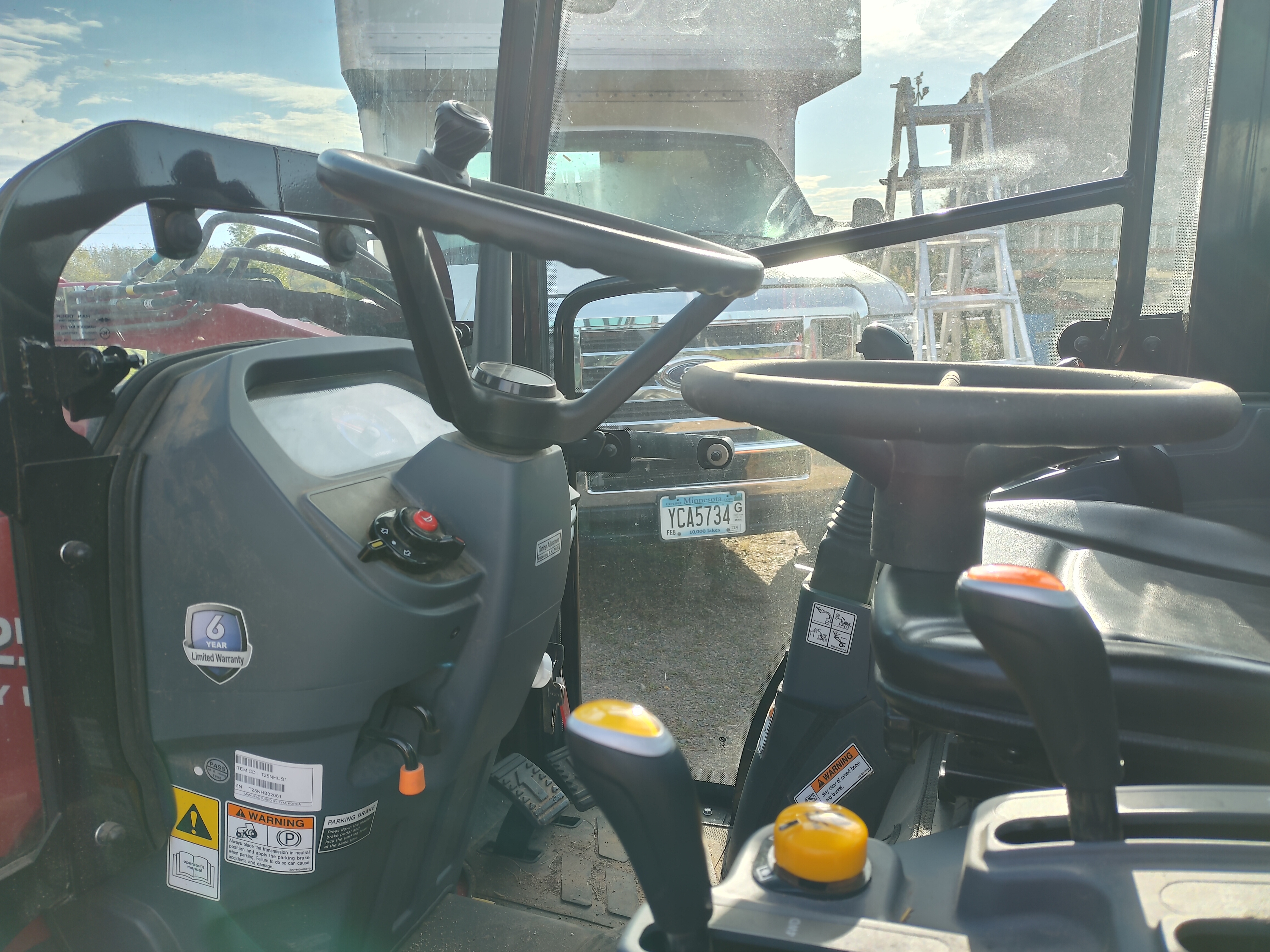

Just wanted to give an awesome tip on a better steering wheel for the tym t25 / rk 25. I have a cab on my t25 and am a larger dude. The stock steering wheel is so low and hit my knees and just doesn't fit right. I put a Ferguson 1720 steering wheel on my t25 and what an upgrade! Its now above my knees and can get in and out of the cab so much better. Its a direct fit no mod needed. Tony needs to get this changed on the new models...

Where did you get this steering wheel?
