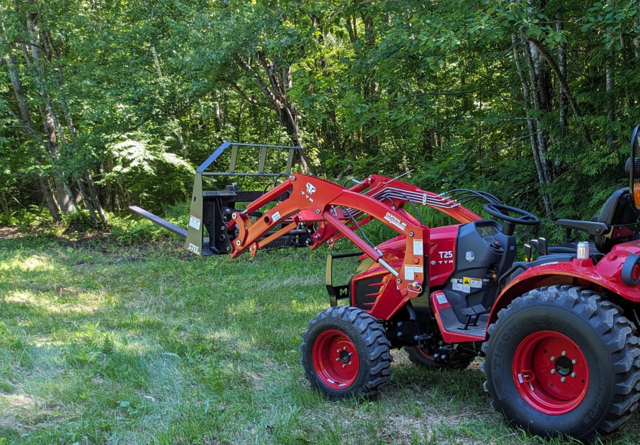

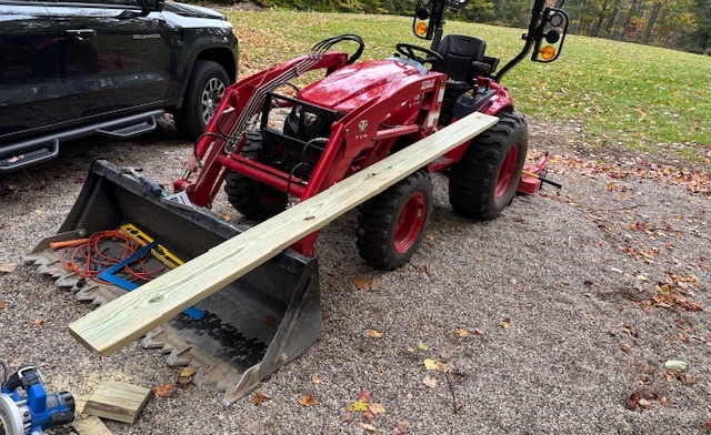

The T25 is my first non lawn tractor and all I can say is I’ve been very happy with it. I’ve done a ton of work with it already having it this past season .
It’s a beast for its size. My issue is becoming where do I store all the attachments :)
