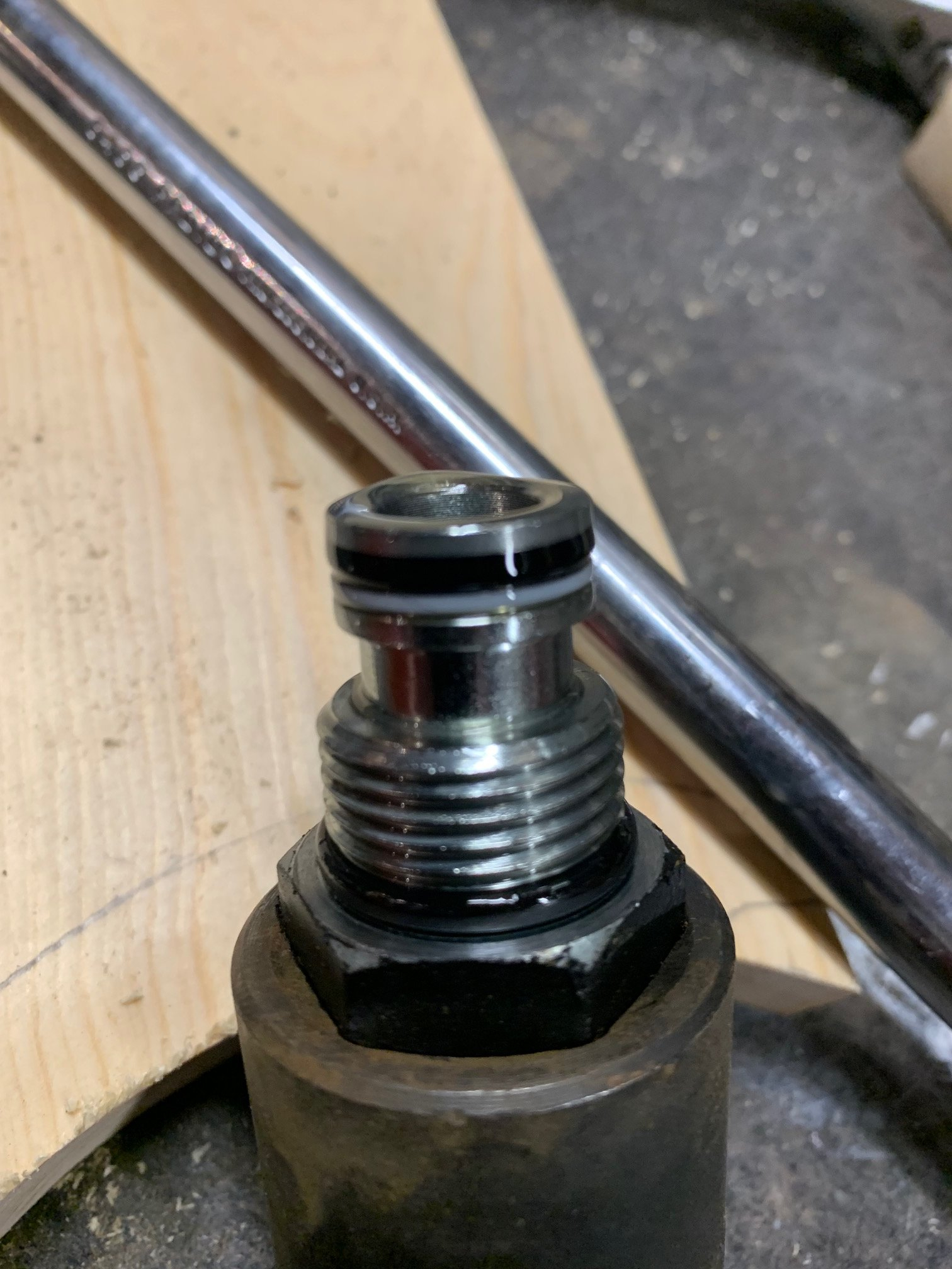

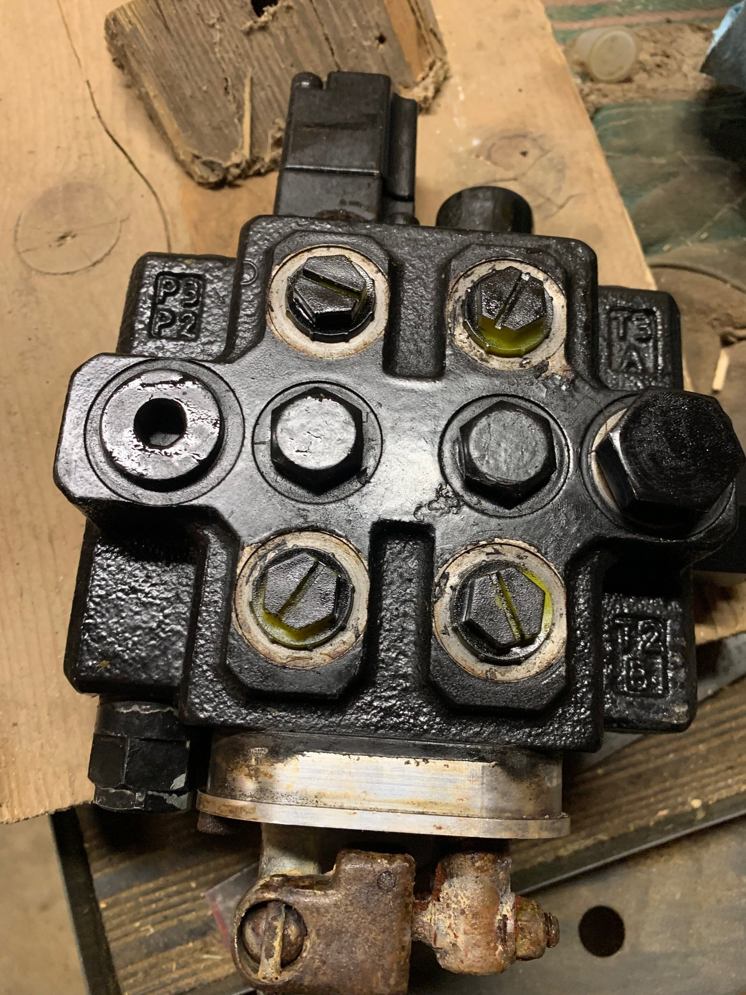

Here are some pictures of my CV122 Nimco loader valve. I am not a photographer but these will hopefully provide a little guidance.
Side view of the PB sleeve removed
PB sleeve installed in valve
Top view of valve. PB is cut off but would be on right side of valve
Thanks for the pictures. In the second one with the sleeve installed - does a hose attach to it to return to the tank? I thought I understood this conceptually but now I'm not sure.
Is that a plug that comes out on the end and would have a hose hooked up when installed on the tractor for a tank return?

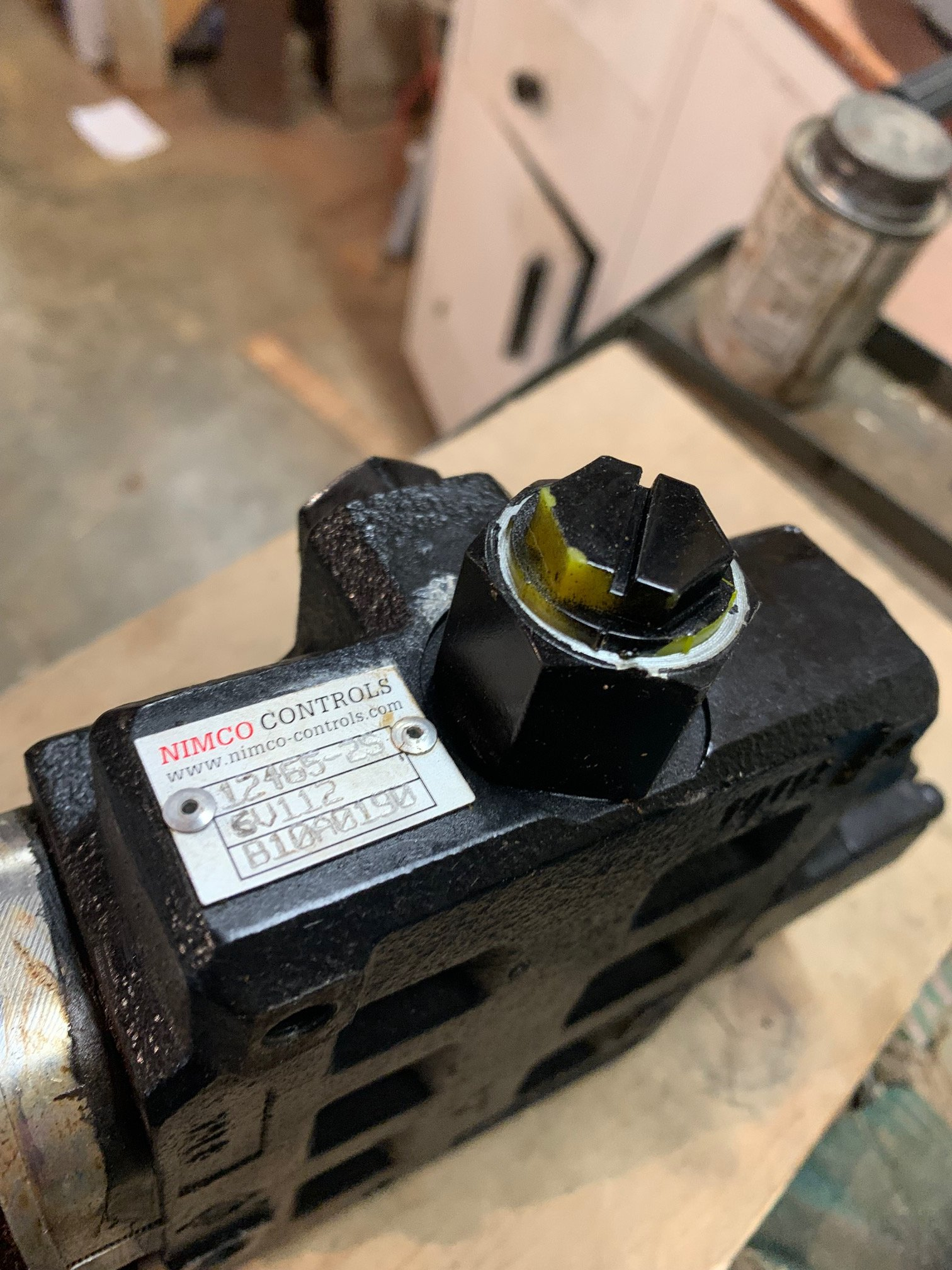

My valve unfortunately does not have the data tag on it and Nimco is having trouble finding a PB sleeve for it.
I'm not a hydraulics expert like all the other responders are but in post 33 something inside the valve sure looks like it's cracked/broken to me. I don't believe there should be any fragmented edges inside of a valve! Just my .02 cents.
I see what your saying. I am also clearly not an expert but my thought when I saw that was that it is just a product of a the casting in a non critical area (ie the tank return).

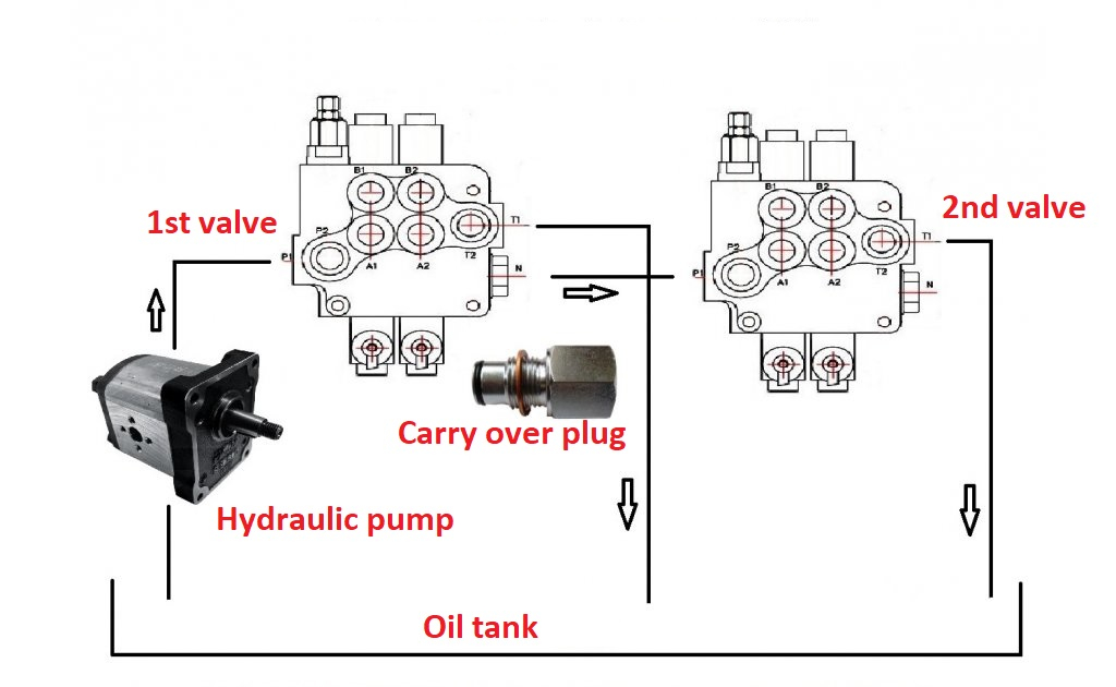

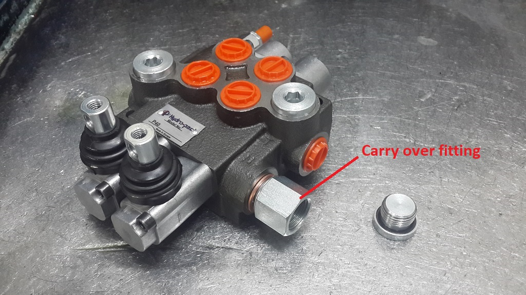

I borrowed a few pictures from hydro-pack.com that may help.
In the diagram it shows how to connect two valves correctly. The first valve will have three hoses. First one is from pump, Second one goes to tank and the third hose goes from power beyond port to the second valve.
The second valve only needs 2 hoses because it is the last valve in series and is not feeding another valve. Your valve is like the first one pictured as it feeds the 3pt hitch. So there would be a hose connected to the power beyond sleeve.

Thanks, OK. I did have it right.

The power beyond is the port that can be pressurized and is used to feed other valves. Exactly what K5 posted with pictures. NOTE: You must also have a tank line going directly to tank on this valve
Yes you require a separate tank line

Mandi at Nimco Controls tracked it down, this is the valve that's on the tractor:
https://nimco-controls.com/sites/default/files/product-literature/CV432-2_0.pdf
The power beyond sleeve (or HPCO as others have stated) for that is $101.50. beggars can't be choosers!
