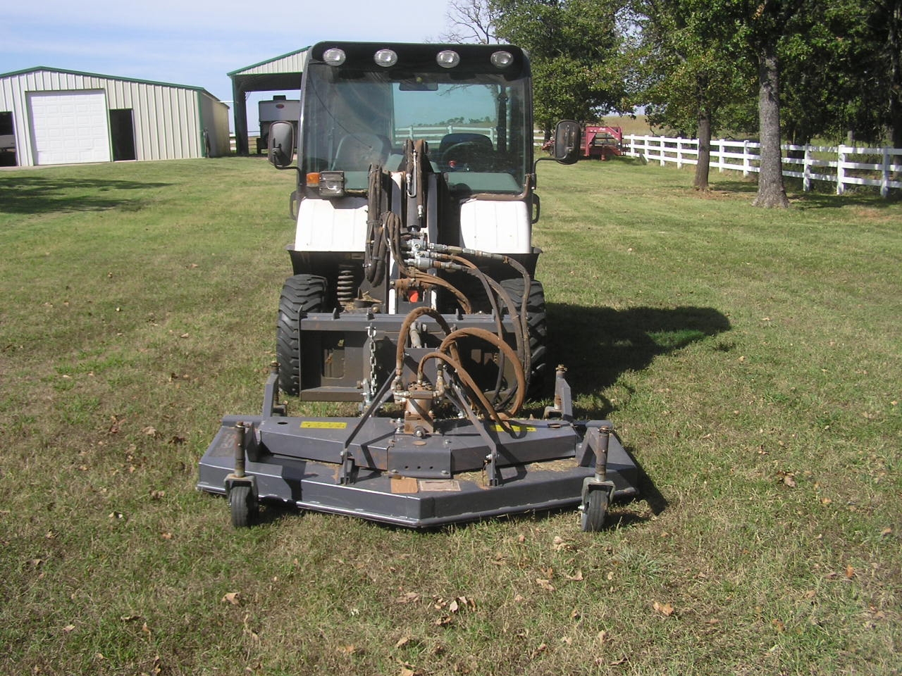

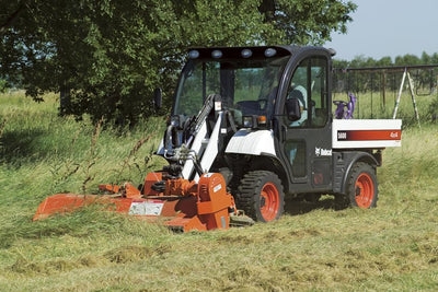

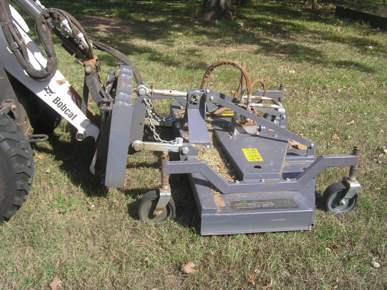

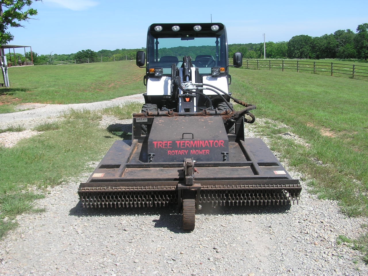

There isn't a PTO shaft on the front of most tractors in the US to run a flail mower. If you intend to run a hydraulic cutter on the front of any tractor, you need to check the specs to see if it can actually run the hydraulic implement you are considering.
There are front mounted tractor tractor pole saws, both circular and chain. Home
Not what I would be looking for as a front mounted flail mower, but I can think of things where this would be quite handy. Thanks!
   / TYM T474HC at the top of my list to buy

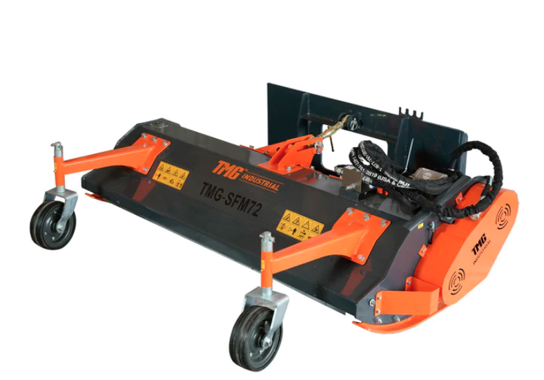

#12
Well, those flail mowers being front mounted are what I would like to have, but none of the tractors I have considered would have anywhere near the hydraulic flow rate needed to run them. (hydraulic flow rate: 18-23 GPM)

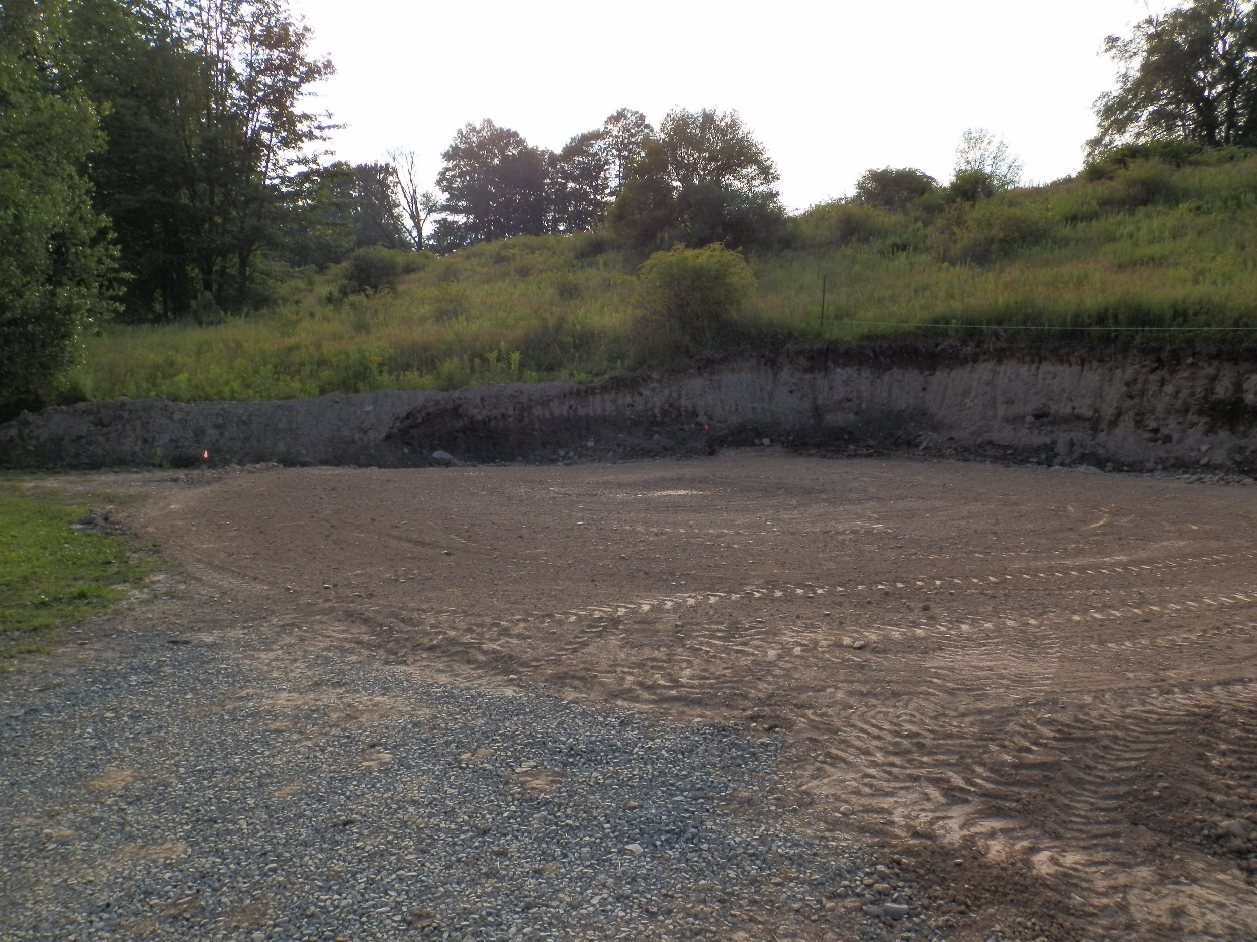

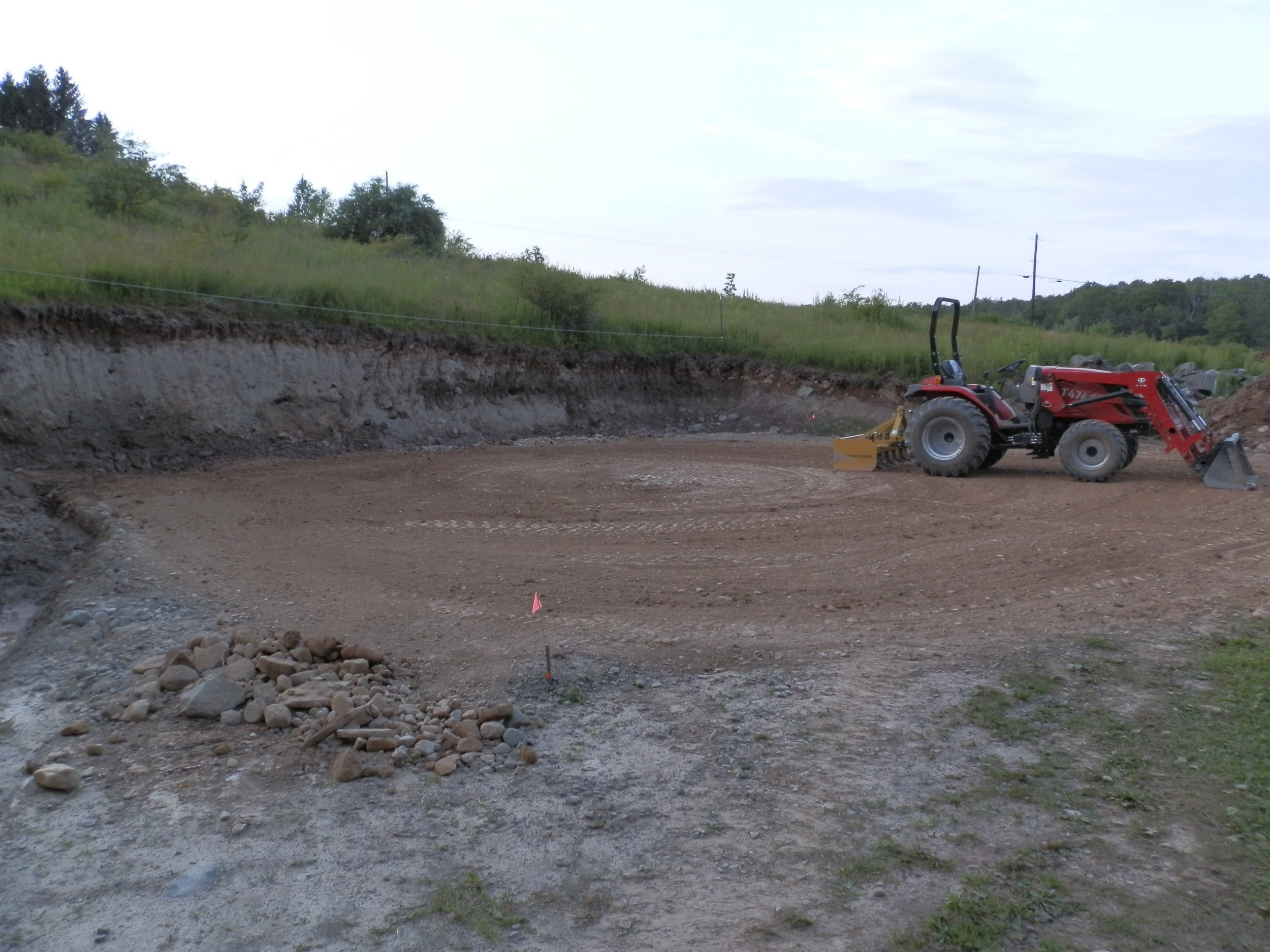

The TYM 474 is a great tractor. I got mine last year and here are a few pics I took of the work it can and will do. Cut out a large spot of a hillside for my new barn in the coming month. As you can see I have a boxblade on Herman right now. The backhoe is sitting in front of the old barn.

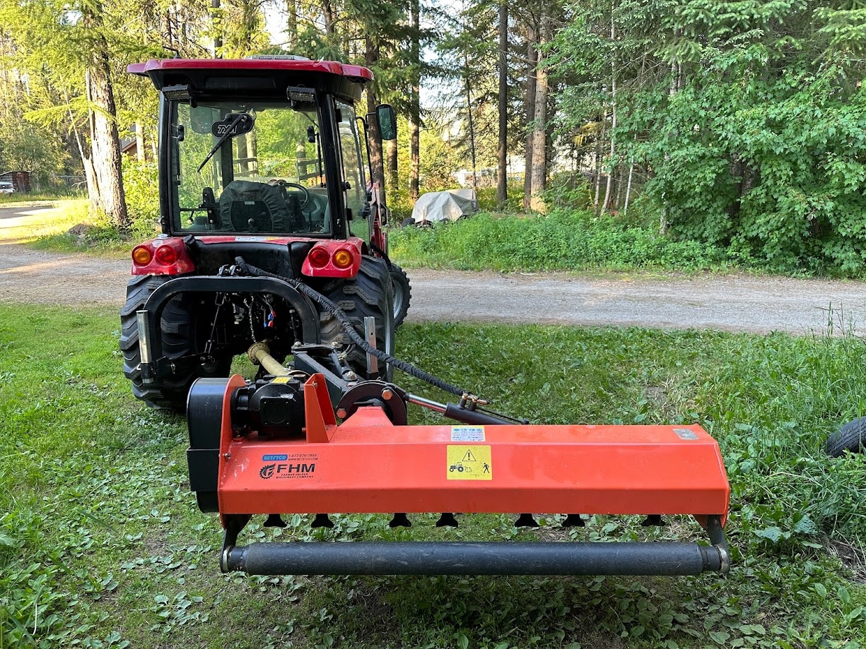

How is that mower. I have pretty much decided to get something along those lines instead of a rotary cutter. Looking into the options.
What kind of PTO protection does it have?
It uses a bolt for protection, I've replaced it twice in 50h in heavy 6 foot tall weeds.
