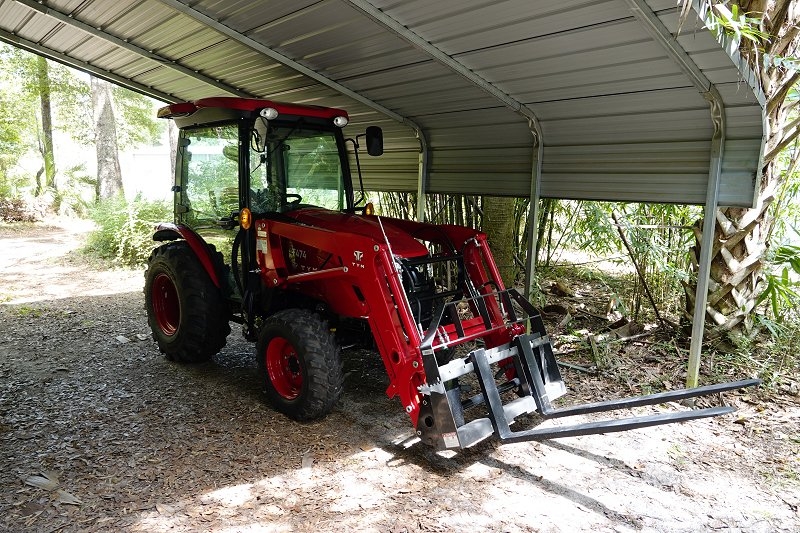

Well, here is a question I have. Should I be able to use the joystick to raise and lower the loader AND roll the bucket (or in my case the pallet forks) at the same time? Basically move the joystick to the "corners" of travel and activate both functions concurrently?
I am not able to.

Looking at buying a 474. My dealer wants $1300 for the 3rd function at the FEL installed. Does this seam fair or should I do it myself.
Also, it only comes with one set of rear remotes and I would like to add 2 more. I am not paying them $900 for them to put it on. Is there a better place to purchase the kit ?

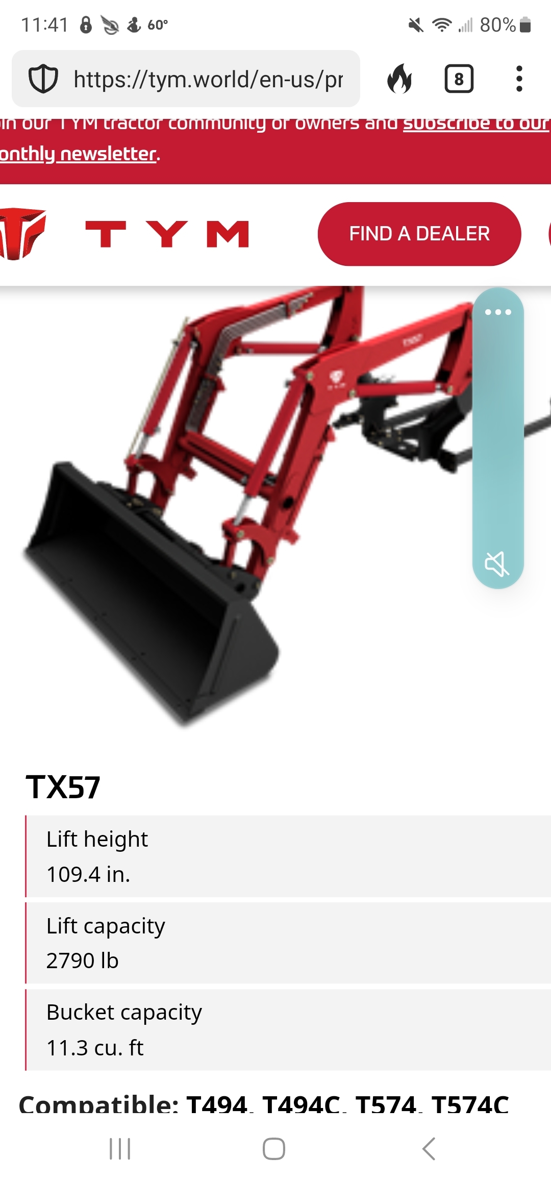

Many other brands advertise heavy lift capacity, but the tractor weight isn’t commensurate with the advertised lift capacity. What the loader hydraulics can lift seems to be unsafe for the light weight of the machine. My MX will lift just under 2400 pounds, but one ton feels pretty heavy for the machine weight. I wouldn’t want to lift more on that size/weight machine. Yet I see other brands of comparable machine weight advertising a lift capacity of 2700 pounds. There’s hydraulic lift capacity and safe handling capacity. I wouldn’t want to lift more than my MX capacity unless the tractor weighed significantly more. And yes I have filled rear tires and at least 1000 pounds of 3ph ballast when I’m lifting anything heavy with the loader.
That's the thing. Your MX is lighter than my 574 that lifts 2700 pounds. Part of the reason I can lift more is the heavier base tractor and bigger cylinders. No matter what you add for ballast, other brands can add them, too. Just breathe deep and accept that Kubota isn't the best at everything. They have positives, but they are straight up weak at lift.
The 3rd function for my 574 was right about $1000. Most of that is the parts.
It came with 2 sets of rears standard. (494 is the same)
Your TYM574 has a bare tractor weight of 3887, my MX6000 has a bare tractor weight of 3734. Both weights without loader or ballast. A difference of 153 pounds? The lift capacity of the TYM574 loader is 2478 pounds, and the MX loader about 2400 pounds. Not a significant difference. I invite you to lift 2478 pounds. The hydraulics can no doubt do this, but the butt pucker would be extreme, especially as you move this weight any distance. 2000 pounds on this weight class machine is all that I feel safe lifting and moving, even though the loader specs say 2400 pounds. Unless you have an iron butt, I don’t think you’ll be lifting and moving 2400 pounds with your 574. I would want a larger frame heavier machine for any lift approaching 2500 pounds. The specs are a marketing ploy more than a practical use measure. The TYM does have a price advantage over a comparable Kubota, no doubt, but capabilities are a wash.

That makes for even more butt pucker. 2800 pounds on a bare weight 3887 tractor? Try that and see how stable your tractor feels, even with filled tires and 1000 pounds on 3ph. I’m skeptical that this is a real world practical use. Seems like the hydraulic pressure is turned up to achieve this, but is it safe?
