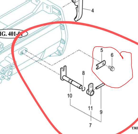

Does it make sense to remove the screw and cover plate and check for rust?
Number 5 & 6
/ TYM TX 3500 Cannot switch between forward/Natural/Reverse #15
Number 5 & 6
I'm sure it is just a keeper that fits in a slot of the shaft. Removing it would greatly aid the spray getting in and would allow to to look for evidence of rust. I would be careful of the shaft moving in or out with the keeper removed though.
