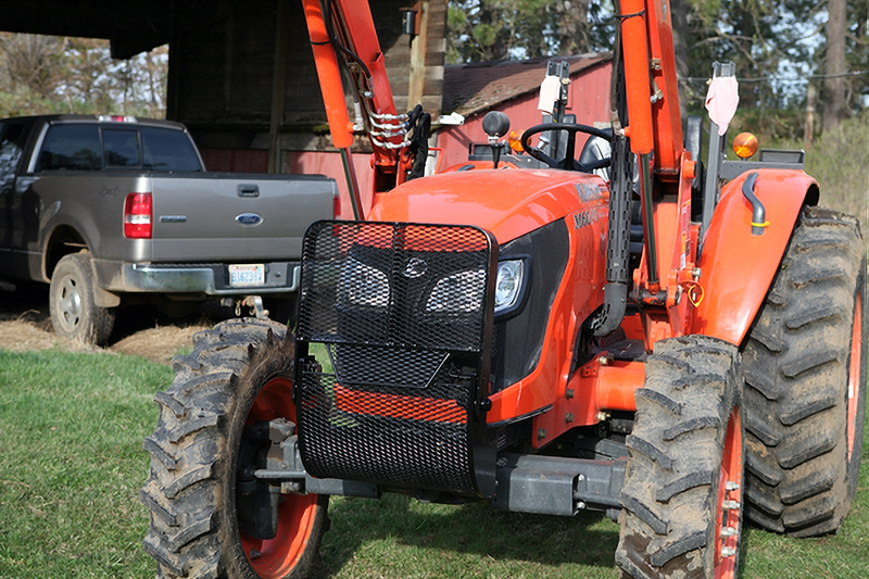

It appears that the Mahindra 26 XLT does not have Agriculture wheels. Ag wheels allow you to adjust width. Example - my rear wheels on my Kubota M6040 are set out at near widest setting - the front wheels are at a neutral setting.
If you want wider rear wheels - check you Op Manual and see if wheel spacers are allowed. This will make for a wider and more stable stance.

You can see - the rear wheels are set out. More than half the width is outside the lip of the fender. Outside to outside - 82".
