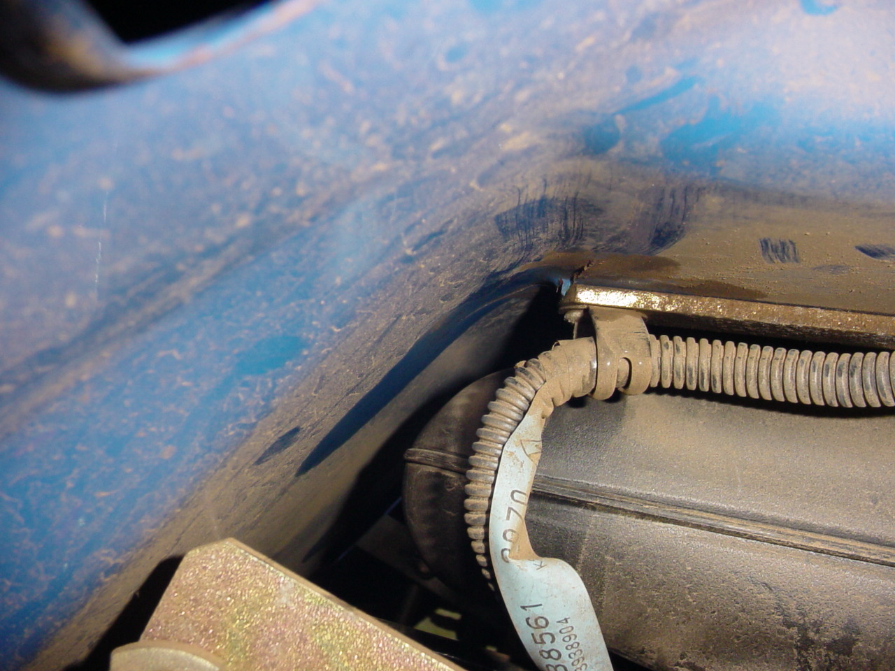

Attached are a couple pictures. One is a view of the front seat mounts and the other is from underneath. From underneath, I want to point out that when the bolt flexes, the nut actually hits the side of the fuel tank.
Just to recap - this is with 177 hours on the meter.
P.S. Like I told the dealer, I am not that fat....at 170 pounds....for it to break like this!!

   / TZ Body Cracking at Front of Seat Mount #13
I just checked mine. Not a problem ... yet. Is it reinforced underneath? What do they do about the crack in what I assume is fiberglass? Mine is only 8 months owned too...

Happen on my TZ24DA after almost 1-1/2 years. Stopped buy the dealer and was showing him and he said he'd get it under warranty - which he did! However, just 4 months later, it's starting to do it again. My dealer faxed me an exploded view of the rear fender/seat area and I'll have a machine shop make me a mounting base/support piece that will work. Here's a real kicker - when I told my dealer what I was doing, he told me to keep up with my hours and any expenses I incur and he'll try to get NH to pay me for them.

Both halves of CNH (CIH & NH ) I expect are doing the same thing. My DX24E did it and dealer told me CIH was suppying a reinforcing bracket to put under fender shell but they didn`t feel it was heavy enough so they had a local metal shop fab up a bracket twice as heavy as the CNH repair. Last I asked most DXE models had cracked , I would ask father -in-law (NH mech) about NH`s but they can`t seem to sell blue ones. They NH dealer stocks one NH and 30 Kubotas. CIH dealer has been selling Farmalls by the dozen. I have since traded the DX24E for a DX 26 for loader capabilities and 26 has been much more reliable.

I had this problem on my TZ24D a couple of months ago with only 65 hours on it. I contacted my dealer and he said even though my warranty had expired that New Holland would provide me with a new fender assembly and a re-enforcement bracket, installation was not included. I installed it myself.
Attached are photos showing the crack in the old fender, new fender sitting on my bench, new fender with re-enforcement bracket shown with seat mounted. The re-enforcement bracket came from New Holland not painted blue, it was primary tan so my dealer also provided a can of blue paint.

"ON top of the seat pan"? The reinforcement plate is designed to go under the fender area replacing the 2 yellow zinc support bars. On my third fender now and it seems to have fixed the problem. I had my dealer get me the plate and new fender and I swapped them out because they scratched the last one. I know it's a lawnmower, but it's MY $10,000 lawnmower!!!
Also, NH has issued a recall on all TZ series to have this done. IF you're an owner and have not been contacted, you need to contact your dealer.
