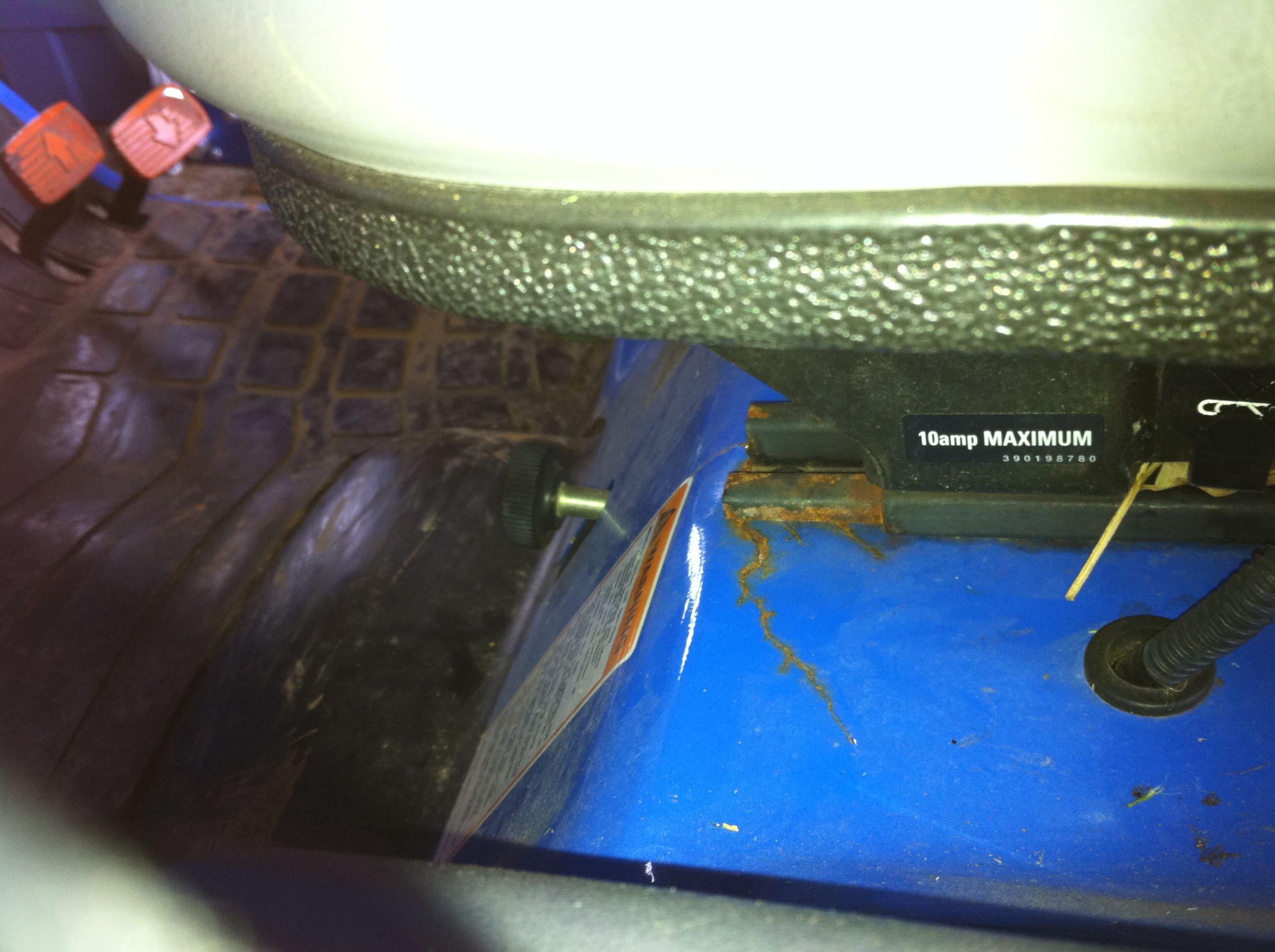

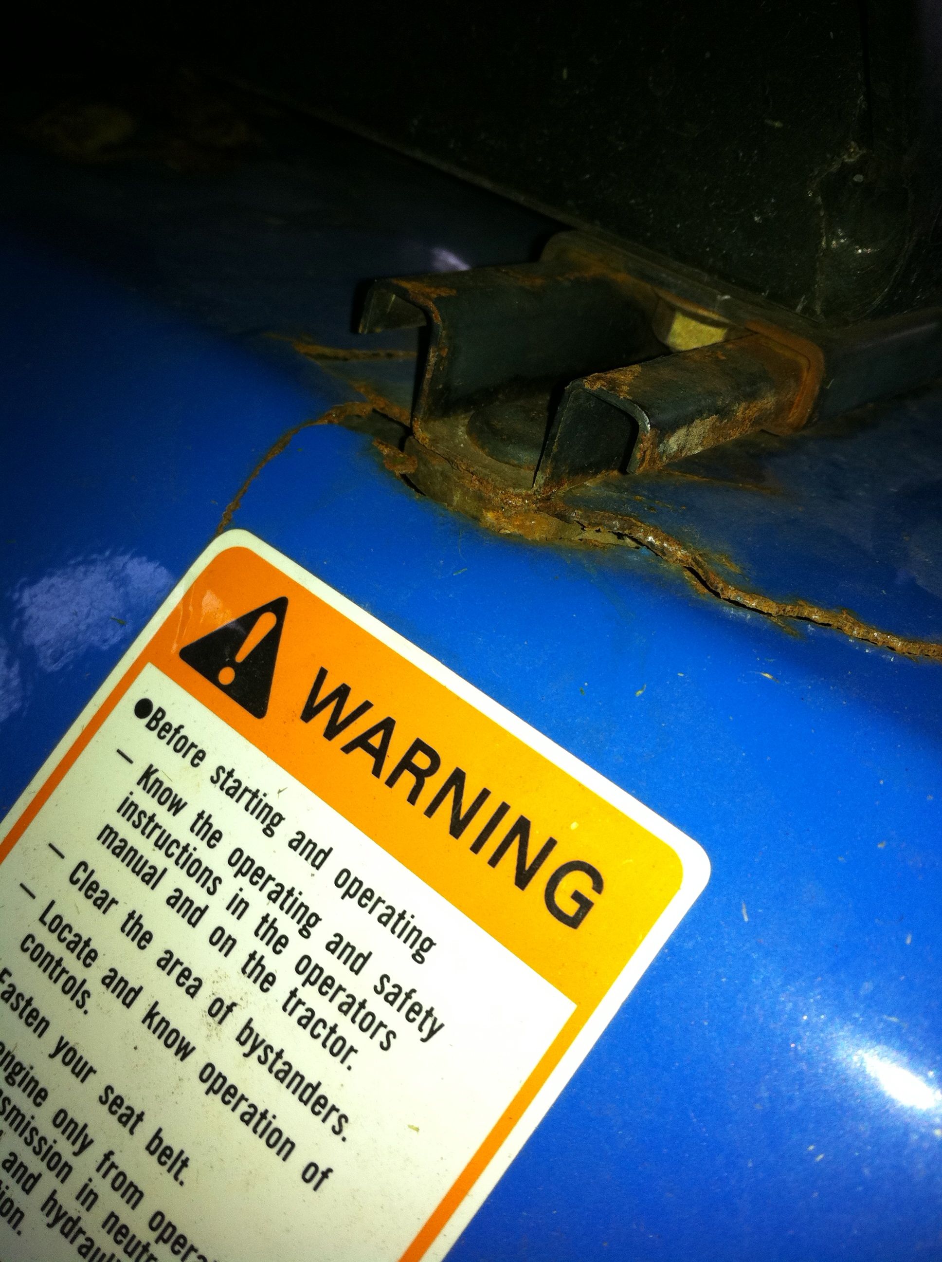

NH TZ24DA - 500 hours.
I now have the cracked seat support issue that is reported here.
See pictures.
This is a major product safety issue. NH says they won't replace but definitely knew about it and offered a $39 bracket that would need to be welded on. Major design flaw.
Unless this gets fixed at NH expense I'll never purchase a NH tractor ever. What junk.

No, the dealer ended up having to replace the entire top portion of the shell due to the cracking. They then used the double brackets to bolt on and support the weight of the seat. They finally agreed to pay a portion, NH paid a portion and I paid a portion since it was out of warranty but clearly the dealer had been servicing it all along and never noticed the cracks or alerted me to the damage. It was not noticeable until the seat started wobbling.
Suggest your dealer should easily be able to look this up or contact NH to discuss this cracking issue. It's been awhile now so I don't have the repair invoice handy. If I find it I'll come back here and post but your dealer can call NH and figure that out.
