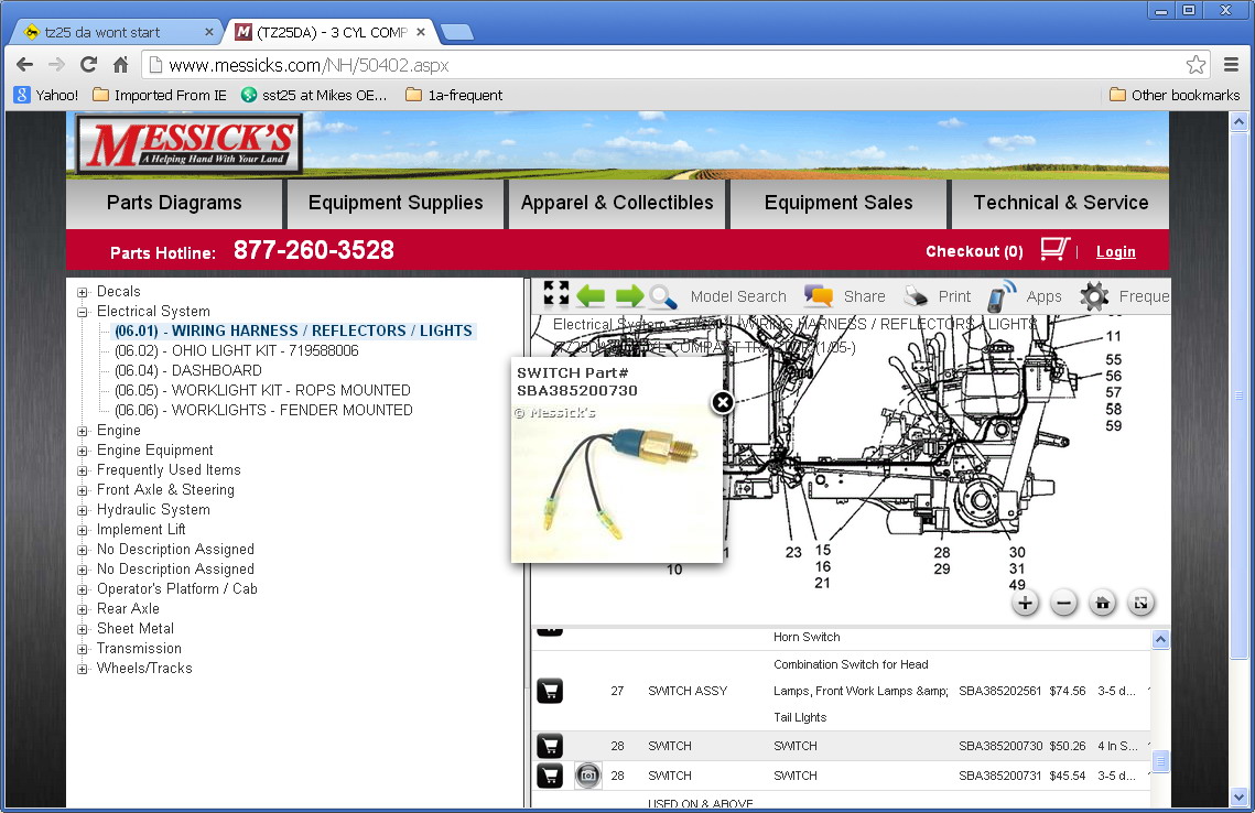

/ tz25 da wont start #8
Look at the locator diagram # 28/29 and the switch photo with part number. That switch screws into the side of the transmission and senses the transmission in neutral range. It has two wires with push connectors that are easily disconnected. If it is defective or the wires loose/broken, it will give the exact symptoms you are describing.
