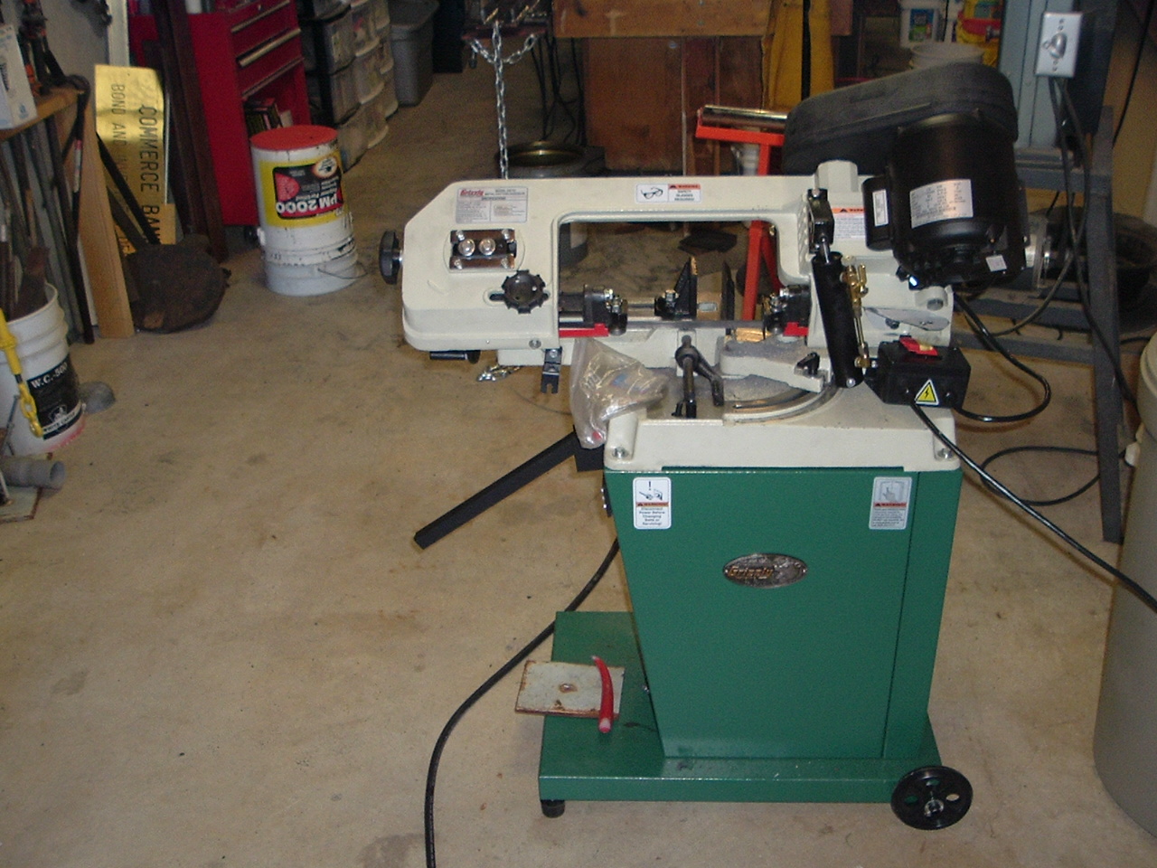

I had no idea how much metal I'd be going through during this process! I found a good local supplier for scrap steel, but didn't buy nearly enough last trip. The guy let me walk around the shop and pick up whatever I wanted from the drop piles, and only charged me $5/25lbs. I guess I need to go back and buy a lot more!
This also has me shopping for a cutoff saw....it never ends!
A bandsaw is really nice.. quieter, and no sparks.:)
That's the kind of bandsaw/cutoff saw I was talking about. I'm not sure why, but some folks seem to call horizontal bandsaws cutoff saws cutoff saws...maybe to differentiate between vertical bandsaws :confused:
Regardless, that's the kind I'm talking about. I went to an auction on Saturday because they had a clean Wells Model 8 listed with decent pictures....got there and the saw was nowhere to be found. All the other tools and machinery was there from the pictures, but not the bandsaw. :(
They seem to come up on Craigslist pretty regularly, so I'm checking that daily. This one came up last night...kind of a monster, at 10x16" cut, but would likely last forever:
MODEL 1 WELLS HORIZONTAL BANDSAW
   / Ugly beads, critics welcome... #104
Maybe diferent parts of the country have different names for it, but to me and around here a cutoff saw is a 14 inch circular abrasive saw. Lotsa noise and lotsa sparks. Works, but is considerably cheaper than a good horizontal bandsaw. They are often priced under $100 in some places.
