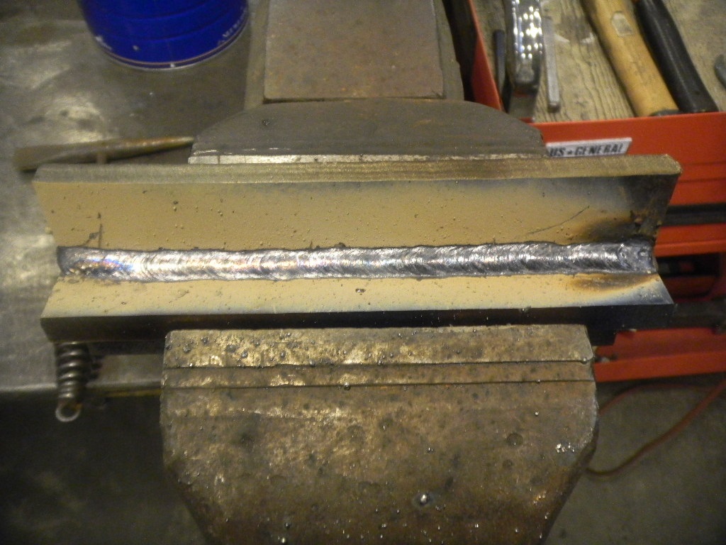

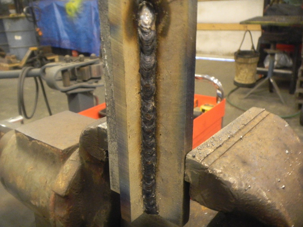

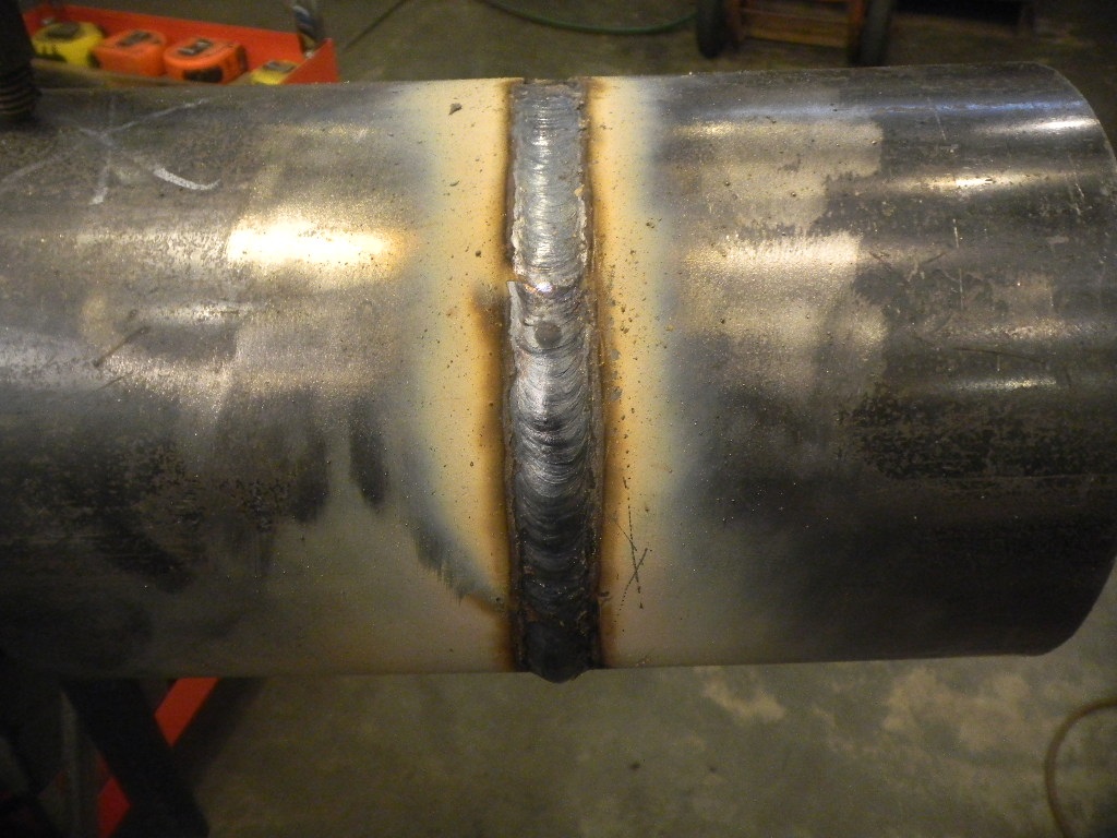

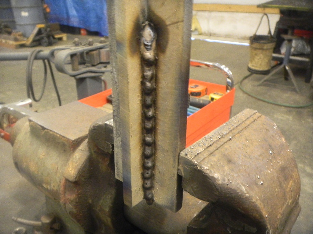

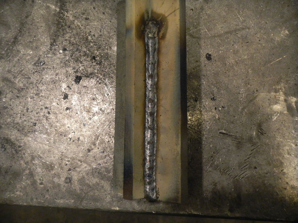

GManBart yesterday I found some 1/8" ESAB Acclaim 7018. This morning I thought I'd see how it runs on the Everlast PowerArc 200ST.
The flat fillet was run at 90-AMPS.
The vertical up fillet was run at 85-AMPS.
The cap weld on the pipe was also run at 85-AMPS.

SA,
It would be interesting to put an ammeter on your PowerArc 200ST. Those welds look more like 115 to 120 amps to me. 85 amps is right for 3/32 rod for me.
