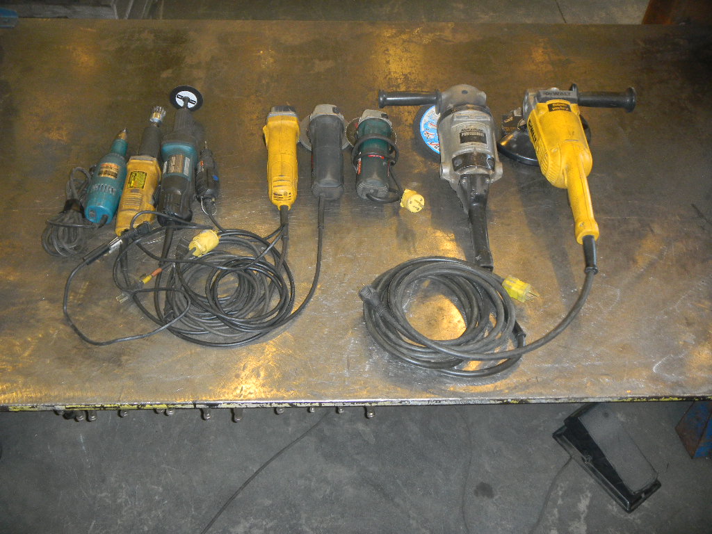

Those welds are a huge improvement:thumbsup:! Can't wait until you get into vertical up hill welding.;)
Guy only needs one grinder!:D

Thanks! Vertical up is next in line, for sure!
LOL...forgot to add I'm also looking at die grinders, so that makes two more I plan to acquire!
