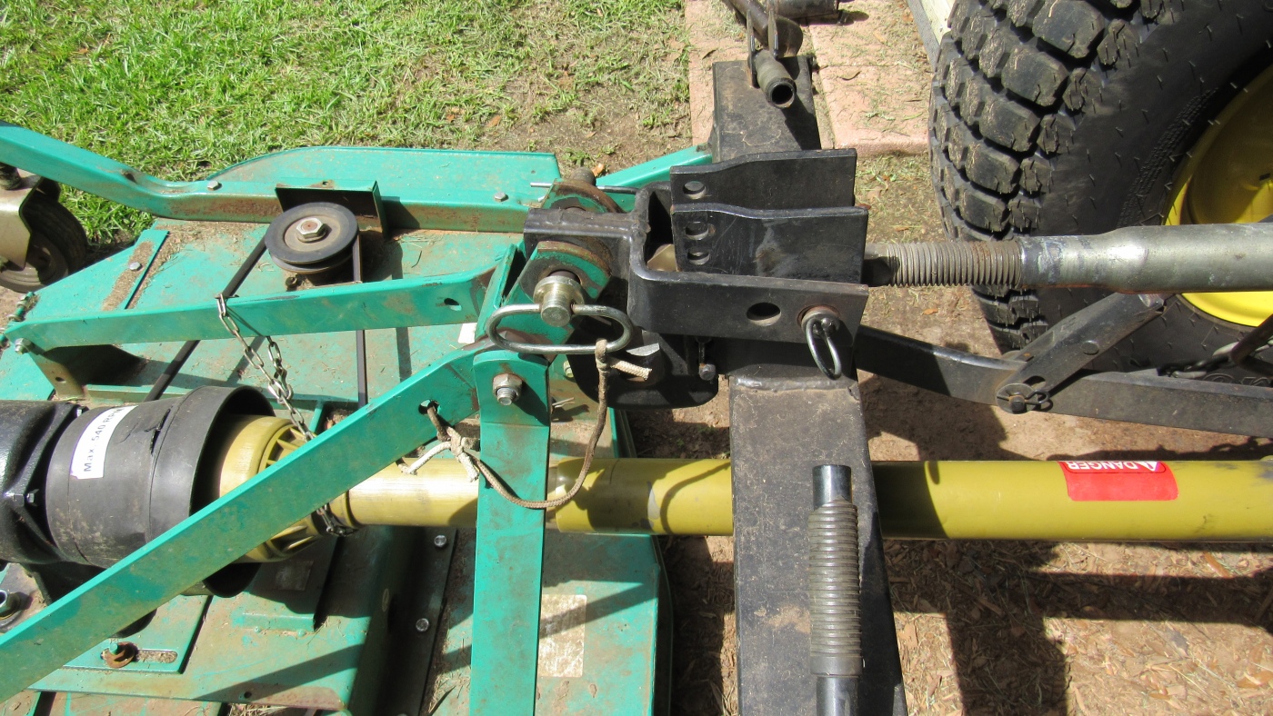

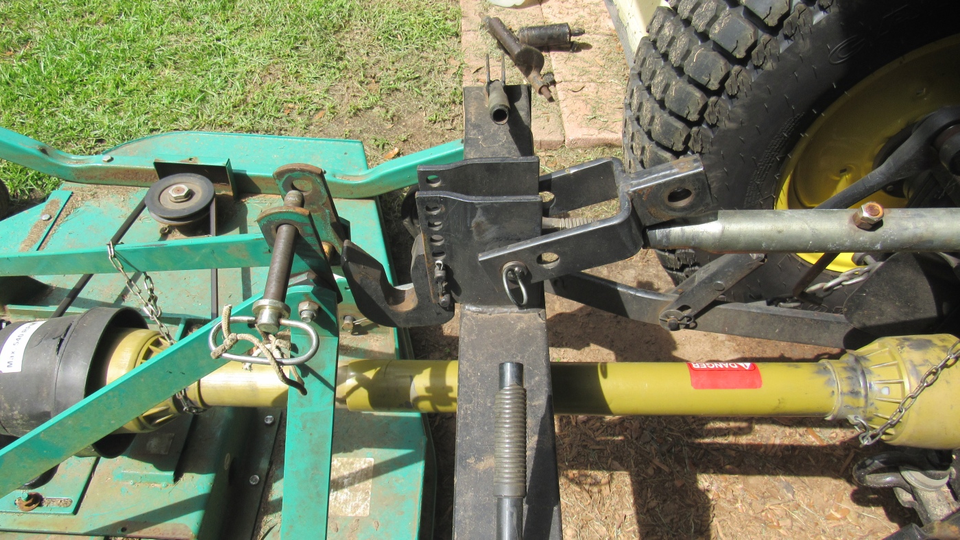

Here is how I use my short adapter on my finish mower. Note that all my implements are modified to use the top hook in the lowest position so I don't have to remove it for using the adapter. When not needed I just pivot the adapter forward and leave it on the top link pin.
On my brush mower I remove the pins from the top hook and move it up to engage the top pin on the mower. Then I just use the top hole on the hook and let it pivot with the mower float. That mower has a slotted top link connection so I get float from the slot and the hook pivoting.
I suppose I could use the same method on the finish mower and do away with the adapter all together but unhooking the hook is more trouble than flopping the adapter over.

I tried this method before going to the adapter and it came unhooked during use. If it works for you then great but I see nothing to prevent it from coming loose.
Having the ability to connect the lift links without fighting with them by no means defeats the use of a quick hitch. It may temporarily make it more like the Pat's system but does not defeat the main advantage at all.
