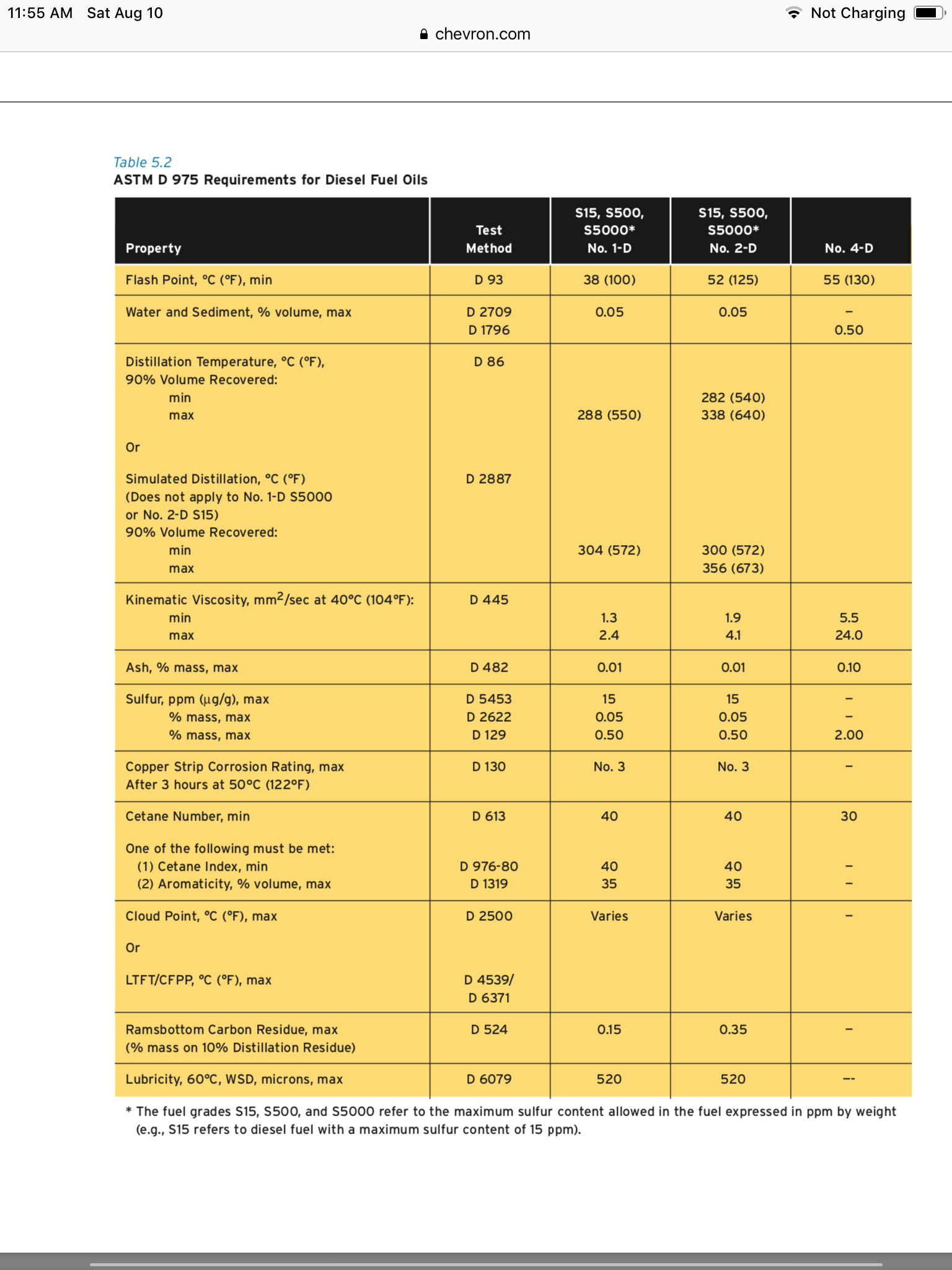

Here is the ASTM spec for diesel I got from a Chevron write up. My tractor has a Mitsubishi engine with Bosch injection. The ASTM cetane is 5 points below MHI recommendation and lubricity requirement is 460 vs 520(lower is better). Not sure if this is a big issue but I use an additive that claims it improve both I view it as cheap insurance . And from what I’ve read yes sulfur does improve lubricity but other countries have ultra low sulfur fuels yet have better lubricity requirements than the US. And lubricity is of more concern on mechanical fuel injection systems.
I would have to disagree with this, with the extremely high pressures of the common rail systems they are less tolerant of fuel quality then the older mechanical injection systems.
   / Ultra Low Sulfur Diesel Fuel #90
Ok, you could be right. I was just passing on what I read. I have no knowledge or experience.
