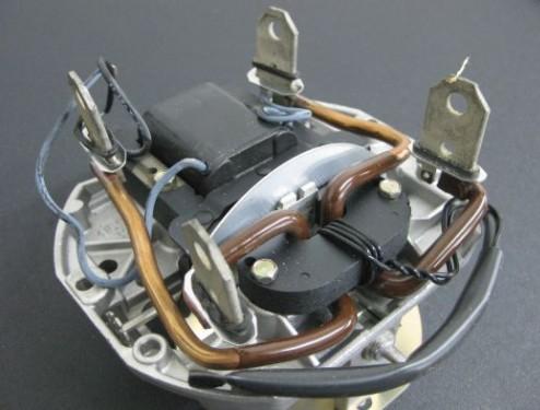

Problem solved. It DOES measure BOTH legs and the balance doesnt change anything.
This photo is courtsey of a fellow member on here, I cant take the credit:
I sure am glad you came up with a positive photo of the innerds. It only takes a small CT loop inside at each side to make it work. Now to see a digital one with the shut-off contactor? We had some smaller ones here years ago on Air-conditioners. They were radio controlled and dropped off after a power failure to cut-down of load of line after a fault. TVA also put them on Elec.Hot-water heaters for the same purpose. We recieved a rebate on our electric bills for the service. After 5 years they discontinued the program??It was called Cycle and Save?
