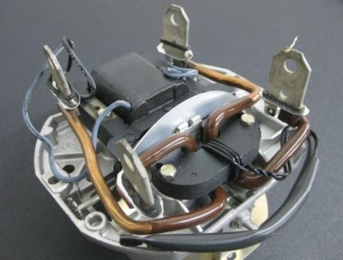

   / Unbalanced electrical load #35
Problem solved. It DOES measure BOTH legs and the balance doesnt change anything.
This photo is courtsey of a fellow member on here, I cant take the credit:
   / Unbalanced electrical load #36
"The question is, does the electric meter measure the greater amperage draw of the 2 legs or an average of the 2?"
The answer is - which method generates the most revenue for the power company! :laughing:
   / Unbalanced electrical load #37
I sure am glad you came up with a positive photo of the innerds. It only takes a small CT loop inside at each side to make it work. Now to see a digital one with the shut-off contactor? We had some smaller ones here years ago on Air-conditioners. They were radio controlled and dropped off after a power failure to cut-down of load of line after a fault. TVA also put them on Elec.Hot-water heaters for the same purpose. We recieved a rebate on our electric bills for the service. After 5 years they discontinued the program??It was called Cycle and Save?

   / Unbalanced electrical load #39
Ld1.. Based on HR3's theory, 1000w on one leg, 500w on the other, and you are paying for 1500w. Add 500 to the lower leg, and now you are paying for 2000w.
I said 1500 watts not 2000.. That is a number you came up with...
orexok Much better thank you, but from what I understand, one leg provides the voltage reading and the other the amperage for the "induction"motor. Together they measure wattage. But what if the leg measuring amperage is out of balance? The voltage leg will always be constant, the amperage leg can vary.
No both legs supply power to the little induction motor.. Forget the word amerage,,, you are only dealing in watts.. Ok lets say you have a 100 watt 230volt light bulb and you power it with 120 volts.. How many watts is the bulb useing ??.. 50 watts would be the answer.. if you supply 230 volts to the bulb you get 100watts.. Your paying for the watts..inbalance dosn't matter to the meter,, you pay from each leg what you are useing..
The electrical meter is much more complicated than a little induction motor.. but I hope you get the idea..
