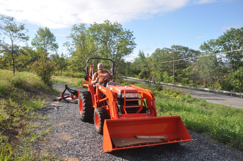

Just giving you guys a update. Like I said I went to work for 3 weeks and during that time I did a lot of thinking. So when I got home I signed the papers on a L4400.

Ok I just talked to my dealer, should have the tractor in just a few days. Like I said it's the L4400 w/quick attach fel, rcr1860 5' cutter, sbx60 box blade, round bale spear, 1 rear remote, loaded r1 tires, and just a couple small things. I really appreciate all you fellas for your willingness to give me info to think about. You all helped a lot! Keep an eye out over the next several days in the owning section. I'll be putting up some pics when I get it. Thanks again!
/ Uncertain #27
The L4400 will handle a 6 foot bush hog (RCR1872) without any trouble. I'm not sure if the RCR1860 will cover the tractor tracks or not, it's the same one I have and it just covers the track from the L3400. The L4400 is quite a bit wider than the L3400, so you may want to ask the dealer about that before everything is delivered. I don't think there's a big difference in price, maybe $100 or so??
If the BB is the same width (60") you may want to investigate that too.
Anyway, congratulations!! I don't think you'll regret your choice of machinery.

I did a quick search online and found that the L4400's width is 62.4" and the wheelbase is 72.6". I should have been paying more attention I guess. The dealer had to order a lot of stuff and im not sure if the BB and cutter are things he had to order. So now I am a little worried. Thanks for bringing that to my attention! I'll call him first thing in the morning!!

I called the dealer and switched to the 6' cutter. I also got the 72" box blade. The box blade I think is a catch 22. The 72" might be a little big for the tractor as far as having a box full of dirt but on the other hand the 60" might be tucked up under the tractor to much. Thanks again for bringing that to my attention chilli.

Good decision! :thumbsup::thumbsup:
