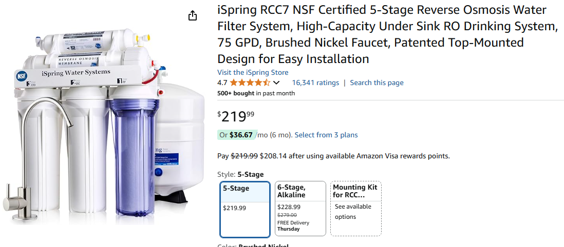

We've used this for over 10 years, and love it. I'm on my second one. Wife drinks the well water, no more carrying water.
