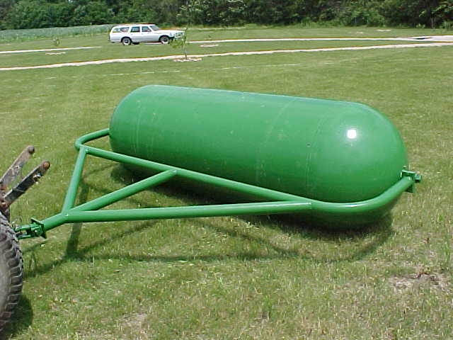

<font color="blue">I have a propane tank on the property that has been abandoned by the company that installed it..... </font>
They make one heck of a lawn roller. /forums/images/graemlins/cool.gif (see attachment)

the color is wrong for my tractor and the size is too large for my tractor. Other than that, that is a great idea if I needed something that large. Just not certain how you would weld on a tank that previously had propane in it...

You want to weld on a propane tank?
Run steam through it for several days - let it cool - use meter to check for combustibles and oxygen -- option to purge with nitrogen next-- check for combustibles and oxygen - start welding.

I filled a propane tank with water before doing anything that might make sparks. After that fill and dump, propane water stinks by the way, the tank never really had the propane odor.
I would weld on it now.
