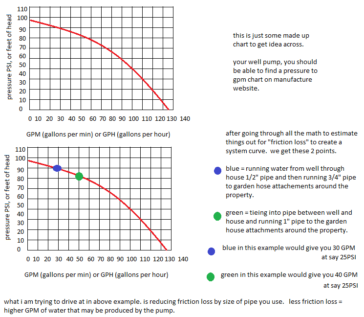

an attempt to go over pump curves, and giving an example of difference in pipe size and friction loss.
see attached diagram...
again below chart and numbers are only an example and will most likely not be near your setup. but hopefully help get idea across of things.

ok here is some new information:
i got my new GPM measurement from a hose bib right before it goes into my softner/pressure tank system in the basement: 30 seconds to fill a 5 gallon pail. Talking to my plumber who set up my well he is telling me my pump is a Goulds 10GS05412 four inch submersible well pump. This pump is a 10 gallon per minute ½ HP 230 volt.
So with this new information where do i start?
I did some of the Design data form information that i knew anyway and here is what i got:
Dry method:
1/2 HP pump
Dynamic water depth: 33 feet
Elevation difference: 10 feet (water line from basement to new irrigation system manifold)
Elevation head: 43 feet
Design Pressure: 50 PSI
Design Head: 115.5 ft. Hd
Total Pressure head: 158.5 ft. hd.
Initial Design flow 6.8 GPM
Wet method:
design pressure: 50 PSI
Inital design flow: 10 GPM
NOW the reason for the different in my opinion is that the elevation difference between me doing the test was 0 as i will not have to rise 10' to get the water out of the house as i got the water directly from the basement.
Pressure loss table: (keep in mind there is alot i dont know and I did alot of estimating which will be noted below:
water meter: 0 PSI
backflow preventer: 3 PSI
filter: 0 PSI
house mainline: 1 PSI (1" mainline from well into house is approximately 10' long, then from mainline to new manifold will be about 20')
irrigation mainline: 24 PSI (1" mainline from manifold to house bibs will be 1 line tied together for a total of 880')
valves: 5 psi (ball valves at manifold)
Elevation change: 4 PSI (from basement up to ground level outside is 9')
sprinklers heads: 0 PSI
Laterals: 6 psi (to keep maximum 20% of spinkler head value above????)
Total PSI: 43
SO if the above is correct my design of 50 PSI will work as my total pressure loss is 43 PSI.
What do you all think?
