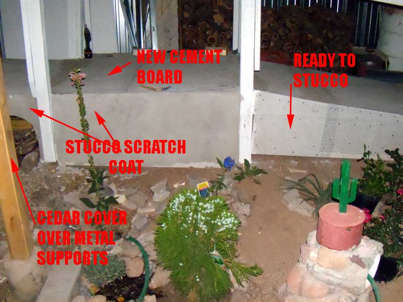

When you plan to stucco, its also good to put on expanded metal.

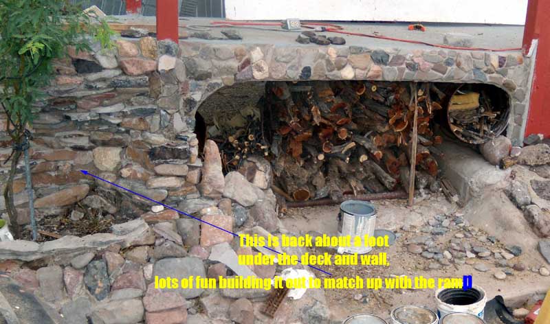

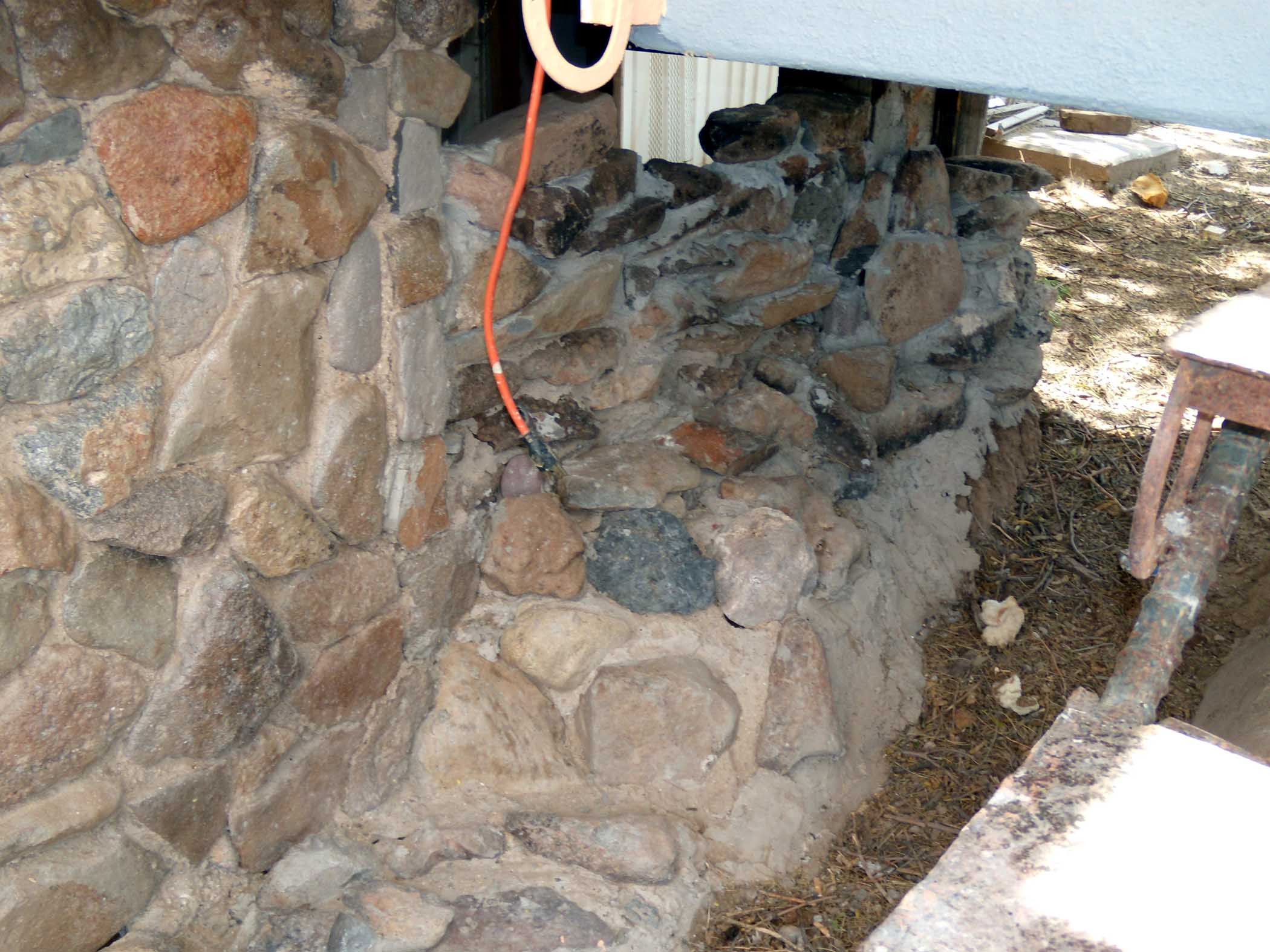

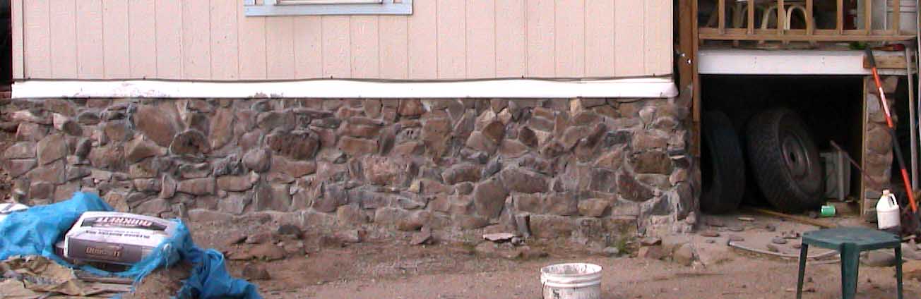

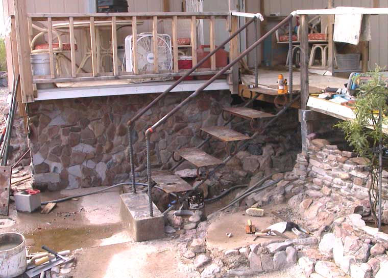

First picture shows first coat of stucco & next panel ready to stucco. 2nd Picture is part real rock wall and veneer rock over the wood rack. 3rd Is a veneer rock wall behind the stairs, real rock wall under the dick (Not completed.). The rock is all native stone, very few were cut or chipped to fit. When done all the rock and grout was sealed with concrete sealer.

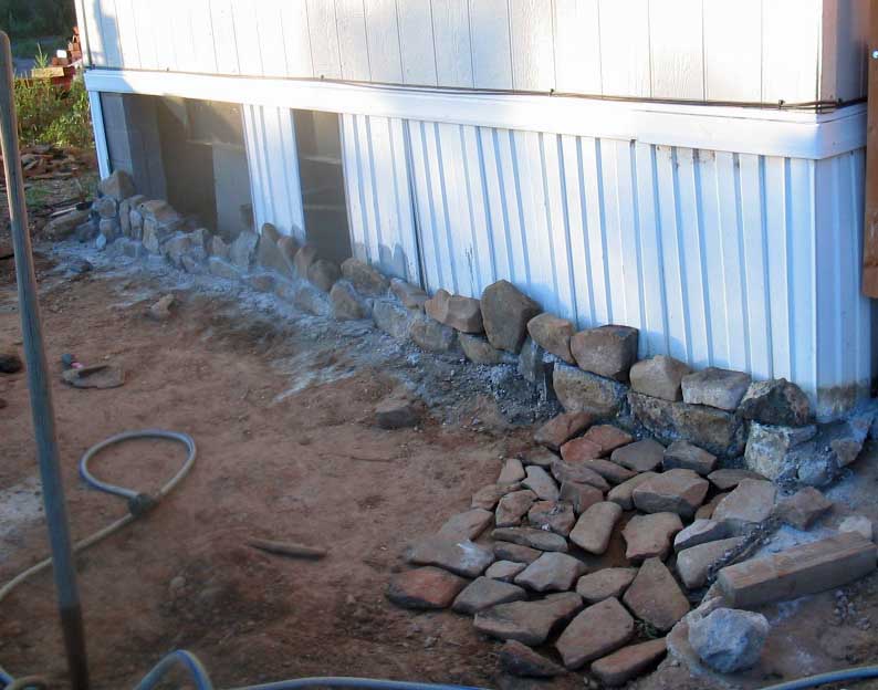

A little more on plastic skirting as you can see in the pictures, much of it is gone. In this part of the world the sun eats it, then the wind blows it off.
With what is left I used as a backer to build a rock wall. Saves a little time waiting for mortar to set. On the front side of the house a brick wall is planed.
A free standing rock wall needs to be wider than the one in the pictures.
What ever you winde up doing, the low side needs to drain in case water gets under the house, leave at least 1 vent and an access panel will be needed.

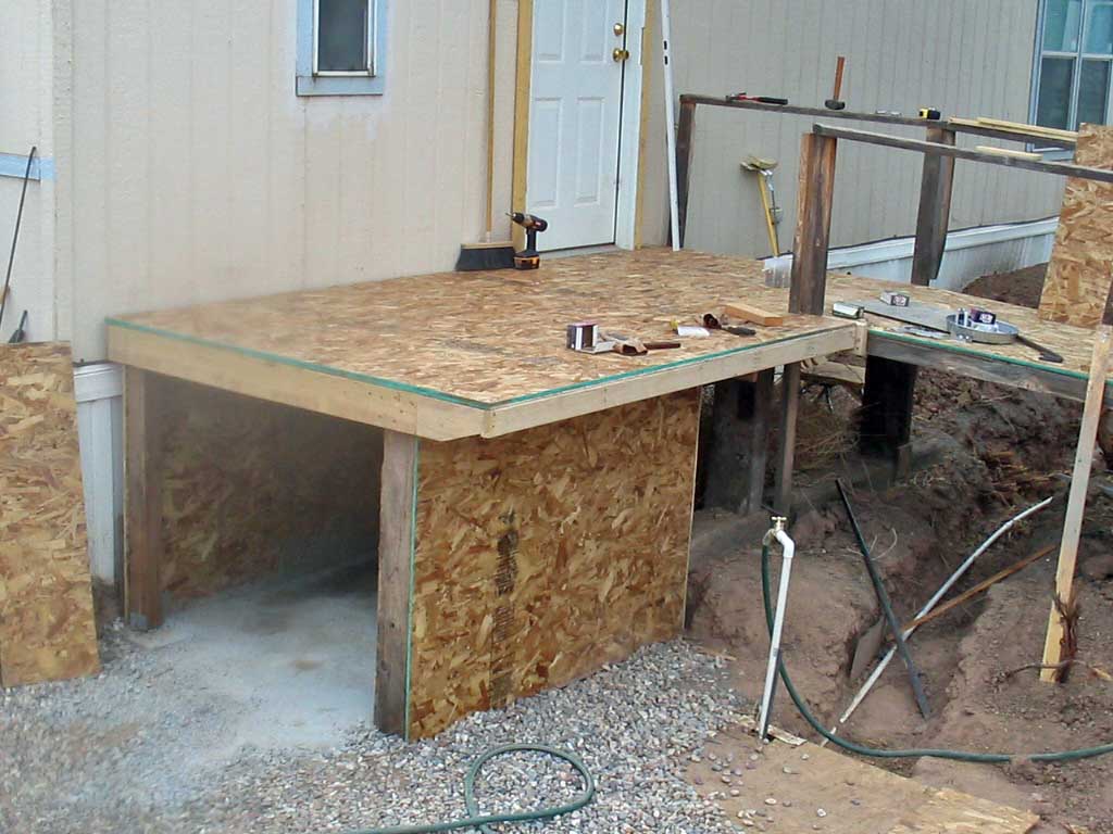

A side note: All rock work, stairs, deck and stucco was done by me, without help. Back hoe on tractor was used to set the stairs, those suckers were heavy.

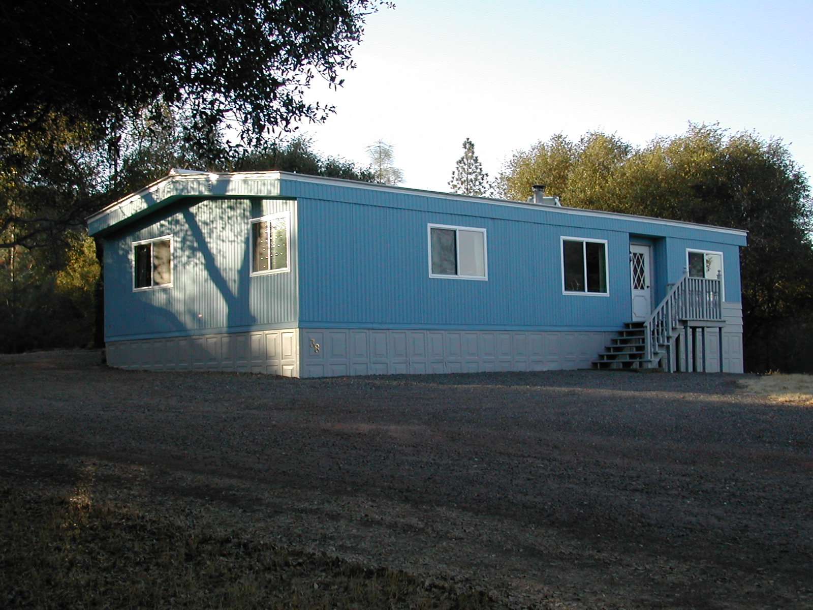

That is an excellent solution for mobilehome skirting. I located some damaged metal garage door panels (free) and installed them the same way that Dex did the roofing sheets. Weedeaters pose no problems. Heck, I even use a propane weedburner to "clean" the gravel every year, burning right up to the skirtiing. The worst that's happened is having to clean a little soot from the panels.
I live in a brush fire area so keep all flammable things away from the home, as is obvious. It may look stark, but it's more firesafe.
Phil
