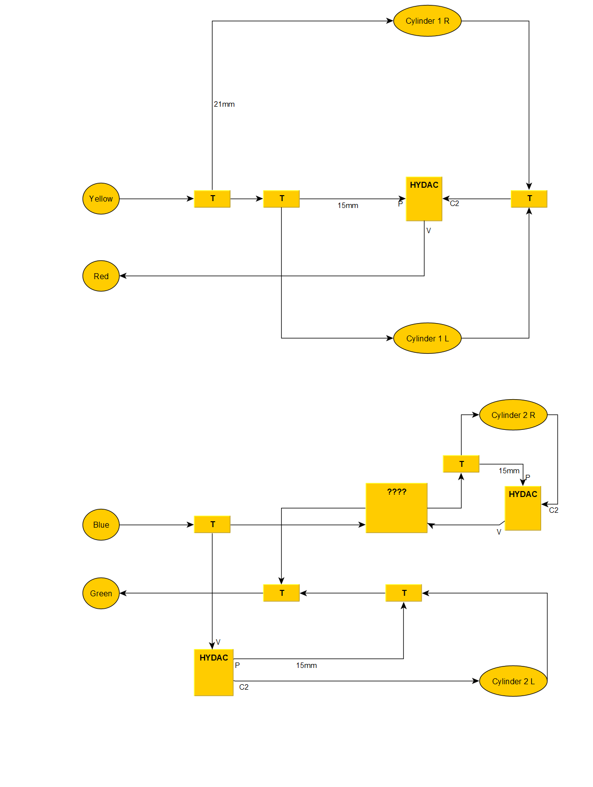

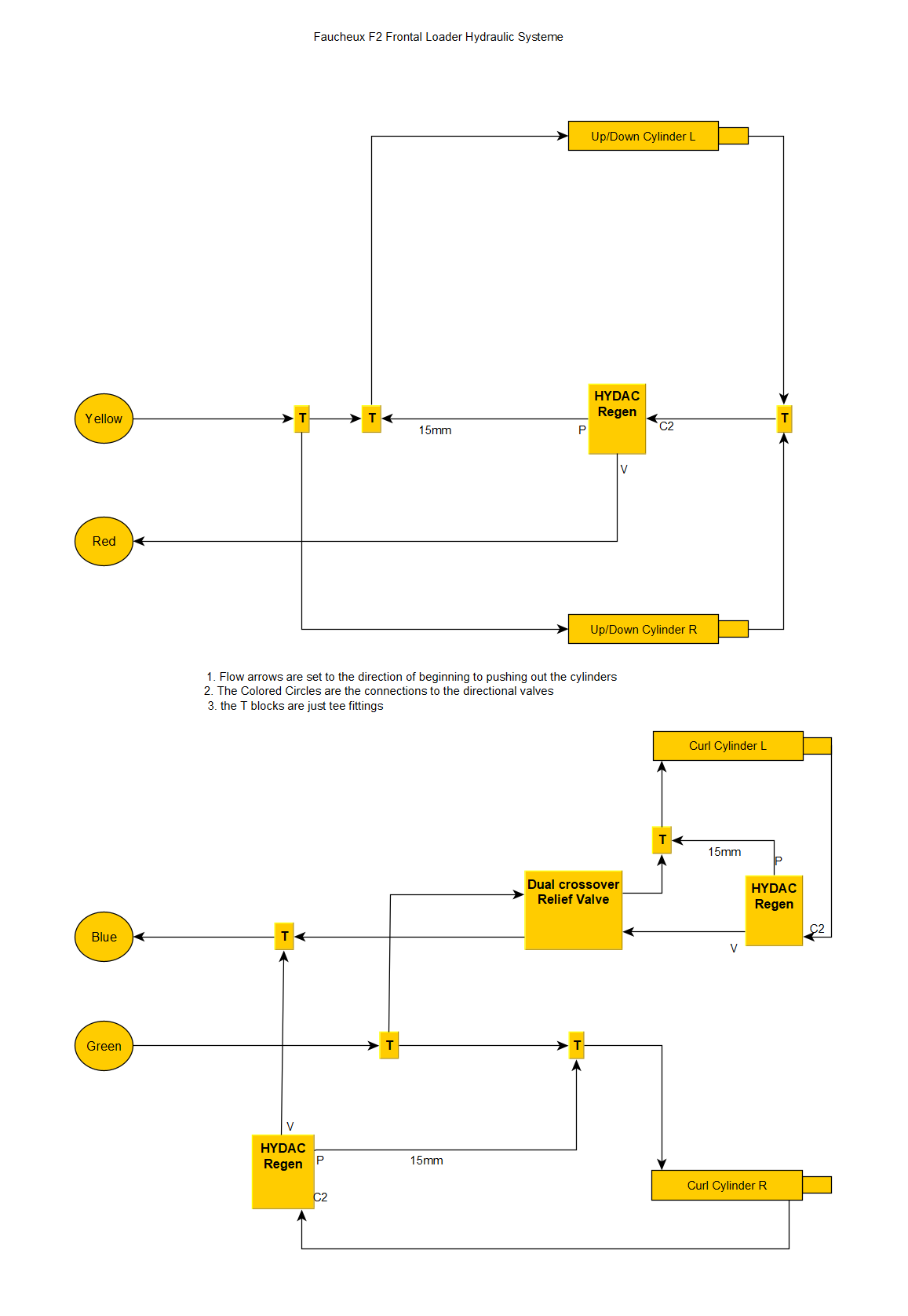

I bought a front loader (used) for my Zetor 7245. I am trying to understand how it functions as the system is not straightforward. There are four valves, three of one type and a fourth that's different, that I would like to understand what they are for. I drew a (crude) schematics based on observation (the direction of the lines is my guess, and of course they reverse).
If someone can tell me what are the valves in the system and what they do, I'd greatly appreciate.

Not enough info. What tractor did the loader come from? Is the loader also off of an open center type of hydraulic system?
Does T mean "Tee"?
Where are the valves? I assume they are feeding the colored inputs? But that would only require two. How are the other valves connected?
Do you know what the Hydacs do? Do they have any markings? It's impossible for me to be sure what they are... could be relief valves, flow control or accumulators....or ? Do they have a pneumatic fitting?
/ understanding my front loader hydraulics
1. I don't know what tractor it comes from but the tractor connection is designed for Zetor. So I assume it was a zetor, and by the size of it, something around 70-80hp.
2. T indeed means Tee. These are just fittings. I marked them so I have an easy time looking at the system with the diagram but functionally they aren't necessary.
3. all the valves are attached at different places on the inside of the loader, along the arms and the connecting bar.
4. I don't know what the HYDACs do. The port letters are marked and noted on the schematics. They have no pneumatic fittings but there's an unused small port marked M. They look like relief valves but I'm trying to understand the logic of how they are connected.

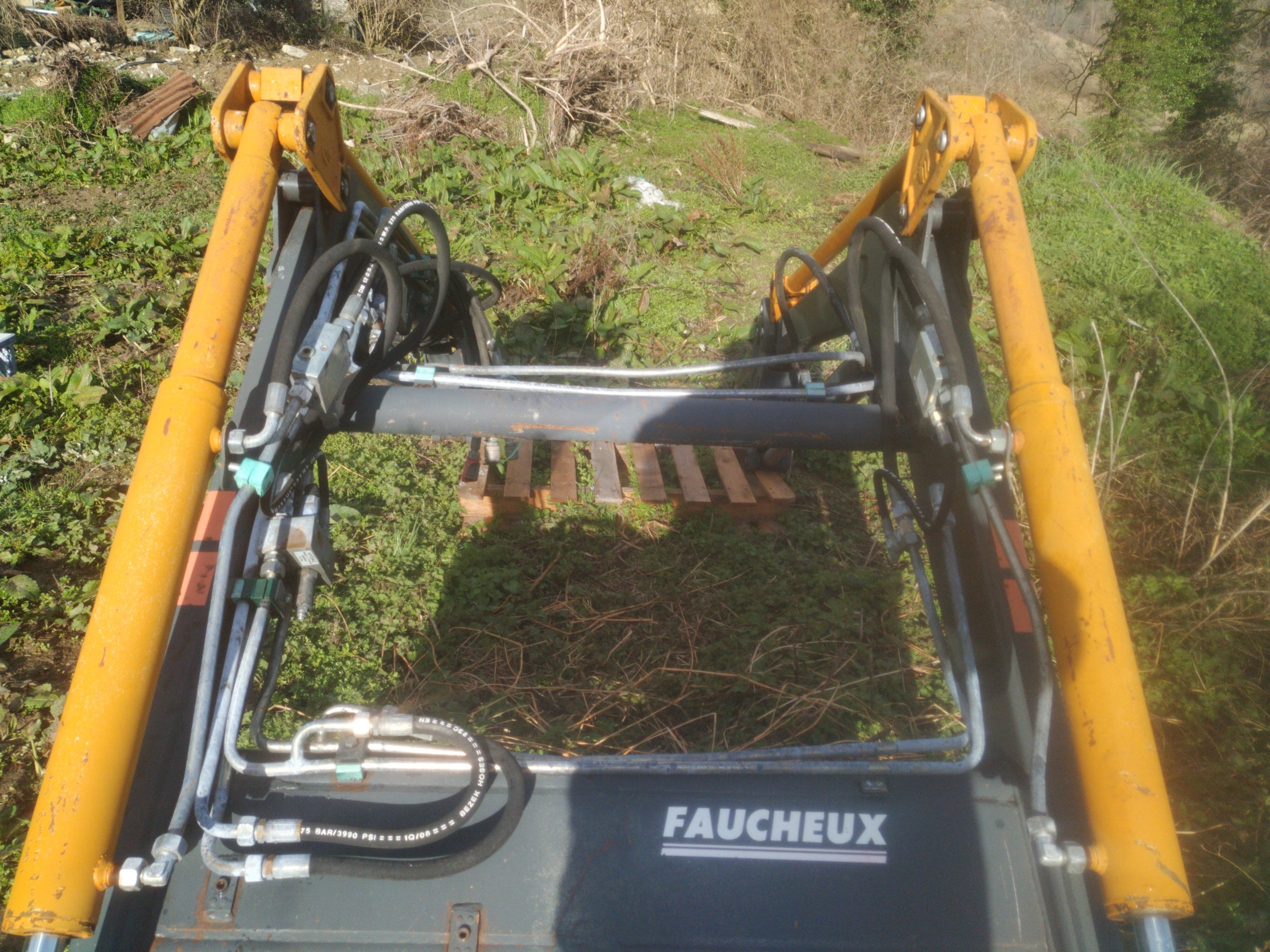

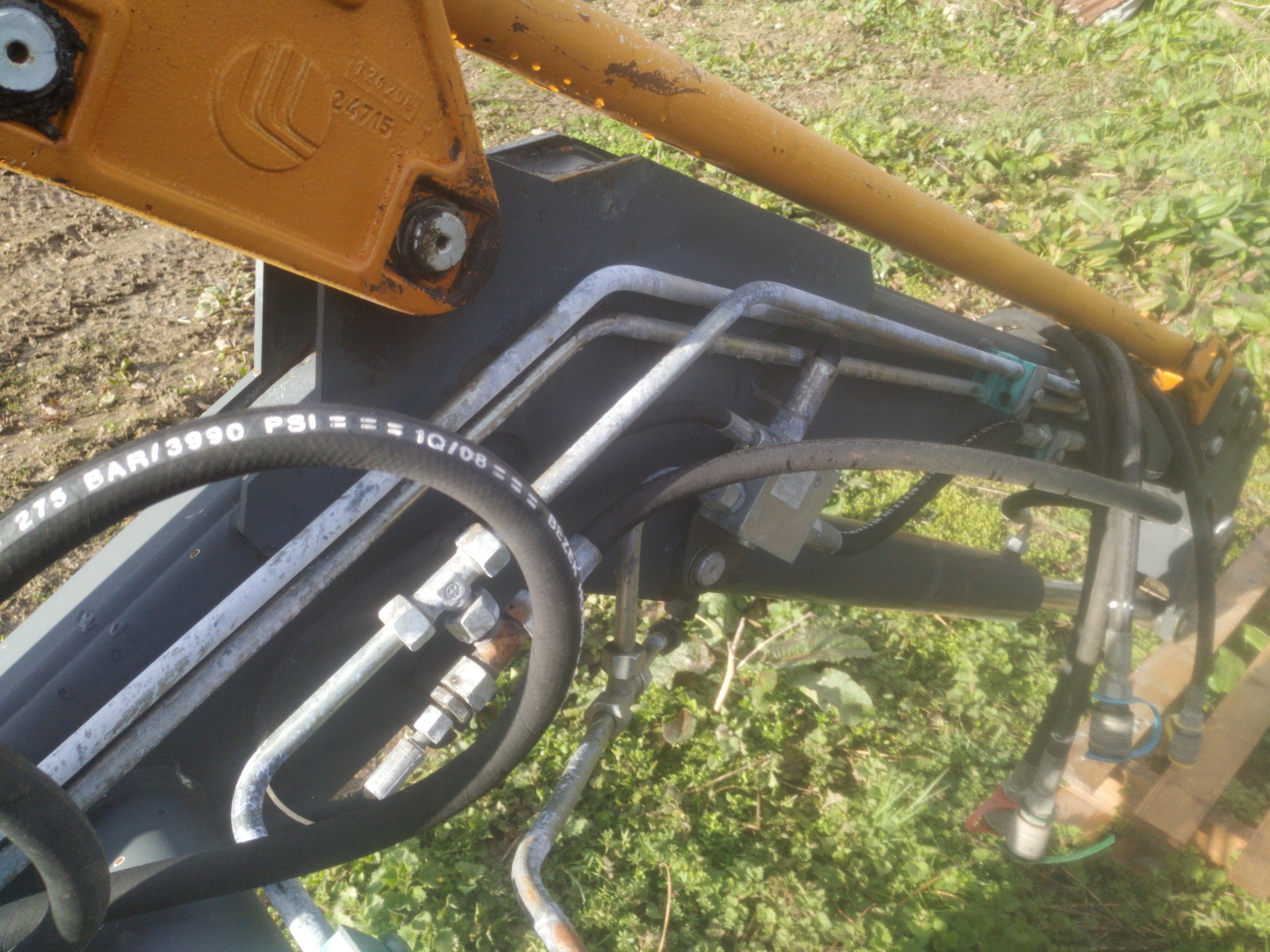

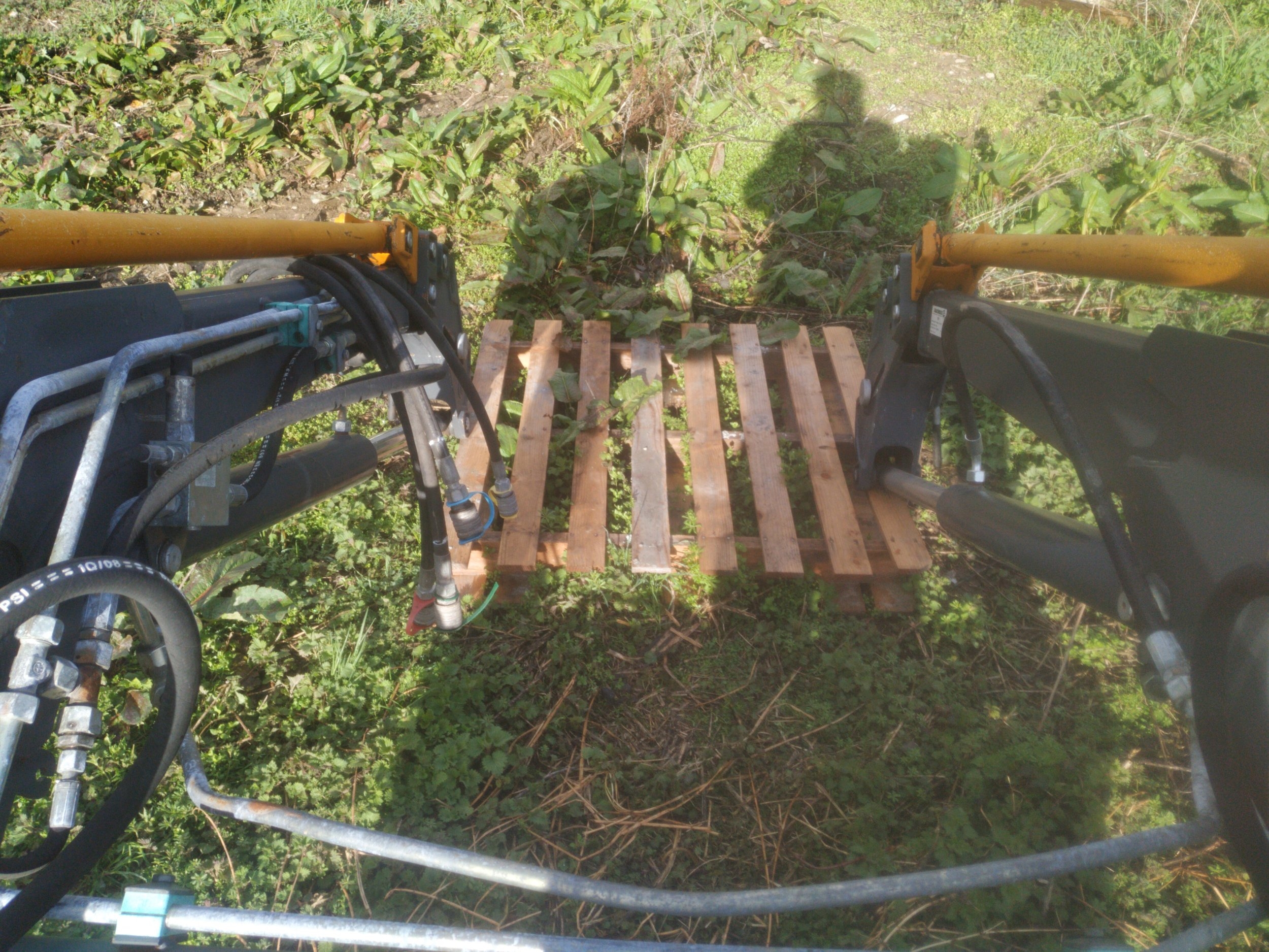

thanks for all of you responding. here's some photos. you can see the three HYDAC units with three connections as well as the single other valve with four connections.

In photos #2 and #3 I have seen similar looking valves on diggers. Thier job is to prevent the digger boom free falling if a hydraulic hose has a blowout. Possibly these do the same job. ?
Can any hydraulics people comment?

The two valves mounted on the curl cylinders look like regen valves to me, to prevent the floppy bucket when fully dumping a load.
The other one may be the relief valve because of the self leveling linkage.

Thank you, ptsg! the regen function makes sense to me, but why would there be a relief valve on a single cylinder? Could you explain what you mean by self-leveling?

Self leveling, in that loader in particular, is that parallel linkage on top of the main arms. As you lift the loader, it will maintain the bucket at the same position from the ground all the way to the top. Same as you lower.
It's called "self leveling" but the name is somewhat misleading. It doesn't actually keep the bucket level all the times, it just keeps the bucket in the same position along the range of motion of the loader. Let's say you have the bucket curled all the way, as you lift the loader, it will keep that bucket in the same position.
This is also a great safety feature as it won't let you dump the load on top of the hood of the tractor. Lots of people got killed or injured that way with logs and hay bales.
The self leveling feature also reduces the need to do two functions at the same time by a lot. Without this feature, some tractors are very hard to do two functions at the same time due to either the control valve used or just not enough flow from the pump.
The relief valve has to be there because there certain positions that something has to give in order to prevent something from break and bend. So the relief valve just relieves the fluid.
Let's say you have the loader 1 meter in the air and you have the bucket dumped all the way to the stops. If you tried to lift the loader, the parallel linkage would try to push the cylinder further forward but since the bucket is already hitting the stops, it can't move. So the loader couldn't lift or it would damage something.
With this relief valve, it relieves the fluid from the extension port of the dump cylinders, so the loader can go back up. This relieved fluid is often sent to the retract side of the lift cylinders and then dumped back to the tank.
EDIT: The pressure on this relief valve is set lower than system pressure, so it can actually work as designed.
Hopefully my explanation makes sense. If not, let me know and maybe I can find some better wording.

Your explanation is great! I understand the linkage type, in France it's called parallelogram, I didn't know it's called "self-leveling". What I still do not understand is why there's a relief valve only on the left side.
EDIT: Correct me if I'm wrong. Since the two sides are set in parallel, when the relief is triggered on the left side it also drops the pressure on the right side?

for the benefits of posterity. I attach a revised schematics based on the thread

In Portuguese it's called parallelogram as well. I guess in the US is more known as self leveling.
Since the cylinder are connected in parallel, it only needs one relief valve. What I'm not following entirely is why they use what I assume two Regen valves.
