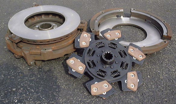

OK not much to report, the wife has had me doing other things that have cut into my Unimog time. /forums/images/graemlins/frown.gif I have been spending some money on it though. Just got the clutch back after having it refaced and a new lining put on the disc. Only cost $250.00. Sure beats buying new parts at $975.00. Attached is a photo.

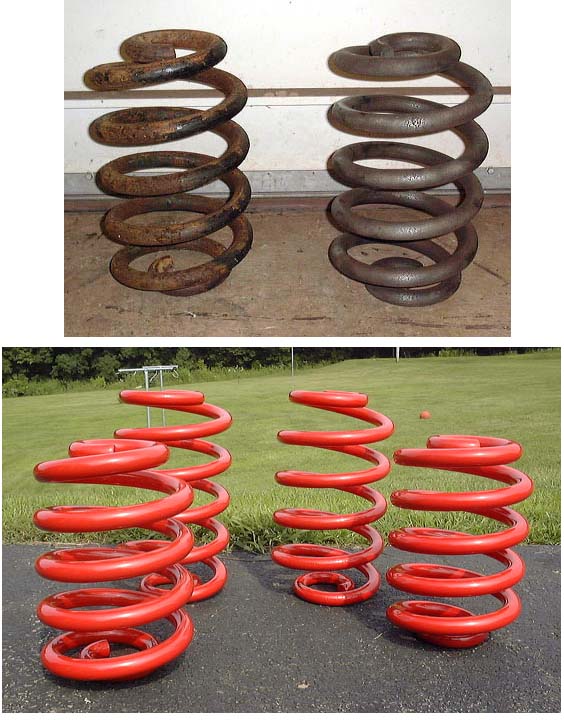

Here is a photo of the springs both before and after. The top left is before using the electronic rust removal on them, the top right is after. And of course the bottom is after the powdercoating. The shorter springs are the front ones.
I'm still waiting for my rear axle parts to show up so I can get that all back together. Hope to drive it by this fall, so I'll have to start working on it soon! /forums/images/graemlins/ooo.gif

Great job Von, those springs look fantastic. Does the electronic rust removal affect the metallurgy of the base metal at all?
Keep the progress and pictures coming /forums/images/graemlins/smile.gif

Does the electronic rust removal affect the metallurgy of the base metal at all? <font color="blue"> </font>
No, not at all. Thats the great thing about it, it seams to only attack the rust. I have done parts that have a clean machined surface and they come out just as they started. There is no real heat build up when doing this. Yes the water gets warm, but not that hot! It just takes some time to do it, thats the only drawback that I have noticed. Plus you can only do parts as big as your tubs. I have seen photos of a guy who did a whole trailer frame. He had to make a large tank out of plastic and had the anodes suspended all around and thru the frame. Took 36 hrs. to remove all the rust. I think you can find it in the link on rust removal in one of the earlier post I did.
