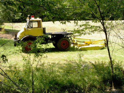

I took a picture this morning & thought you might like it. It was parked in a field about 4 miles from my house.

Hey, I am thinking of buying some muck-land soon and I think I could really use that!!!
Peter

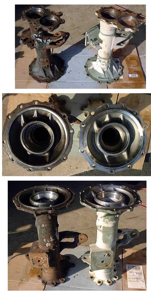

Just a few updates on the Unimog project. Here is a photo if the rear axle housings. The green camo one is the replacement one. You can see that its not all chewed up in the middle photo! Only thing is that its from a later year truck and they made some changes. I had to take it to a machine shop to have the bearing seats cut to match the old housing. Cost is to be $75.00 max, so thats not too bad. Beats chasing down a new axle and bearing and then wondering if it will be different in the reduction housing as well! /forums/images/graemlins/shocked.gif Plus the supplier of the used housing said he will be giving me a deal on some other parts to make up for the extra $$$ I need to spend on the machine work. /forums/images/graemlins/smile.gif So it all works out in the end! /forums/images/graemlins/cool.gif

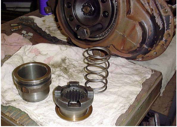

Here is a photo of the air locker "dog", piston an spring that came with the new housing. All of these parts were missing from my axle! /forums/images/graemlins/shocked.gif I guess this is what caused the housing to be all chewed up! Will now be able to use the truck to its fullest! /forums/images/graemlins/grin.gif

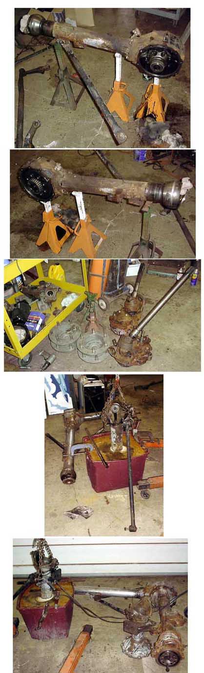

OK its been awaile since my last update. I have been spending way too much time bow hunting and not enough time working on the Mog! /forums/images/graemlins/frown.gif I have to hurry up as the cab is on a boat now and will be here by the end of the month! /forums/images/graemlins/smile.gif So I have been busy getting everything ready to have a rolling chassis before the cab arrives! So the first photo is of the front axle as it comes apart.
