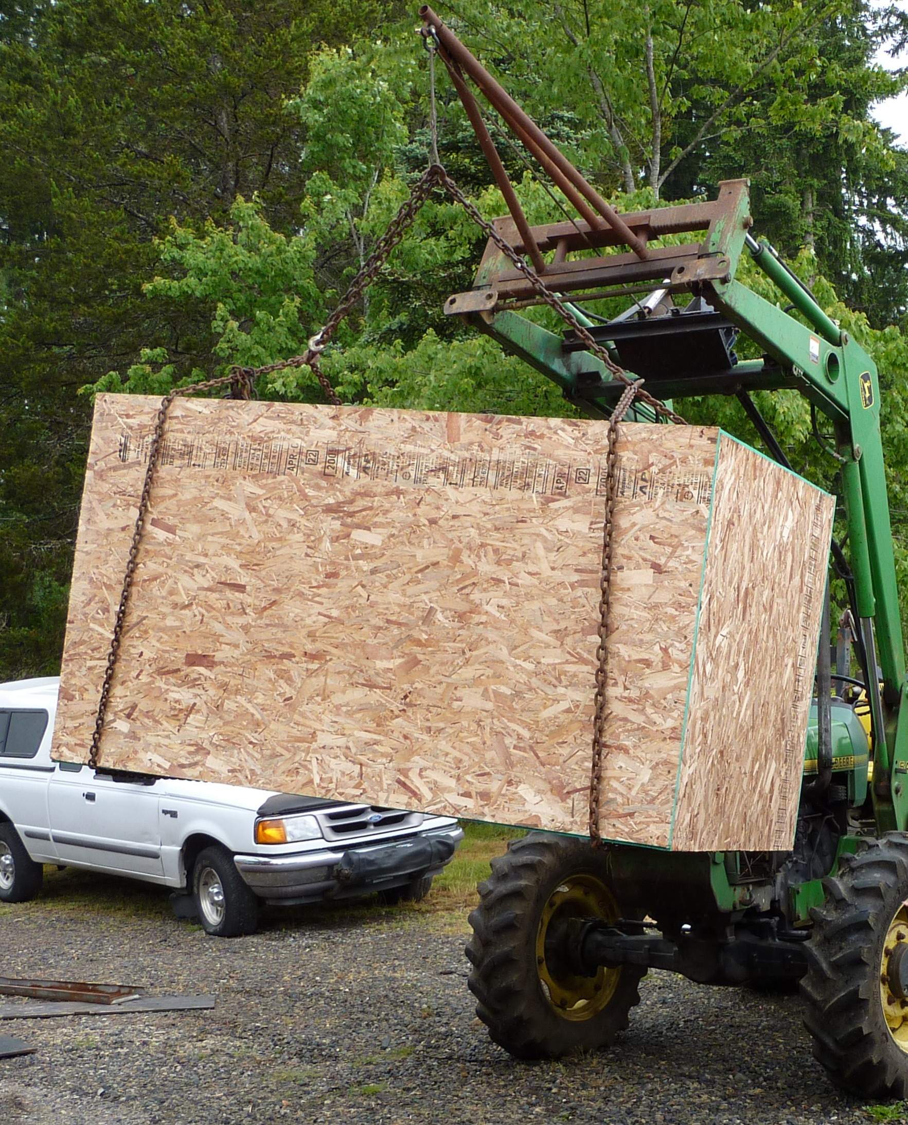

That is an interesting design. I made one recently for my bucket using a trailer receiver and I used square steel a bit lighter than 1/4 inch. I don't know yet how much I can lift with that.

Nice boom on the link, I think I would have used round tube instead of the box on edge for the boom(same strength, less weight), but overall a good cantelever and triangulation layout...

I'm not saying the OP's subject post did anything wrong, but the square tube will see ~30% more stress if set on a 45ー angle. The post quoted above pictures a tube mounted to perform better and will lift with a lower stress, given the same loading.
At a previous job of mine, they used to build feeders. The cutting board to fill the bin, was suspended on two tubes mounted on a 45 degree angle, which telescoped into each other.
They said the tube was stronger when used this way... I actually doubt BOTH claims, but cannot find any data in my engineering almanak to back this up.
   / Unique boom pole design #8
Nope. I don't believe it would be stronger at the 45* angle. Any loading would be a point load causing concentration and a crushing force on the top of the wall edges at the apex. Keeping it 'square' causes the load to be distributed on the vertical side walls. Puts the top of them in compression, the bottom in tension. The top of the side walls is stabilized and strengthened by the the top of the box. So too with the bottom of the side walls being strengthened by the bottom. Similar to the concept of I-beam. The top and bottom flanges are what stabilizes and strengthens the center web.

Since there is a top-mounted tension bar, it doesn't much matter whether the tube is assembled at a 45 or not. What it does do, however is provide a well presented surface for the two stabilizer rod weldments. I say a big thumbs up on this clean design.

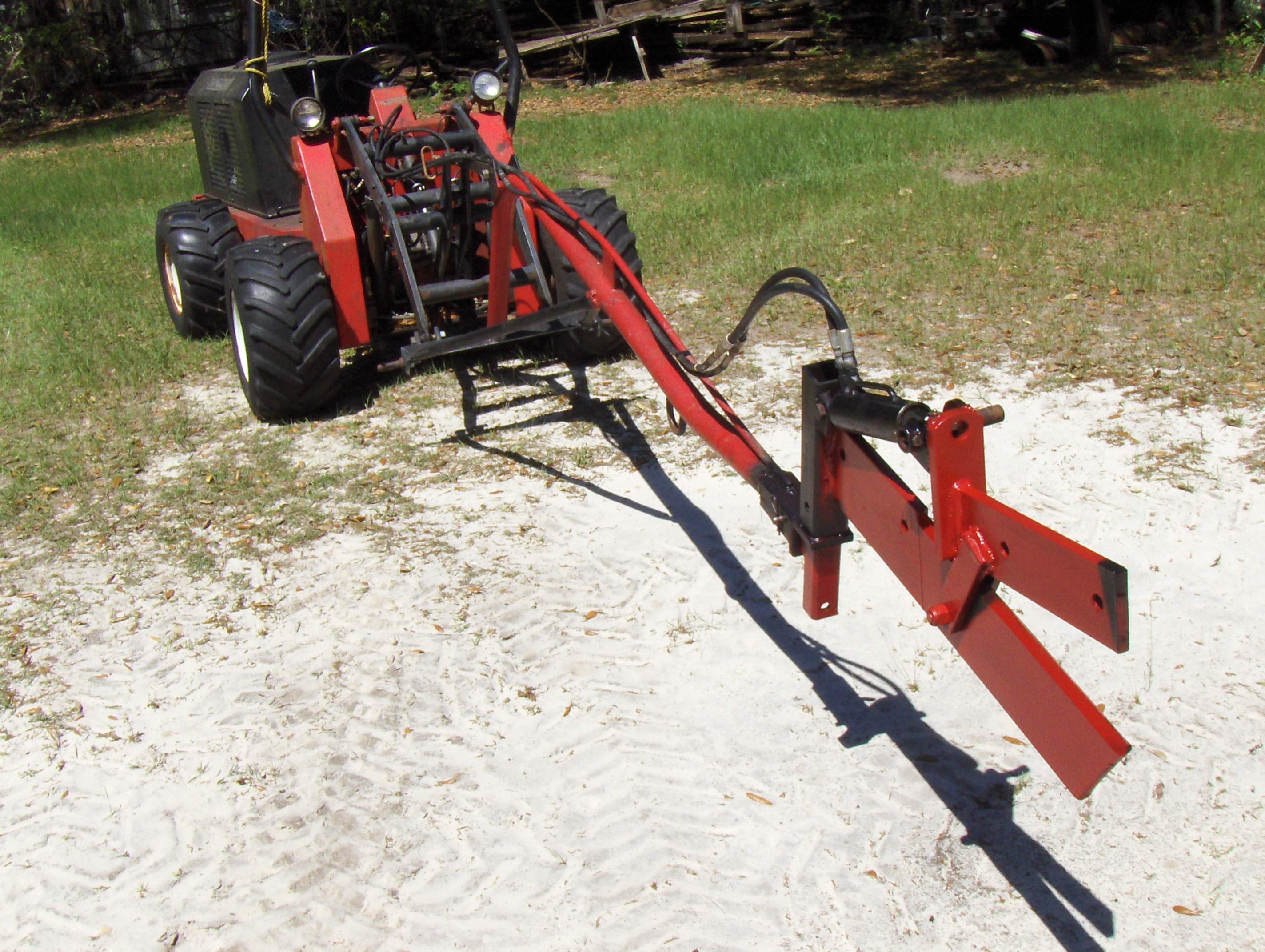

Here is a picture of a boom pole that I modified to work on my Power-Trac. It can still work on the 3 pt. It also has square hitch tube welded on the end for using different plug in', or extensions.

Good reply to Peej, Scotty. I also like Jenkinsph suggestion of doubling up around the hole. To be clear, however, the square tube at a 45* is strong and can support quite a load. It's failure is just at a lower load than if that same tube were square with the world. As long as it's not taxed beyond it's capacity, it should work fine. Of coarse, that's why I'm always repairing my stuff....
