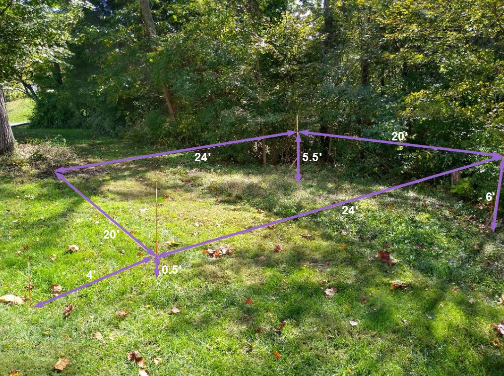

Appreciate s219 taking the time to post those photos and all of these suggestions it gives me a lot to think about. Unfortunately my site is steep with a 25% grade. Attached is a photo I took with some dimensions.
Tomorrow will talk to a couple of other contractors about this - one is a concrete guy that wanted to do a "monolithic slab" which as I remember, was where walls and slab were poured at the same time. I'm sure that won't be cheap and is likely overkill but would like to get the cost of that too.

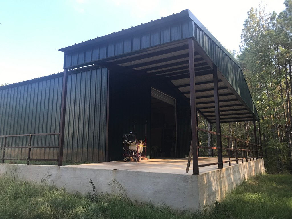

Your situation is ideal for a monolithic slab. I have one that was poured at the end of my barn where one corner is 6' above finished grade. The slab portion is 15' wide and 75' long. One end is 3' above grade, the other 6' above grade. The way it was formed is that the exterior form work was put up and filled and compacted on the inside. Then the walls were dug out along the form boards. Rebar put in and then concrete poured so there are no joints and since I'd planned a steel roof, weld plates were embedded in the concrete before it set up.
The far corner is 6' above grade.

Must be great to off load the pickup having your own private loading dock...

That is a heavy duty barn! Thanks for the photo, yes that's exactly what the contractor was proposing a couple of years ago when I had some other slabs poured. Should have had it done back then I am certain the cost will be up 50% today. Your lot is less steep (mine goes from 0' to 6' over 24') but seems like the principal would be the same.

Yes I went out to the site again this morning and that's my conclusion too. So now it's off to get some quotes on the monolithic slab like "3ts" showed in his photo. Hopefully I can find someone to do this whole project, concrete + barn/garage construction.
