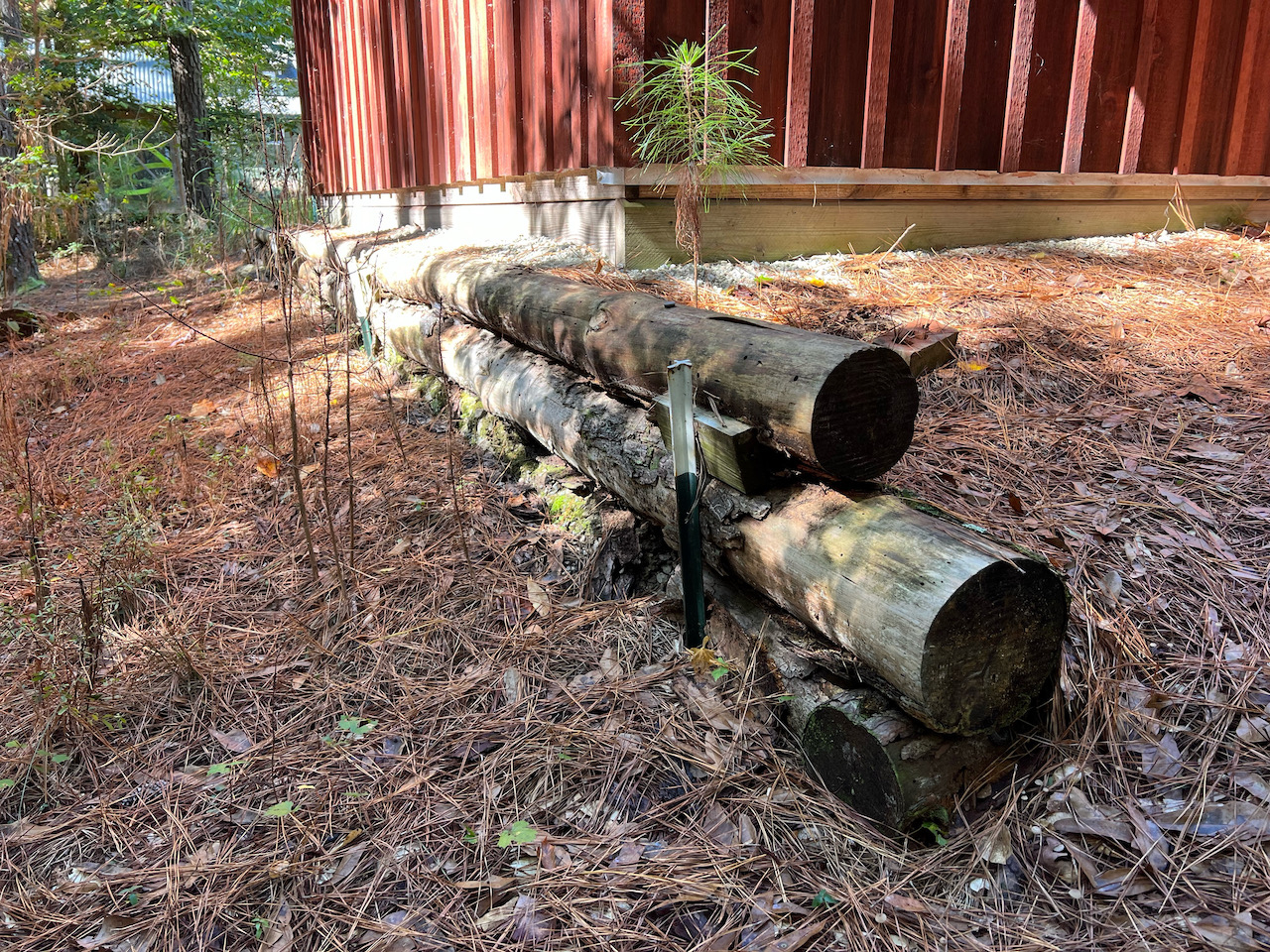

Here are a couple photos from additions I have added onto my pole barn over the years. This older addition had about a 3' drop to the rear, which I handled with an extra skirt board (marine lumber, will outlast me) and a crude log retaining wall:
At the time I made a mental plan to come back and make a nicer retaining wall or just dump gravel there and slope it, but that was about 5 years ago and the clock is still ticking on my plans. Surprisingly, the logs are still solid too, but that won't last forever. I'd probably use marine lumber for the permanant retaining wall (they make a tongue and groove material for bulkheads that is real nice). But the prices will need to drop/stabilize before I spend that kind of money.

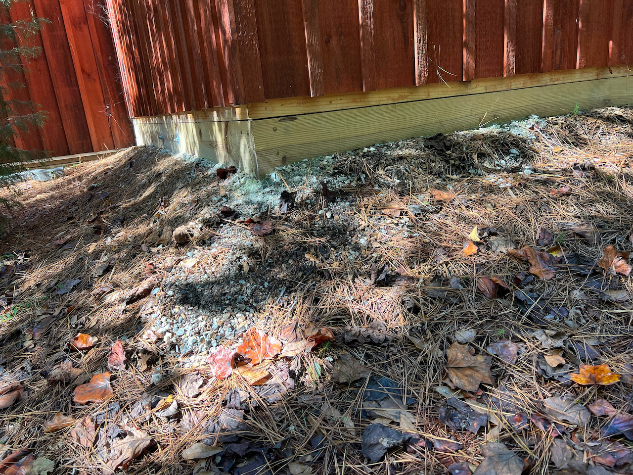

Here's another addition where I used an extra skirt (ground contact 2x10) and then let #57 gravel spill out from under the skirt boards until I had a nice sloped berm. The berm was topped with crusher run and then wood chips, and has held up well. That was probably about a 4' drop at the low corner (closest to the camera).
I put a dead-main in the middle of the rear skirt extension (you can see the bolts and plates), just in case any pressure was put there by the gravel. So far the skirt has not budged after a few years of parking cars in there, so either it wasn't a problem or the dead-man is doing it's job. If you have sufficient posts that can handle the retaining load, then a dead-main isn't needed. For instance, on the eave walls I have a lot of posts to support the header and roof load, and did not put dead mans there.

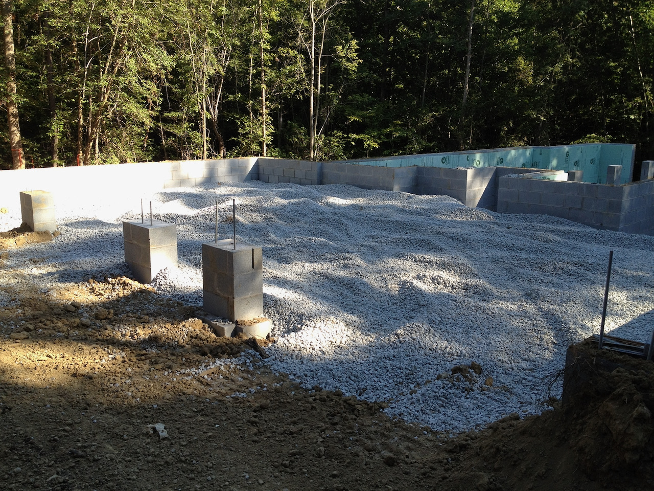

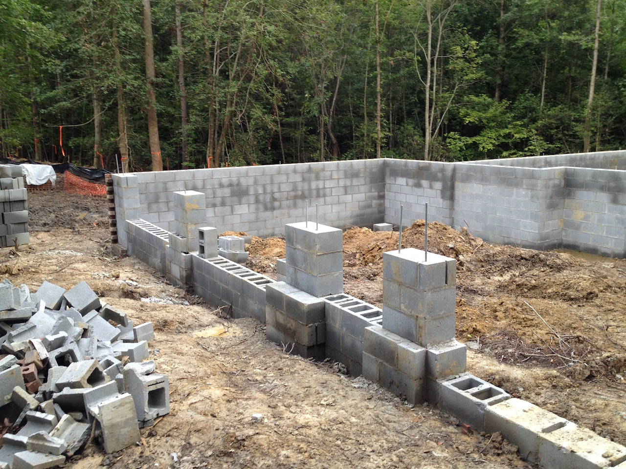

Found pictures of our garage foundation, first is before gravel fill, notice that far corner:
Now here it is after gravel:
Looks to be about 6 courses of block below the gravel in the far corner, so figure about 48" of fill there. All built to code and kosher.
Hope that helps!
