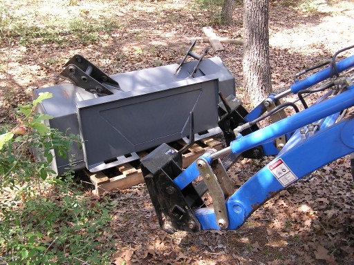

I recently bought a New Holland TC45 from the father-in-law I believe it is like a 2002. It has a 17LA loader with a direct pin-on set-up and I also have a fork set that I built for my old Ford 4000. Rather than try to re-ear the forkset to a direct pin-on I am thinking of buying a universal skidsteer mount and then removing the ears from my current bucket and installing the skidsteer blanks on the bucket and forks. I was a welder/fabricator in a construction attachment shop for like 6 yrs and I just have a hard time spending $400 on the coupler and $125 on the blanks per set any ideas? Is there any other places a guy can get this coupler or blanks or maybe I am just being to cheap.
/ Universal Skid-steer adaptor/mounts #2
You're being cheap:eek:
If you put a $$ value on your time, I'd bet you'd be hard pressed to do it for less money...
I'd buy the coupler & 2 plates. Save your $$ by installing them yourself vs. paying a shop to do it...
There are a couple threads in the NH forum with pix on similar installs (try the search feature).

maybe I am just being to cheap yep .... spend it .. you won't regret it .. git 'er done.

I built my own, it's very easy, I bought a 4 X 8 X 3/8 plate and had it sheared and it's fun, I have pictures in my gallery here
happy building
Jim
/ Universal Skid-steer adaptor/mounts #9
MrJimi I was thinking about doing that but was not sure if it would be cost effective. I can get one shippe for about 138.00 including shipping. Would the cost of buying the 4x8 sheet and then having it sheared be close to that or would it be a significant savings doing it yourself ?
/ Universal Skid-steer adaptor/mounts #10
Mine was the 3/8 plate and I think the cost was around $300 sheared and they gave me the drops and I have 5 backing plates and only 2 left for now but more attachments in the cooker
I think its worth it and I like making stuff, some pictures in my gallery may give you some ideas
