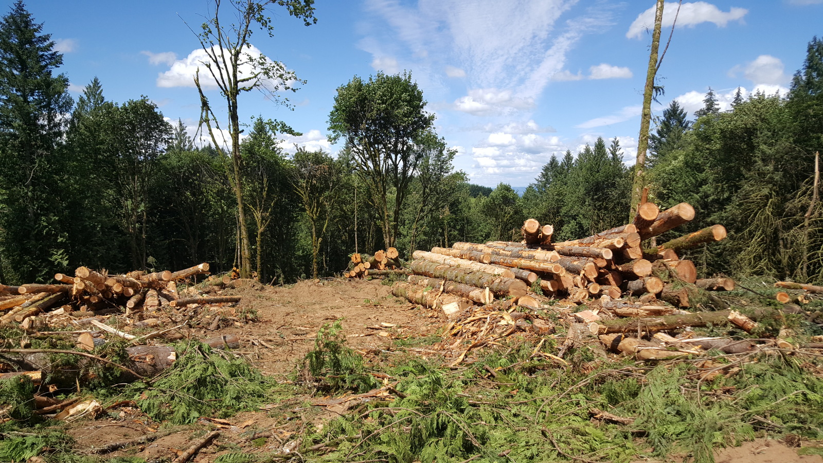

Yeah - the small truck would pull it fine in dry dirt even with street tires - although in some areas I had to use 4WD due to the slopes, it just won't get into some of the nooks and crannies that the tractor would have.
Yes, I have grass in those woods now. Gophers have made a mess of it after having smoothing out, but still more or less smooth.
I now have a bigger mess to cleanup on the back acreage:
15 slash piles to burn. Excavator ruts/etc. to smooth out. Hardwood and other logs to cut up. *sigh*
