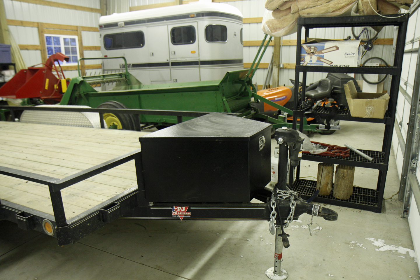

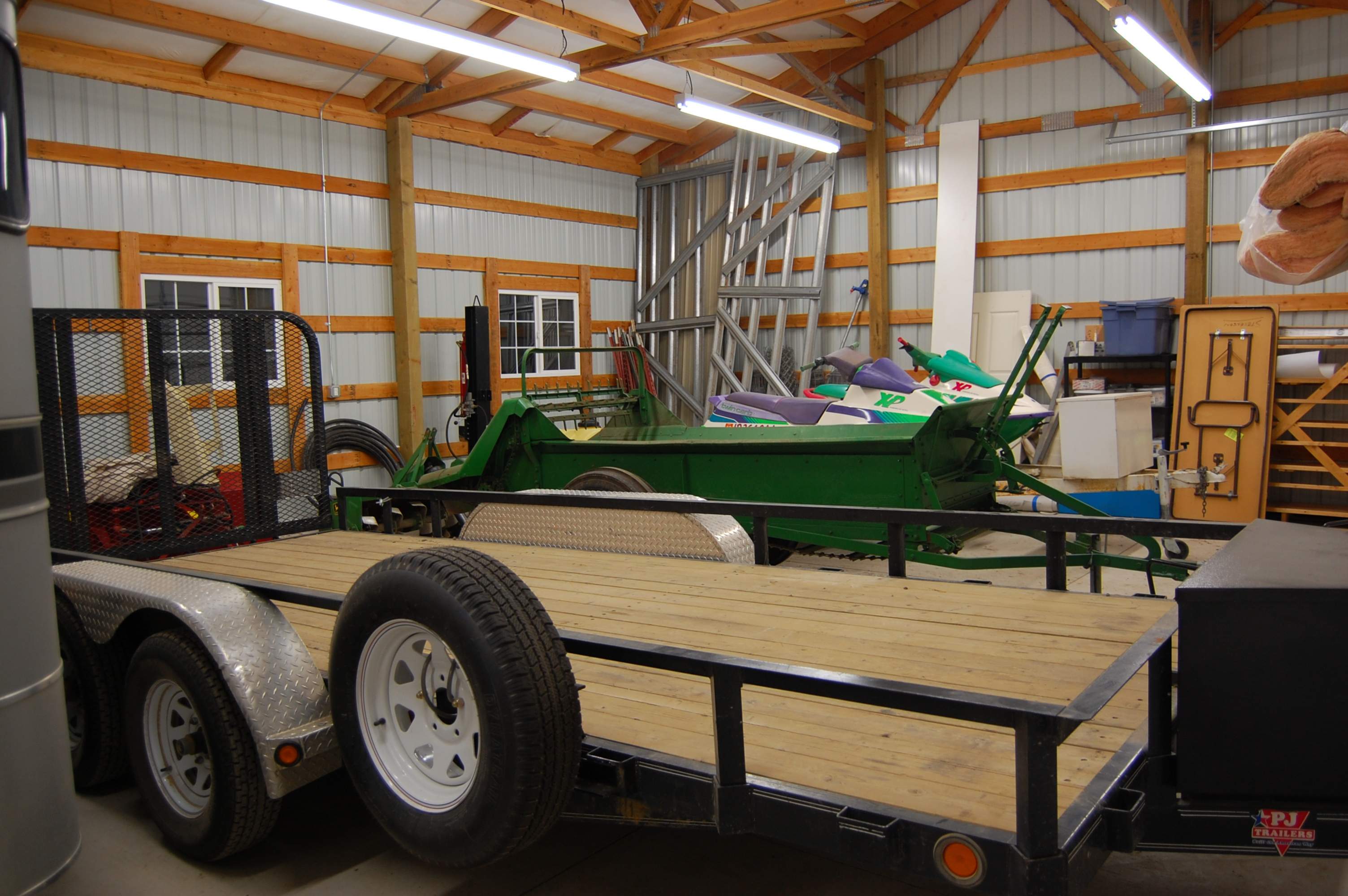

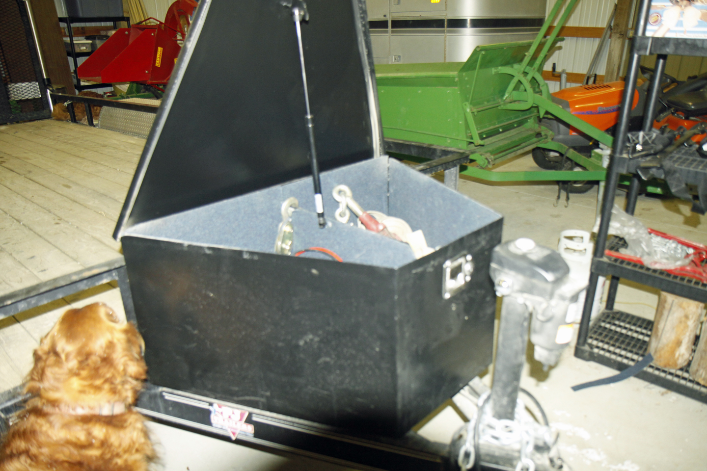

I had a JD870 that didn't look any larger than that tractor (but no cab) and my 7K trailer hauled it without issue. Mind you i had 3/8" steel chains with binders, alot heavier trailer overall. All clean welds and no sagging. Also a 1 ton truck to haul it with. If this trailer shown truly has no brakes, id like to see that rig towing it stop that trailer in an emergency.:mad:
I'm probably going to have to sell mine and get a nice gooseneck rig sooner or later, cause i KNOW this trailer wont handle my new tractor. Sad thing is i just recently completed the tongue box up front and rear swing loading jacks. I also just added the spare tire and electric front jack. Man, i hate it when i finally get around to completing a project only to have to sell it.
