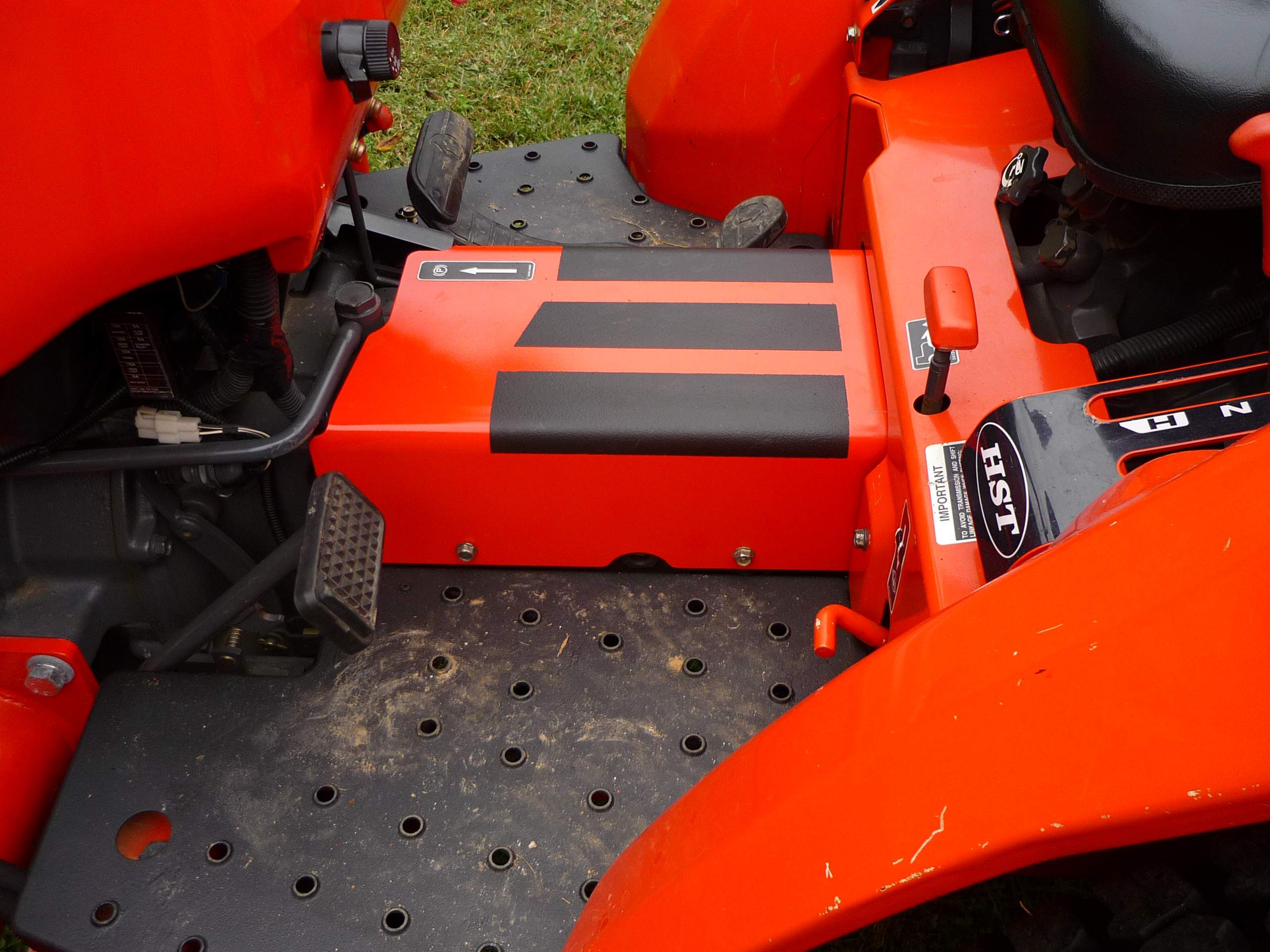

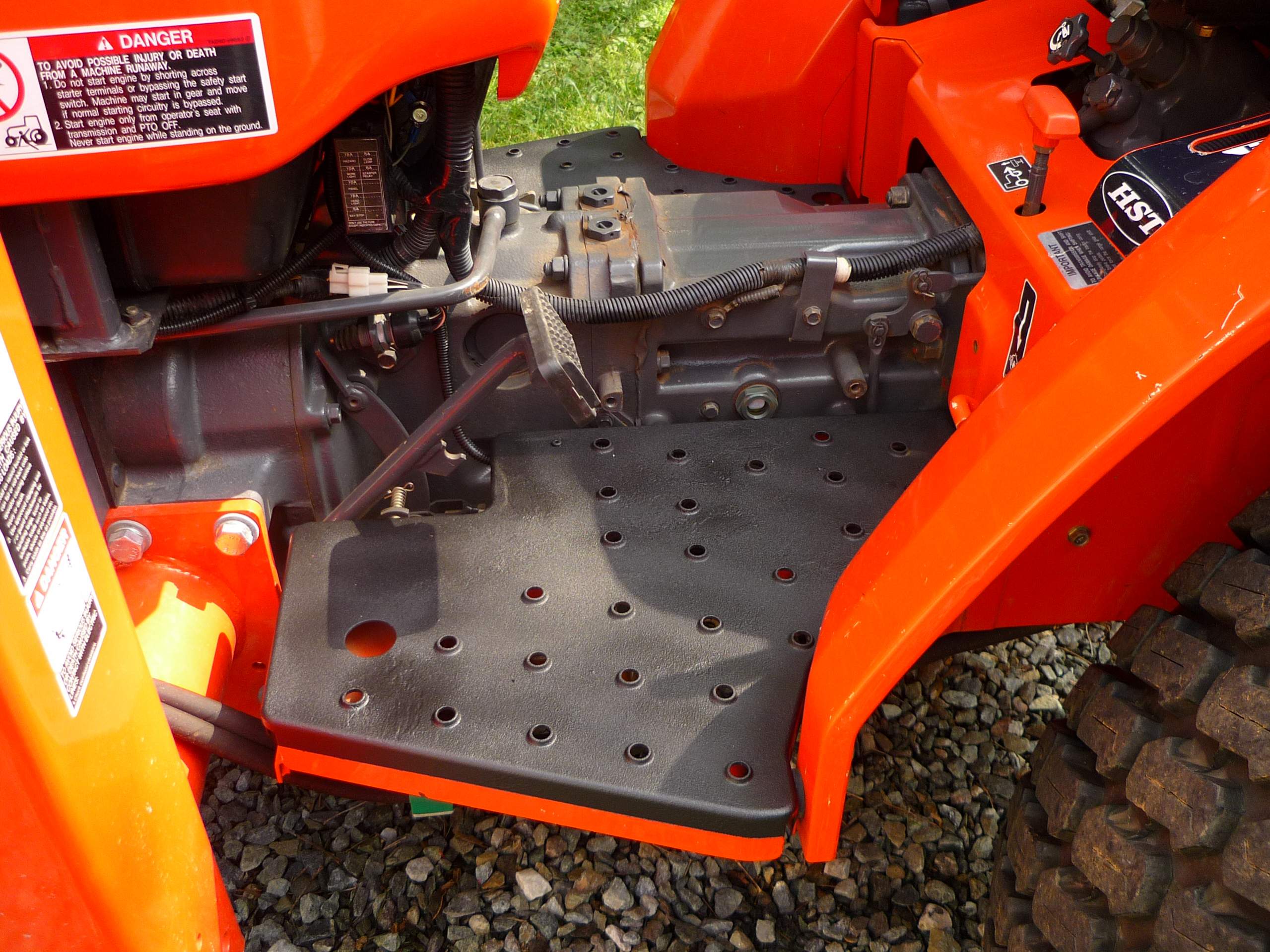

Last year, I posted that I had cleaned up my Kubota L3400's painted steel deck and step, which was okay but worn thru paint where your boots would be stepping or resting, and sprayed on bed liner coating. Its been on for about a year, I guess, and it held up fine! No wear to report, although I use my tractor less than 100 hours a year... I was concerned that the edges might wear, but so far, no problem. Not as nice as a Grand L's rubber mat, but hey, it's an improvement.

I forgot to add that I had applied multiple coats, over enough time to allow for drying properly, to the "wear" areas along the edges- basically where the orange paint had worn thru use. I had washed, scuffed and wiped with acetone before masking and spraying. Wasn't that hard to do, and the stuff covered really well. One can.

Mine held up well also for the time I had the L3400. It was also safer when you got on the machine in the wintertime with snow on your boots. One other thing I did just for looks was to spray a little flat black paint thru the large bolt access holes to to cover the orange paint around the bolt head so it would not shine thru. It only takes a few seconds, and give a more "even" look to the project. Notice from the old photos I did not do that at first, but I did paint them later and I thought it looked better.

I did get a little of the bedliner materiel on my fingers when I did the Kubota. And it did NOT come off with normal washing. It has been a while, but as I remember it just wore off over a period of days. I was very careful not to touch anything important.

It appears you masked it off and sprayed the deck in place. Did you have any problems with overspray going through the deck holes and getting on parts underneath?

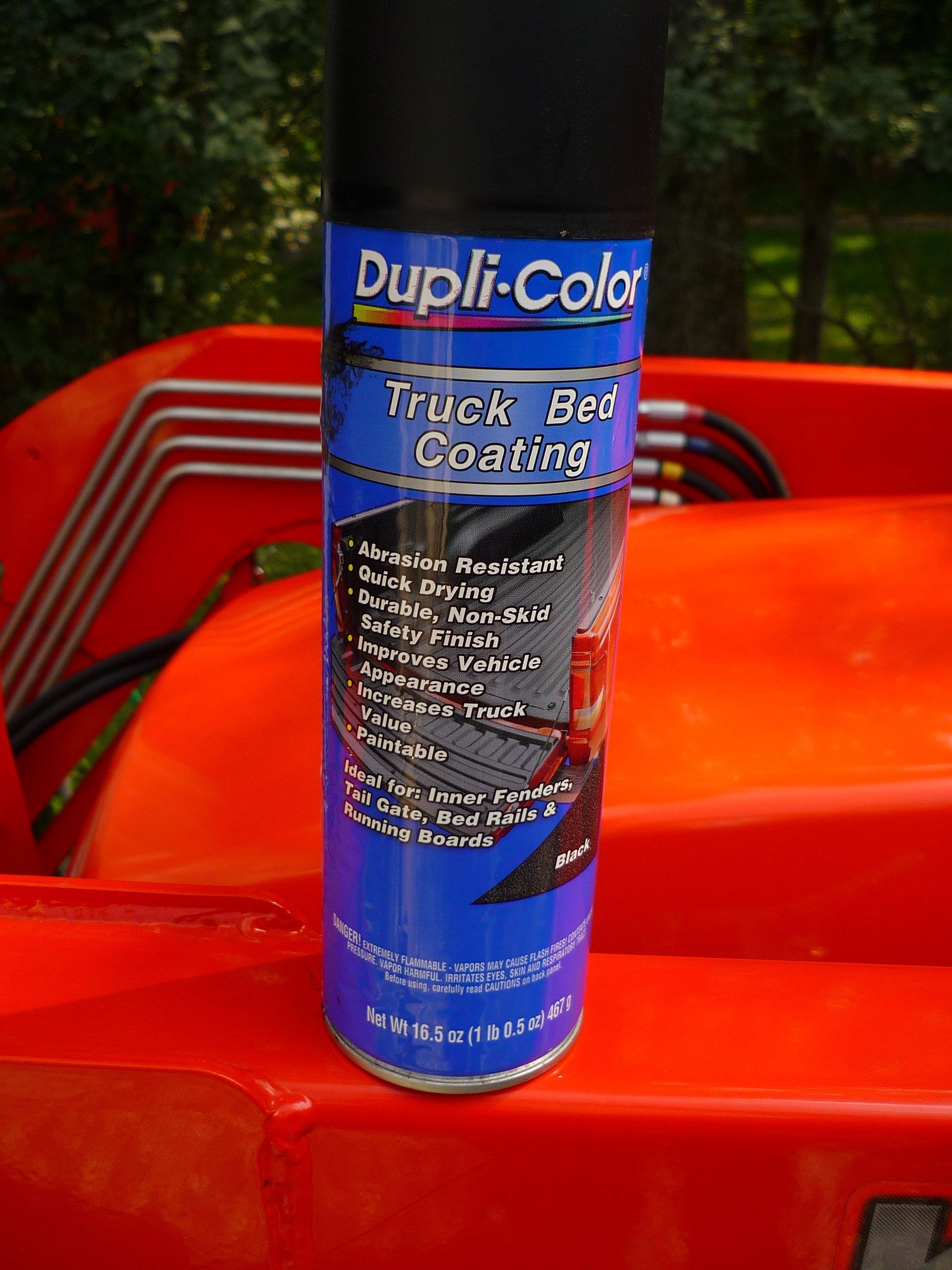

Answers: yup, I masked it off, and just stuffed some newspaper pieces on top of the hardware below the holes so it wouldn't get painted. The center cover was taken off, masked and sprayed. I used this stuff, from NAPA... and I would use it again, if a need arose.
