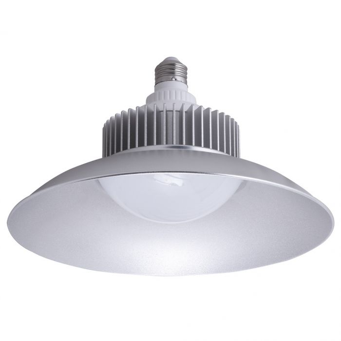

I am looking to get some better lighting for our barn with 16-foot ceilings. I want to move away from 4-foot lights and make everything simple. Seems to me that these "deformable" LED lights are going to fit the bill but I wanted to get everyone else advice before I pulled the trigger.
Looking at a bunch of #3 lights from this video.
From the results, shown better on the website, those seem to be the best color temperature and the best performing.
The Ultimate Garage LED Light Testing Showdown | Wrenches & Rides
What do you TBN'ers think?

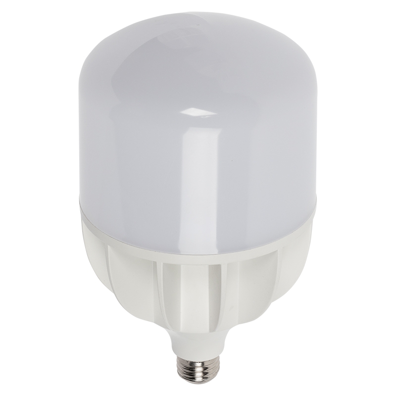

I used these from SuperBrightLEDS.com
4W High Output LED Bulb - 5,2 Lumens - E26/E27 Commercial & Residential Retrofit Light - 15W Metal Halide Equivalent - 4K | Super Bright LEDs

I would like more light output than what 4 or 8 foot LEDs offer. I would also like to be able to "change a bulb" and store extras easier. I don't see a need for long fixtures anymore. I think these deformable LED also give me the option to put the light where I need it (off to the side or straight down).

Same boat, and like the idea of the lights with the wings. That link shows a video on the Oneforu light... But it's currently unavailable. Makes me wonder if they had a run on them. Get this winter out of the way I'm buying something for sure

Our garage had two incandescent bulbs in ceramic bases, and it was always dark in there. I bought two of these 5000 lumen units that screw right into the sockets instead of a bulb:
Lumen LED Utility Light with Aluminum Shroud
Let me tell you, they are insanely bright and light up the two-bay garage (14' ceilings) like the sun (I probably could have got by with the lesser 3000 lumen units).
Had I known how easy it would have been to get bright LEDs, I would have just installed ceramic bases in my barn and used these types of units. It would have been much easier than mounting the 4' fixtures, and cheaper too.
