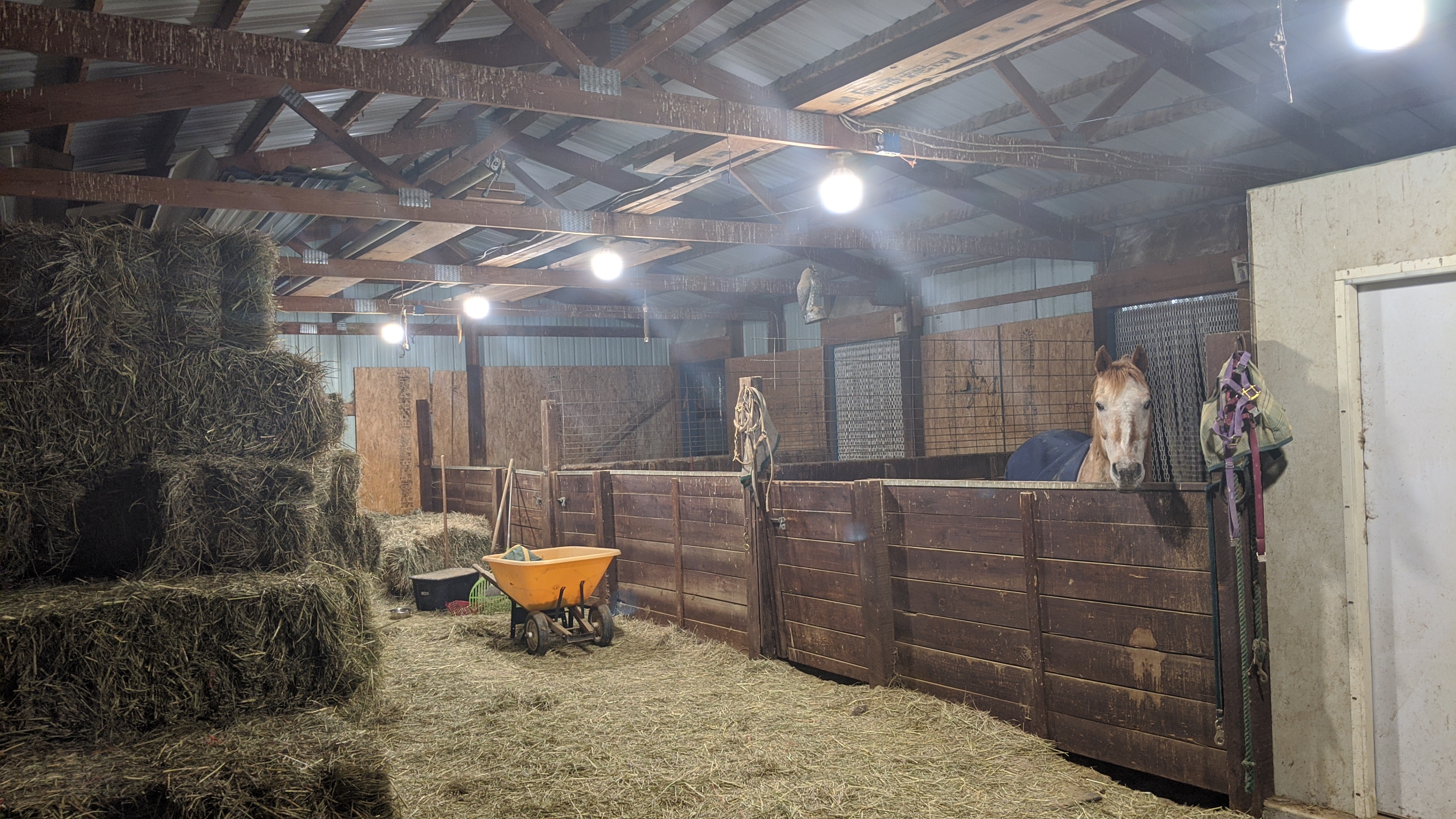

Updating the Lights in my Barn... LED the best?
