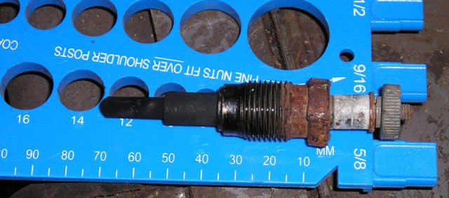

Thanks for the advice...here's a picture of the actual dead glow plug.
From what I can measure, it fits the metric thread of 1.5 and the housing fits closest into the 18 mm hole. As you can tell from the picture, it's about 70mm long with the exposed glowtube about 20 mm.
Does anybody know of online resources/catalogs that have exact dimensions of various plugs?

I don't know what an obscene amount of money is, but i bet you are going to come pretty close to it by the time you buy a different glow plug and then get someone to make up the reducer for you.
I would avoid stainless -- instead try to match the material of the threaded portion of the glow plug itself. You already had a cast iron head, and a steel plug, adding a third material is just asking for trouble IMHO.
When you assemble this be sure to use a good high-temperature anti-sieze. You want to guarantee you can get it apart easily in case something goes wrong.

I agree with CurlyDave as I've seen to many problems with galling when using stainless on threaded connections. I would also use the original glow-plugs if they are still available. When you think about it, even if the initial cost is high, they really don't go bad that often to warrant changing the style.

Stainless is VERY hard to machine.
Id stick with Brass or bronse reducers if you go that route
