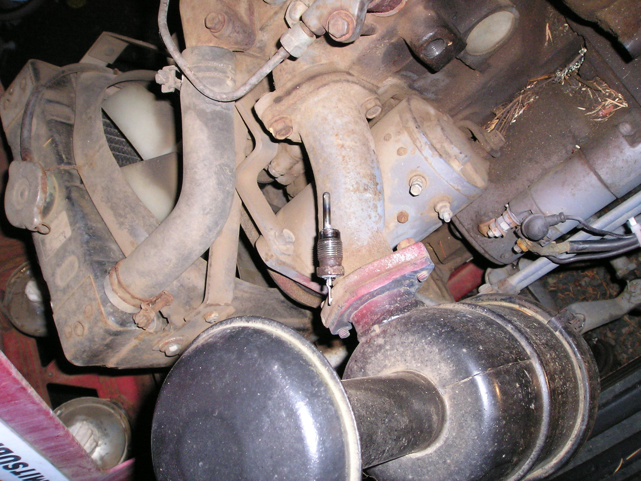

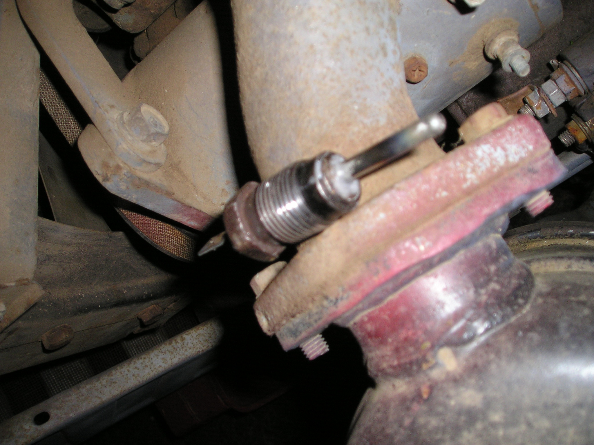

Soundguy said:
I think I'd ahve threaded it internally, vs epoxy. i think that is just waiting for a catastrophic heat failure under those temps and pressures..
Soundguy
But sometimes you gotta do what you gotta do. :D If/when it lets go...just another buck worth or JB Weld and it might be good for another few years.
/ Upgrading glow plugs #22
I'd always be worried that it's let go that time I was driving downt he 4-lane, or int he intersection.. or when using it in an emergency. At that point, a few hundred bucks worth of glow plug as OEM replacements would seem real cheap.
Soundguy
#23
Soundguy said:
I think he was using starting fluid on an engine with inoperable glow plugs.. if I read it right..
Soundguy
You are correct, sir. Although, I sometimes used to remove the glow plug and hold it above a propane torch for 2-3 minutes until it was glowing orange, and then quickly put it back in turn it over. Sometimes it worked, sometimes didn't. Even with gloves, though, I still ended up somehow burning my fingers.
/ Upgrading glow plugs #24
Soundguy
All valid points, but if it does blow out the motor will still run, so you can get through the intersection, off the road, etc. Ok you are not going to want to run it another 10 miles because it'll overheat. But drilling, taping threads isn't always as easy as sitting here in my chusy office chair and saying so. Spending 300-400 bucks is real easy...especially when it's someone elses. hehe :D
Plus in most all conditions, my tractor is easier to push than my atv's :) :D
/ Upgrading glow plugs #25
It's a widely known fact that spending other's money is what this board does best...
Soundguy
/ Upgrading glow plugs #27

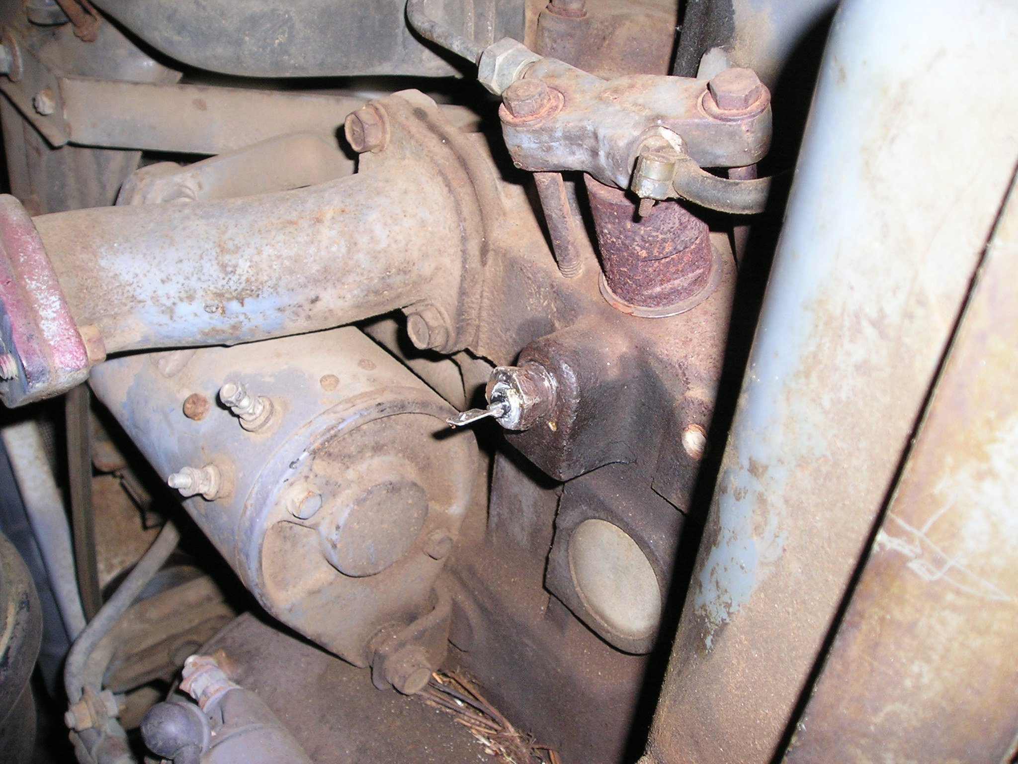

Just an observation. Did your glowplugs not work because your battery was dead? I noticed that in one of your pictures, there were no wires hooked to the generator. Do you have an alternator mounted somewhere that we don't see?

Hey, good observation. :) No, it's there, just nothing wired to it. The battery isn't dead as it gets put in a trickle charger every other start. Fixing the charging system is on my list of things to fix with this tractor. . When I got this tractor there were a lot of things that didn't work, and the wiring was big spagetti mess. so I pulled all the wires. My first method was of starting it was to 'arc' the terminals of the starter..(come'on...I know I'm not the only one that's ever done this).
FWIW, here's the current fix list by priority.
1. starter wiring --done-- if you look really close you'll see a 1/4" copper tube that goes between the solonoid to the starter.
2. glow plugs--current project.
3. Charging system.
4. Headlights and turn signals.
5. Tachometer/Hour meter
