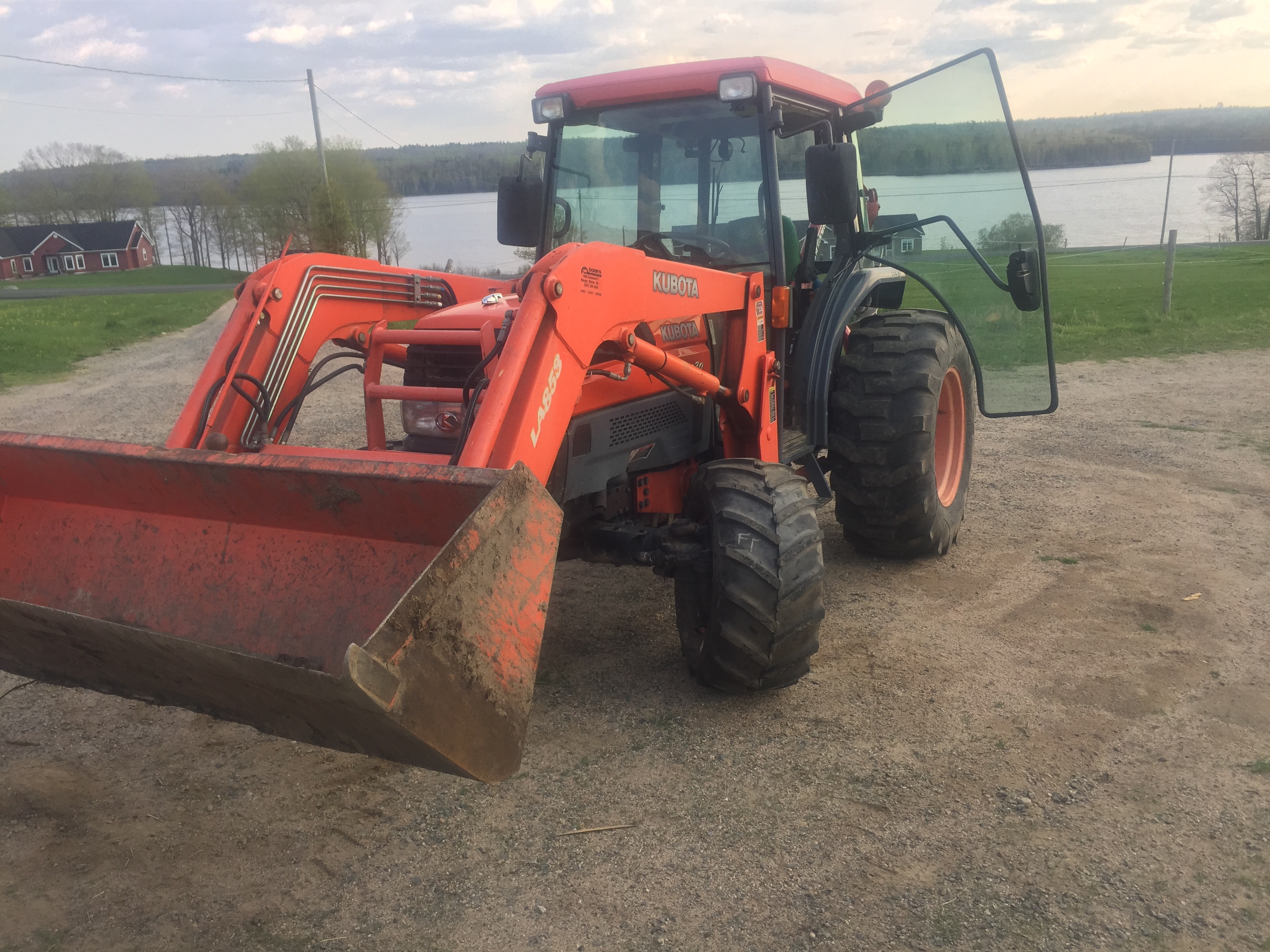

Tires Upsized front r4 tires on L5030
/ Upsized front r4 tires on L5030

EPIC FAIL! I upsized from the 10-16.5 to 12-16.5. Common sense should have prevailed but stupidity got the best of me but I guess :confused3: I was too busy wasting $$$ and time. Installed the 12’s put it in 4wd on loose dirt and absolutely not good! Just ordered the 10-16.5’s. Let me know if anyone needs a new set of 12’s :thumbdown:

Binds up badly?
/ Upsized front r4 tires on L5030 #33
So the OP did it to his L5030 and it worked fine for him, but your L5030 binds up "badly"?
Are your rear tires worn?
Are they the standard 17.5-24 size?
Are they loaded? (That would keep them from scrubbing as easily, making any bind much more noticeable...)
I did notice that 10 or 12 ply versions of 12-16.5's have a noticeably higher rolling circumference than the 6 and 8 ply tires...
What ply rating did you go with?
The OP also said that he mostly works in soft terrain, and runs fairly low pressure in the front tires... If his rear tires aren't loaded, they'll slip easier, and having low pressure on the fronts would reduce the rolling circ. If he's using 4wd with the loader, and turning a lot in doing so, excessive lead would also not be a problem, since the front tires must travel farther when turning.
BTW, unless it's very loose, a gravel drive or road can certainly be a hard surface when it comes to traction...
/ Upsized front r4 tires on L5030 #34
Are your rear tires worn? No
Are they the standard 17.5-24 size? Yes
Are they loaded? (That would keep them from scrubbing as easily, making any bind much more noticeable...) Not loaded
What ply rating did you go with? 10 ply 33.01”
BTW, unless it's very loose, a gravel drive or road can certainly be a hard surface when it comes to traction... I was on very loose millings test in 4wd.
/ Upsized front r4 tires on L5030 #35
20 ply??? For real? I hadn't seen tires higher than 14 ply, and for a CUT, 6 or 8 ply would be plenty...
The published height of the tire is not as important as the loaded rolling circumference. Ideally, you would want to choose a 12-16.5 with the lowest rolling circ if you were upsizing. I see Titan at 101', and Carlisle at 99.7. Doesn't sound like much, but that's a 1% difference, and when you're talking lead, everything counts. Even just running them so they have some sidewall flex probably provides another % or two...
It looks like making this switch for my tractor, and staying with 6ply titan Trac Loader tires would provide an 8% change in lead... Using a 6 ply Carlisle tire instead would provide a 7% lead change. Running the tires at lower pressure, I can probably get rid of another 1-2%, bringing me down to theoretical 5% change...
I played with the tractor again last night, and it appears that it is ever so slightly pushing the front tires in 4wd, they are not leading... I think even a 7-8% change would be OK for my tractor...

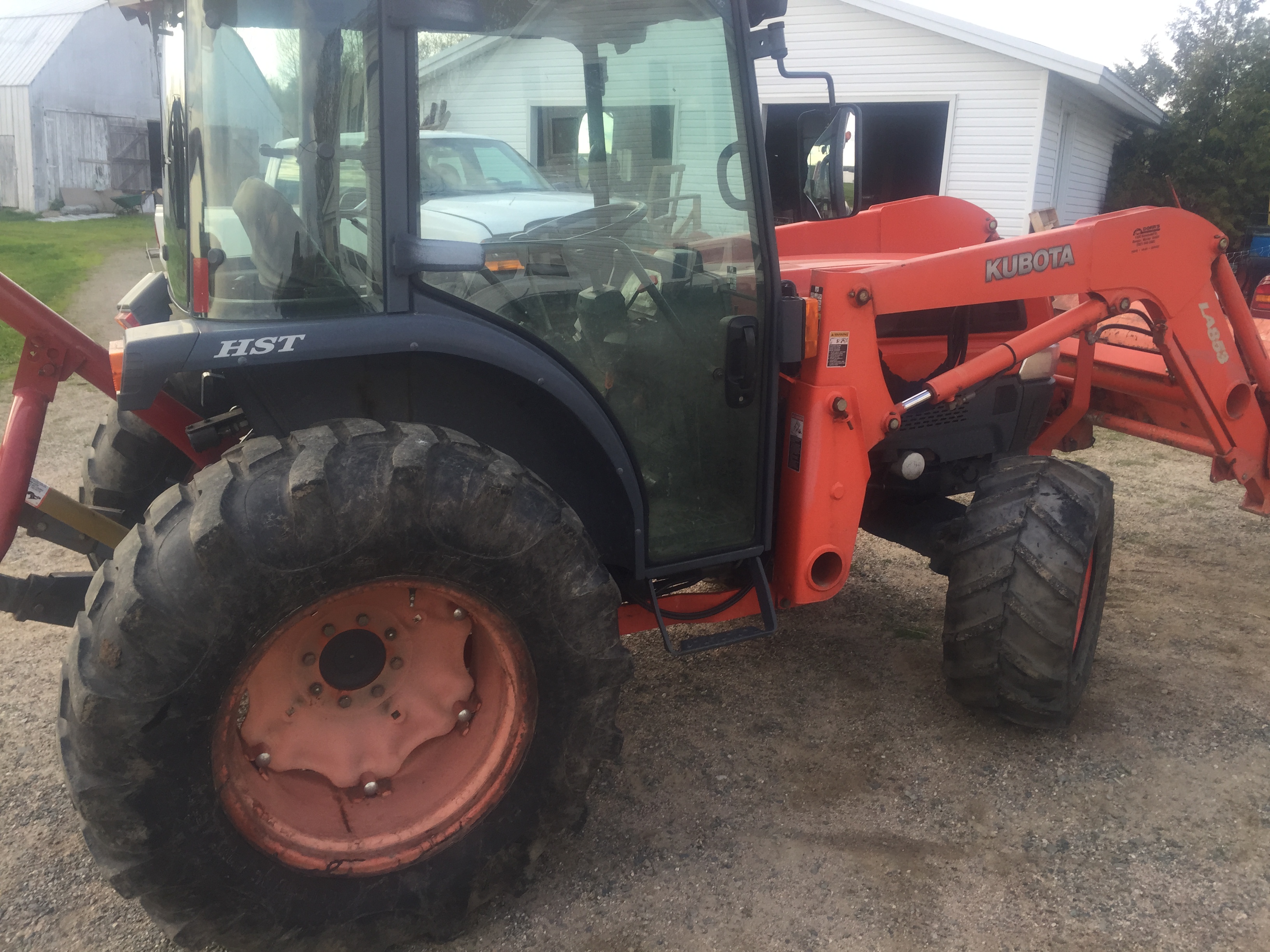

I'm very sorry to hear this, I ran them for years/ hundreds of hours without issue. Loaded rear tires, loader on the front. Still have the worn out R4's on rims out in the tire pile but swapped to 15.50 wide R1's a couple of years ago for more floatation, they are about 33" tall. These do bind/whine a bit on pavement, fine on dirt or in the field. Tractor has around 3000 hours on it now, the original rear R4's are down to only about 1/2" tread now so keeping an eye out for new rear tires soon.

I'm beginning to wonder if there is a serial number break where they fixed the lagging front axle ratio the L5030's had with R4's. My L5030 is an early model. Mine used to bind badly with the original R4's.
