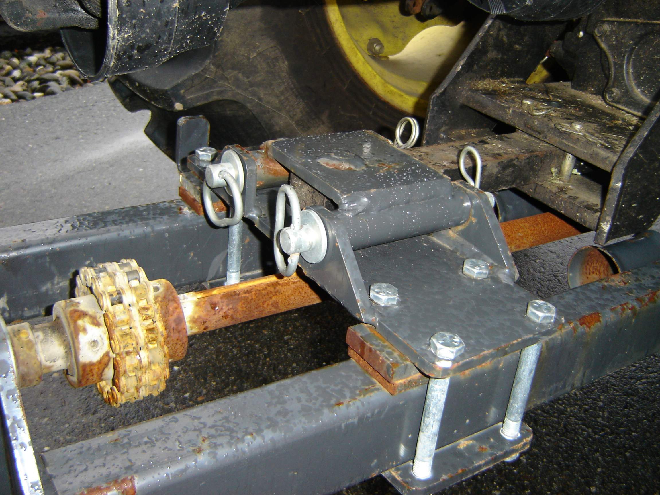

I'd like to get a swinging draw bar for my B7200 but I haven't seen one on a machine yet.
Are they all the same?:confused:
Towing with my 3pt hitch can work but when backing the hitch can lift at interesting times.:confused2:
Anybody have photos of their swinging draw bar or of a method to keep the 3pt from lifting unexpectedly?

My question: When I need to pull something stout (like a stump) I attach a chain to the stump and to the drawbar holder (the part the drawbar attaches to). That is the same or better than actually turning the drawbar around and attaching to it. Right??
You should attach to the end of the drawbar for hard pulls, not to the drawbar holder.
There is a lot of misinformation on the internet in general and on this thread in particular.
The reason for using the drawbar is that it is engineered so that if the front wheels come up and the tractor starts to overturn backwards, the back end of the drawbar lowers to the ground as the front comes up. This automatically reduces the overturning torque to zero and the tractor will not turn over. This feature allows the operator time to disengage the clutch, release the HST pedal, or let off the throttle.
Attaching the chain to the drawbar mount appears stronger, but defeats the important safety feature of lowering the tip of the drawbar.
As long as you do not jerk the load by accelerating with a slack chain, your tractor should be designed to handle pulling against an immovable object so long as you use the correct drawbar.
A few common misconceptions are:
1. "Attaching below the rear axle will prevent overturns." As logical as the claim sounds, there is nothing magical about the rear axle and this attachment is not guaranteed to prevent overturns. The thing that overturns tractors is a torque generated by the propulsive forward force caused by the traction of the tires against the ground and the rearward force from whatever is being towed. The moment arm is the attachment height above the ground. Tractors can and have overturned from towing chains attached to and below the rear axle.
The only safe hitch point is the correct drawbar.
2. The device which attaches to the lower two arms of the 3-point hitch is a tow bar, not a drawbar. Because of its ability to raise & lower a tow ball it is convenient to use to tow anything with a trailer hitch. It does not have the built-in safety of a true drawbar and should not be used for a hard pull.
P.S. I am an engineer.

Thanks, Curly, for the information. You are right....I assumed the drawbar holder would be as strong or stronger than the drawbar itself. But now I completely missed the safety feature associated with the extended drawbar. So far, when I have hooked to anything that stout (1) the tractor has not been able to pull it and (2) I have had the box blade still attached, so any back tilting would have been limited when the box blade hit the ground.

CurlyDave, thanks for answering my question with good reason included, not a "just because" answer.:thumbsup:
I went to buy the TSC swinging draw bar but it looked "awfully long".
Now that length makes sense.
It's the "anti-tip-over feature" that didn't come to mind at first.
